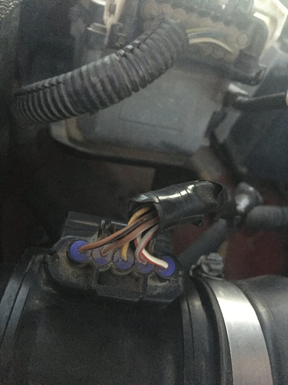

    Someone please help me with my Toyota Supra MAF thinking about going back stock because truck keeps stalling out on me. What wires do I i need to switch back.

    I bought the truck with It believe people do it too gain a few h/p. It has a s/c on it. Also thank you for welcoming me. Keeps throwing a maf code and to replace the Supra MAF cost big money so am considering going back to stock. Then having it returned I suppose.

    Exactly. I had to re-pin 2 positions when I did mine. In toyota88's pic he has two wires that need to be swapped and I have been helping him through PM's.

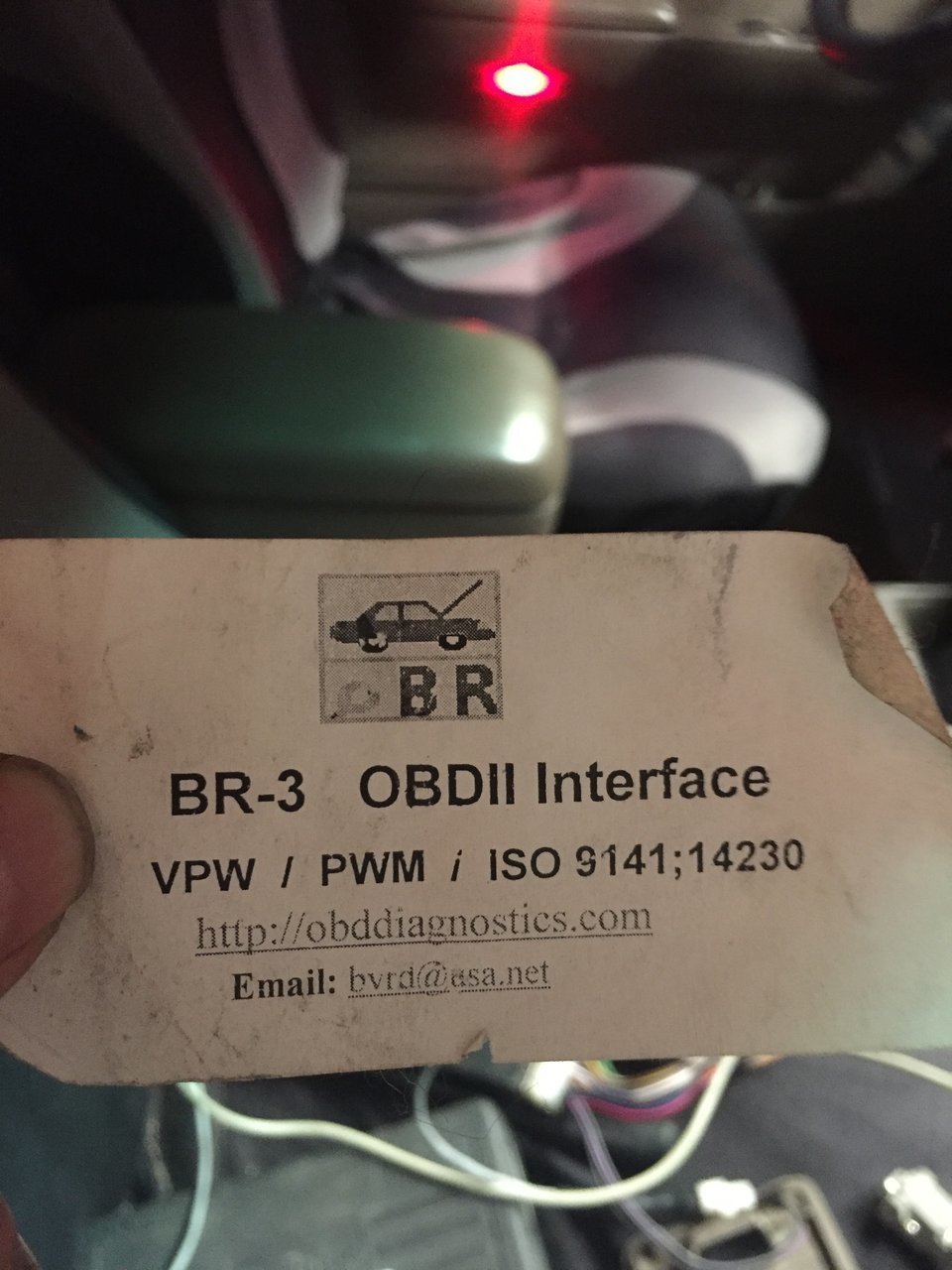

    I switched back to stock airbox and repined the two brown wires. Truck started and died right away. I can unplug maf and it idles and runs in limp mode I’m assuming. But as soon as I plug in maf it dies. Tried to hook up this obd and could not get it to connect to my computer using obd doctor free version. @elnip has been very helpful and actually helped build the truck which is nuts small world. Just need to get this guy running and in the woods again. Thanks for all the help
