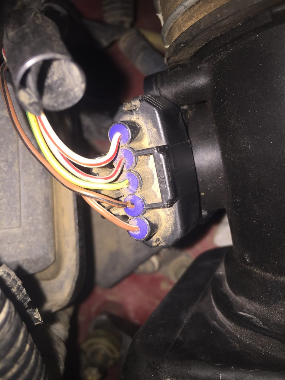

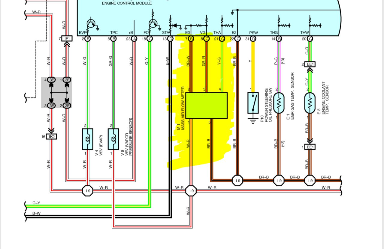

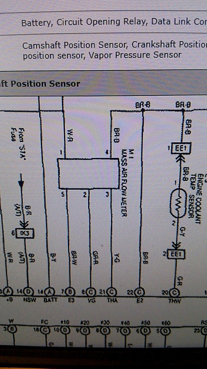

    This is how I have it wired looks like my yellow wire is in the wrong place according to yours and the other schematic is the one my buddy sent me.

    99 tacoma s/c Fox 2.5 Toyota Supra MAF
    This one

    13
    I’m just not good at reading those ☹️

    Wastegate assisted turbo delete
    Huh one of those brown wires is severed?
    I know should I place soder on it or liquid tape. I believe it still has a strong connection @Brice
    Here's what I have for a 99 5VZ
    Seems they are different pinouts...
