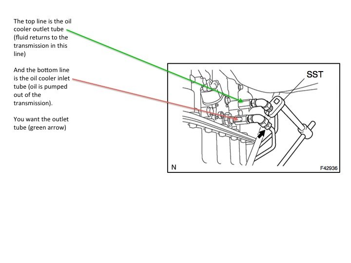

    Follow the top hose out of the tranny to the radiator or the trans cooler
    pull that hose off the radiator/trans cooler and put it into a bucket...

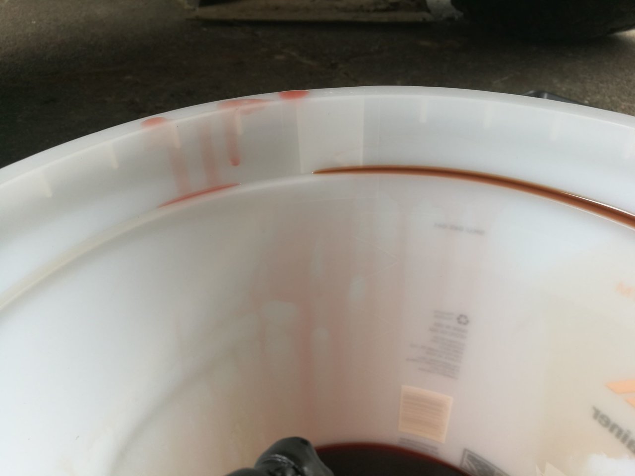

    have someone turn the truck on, and watch fluid get pumped out. i did 1 quart at a time. the premarked buckets will make your life really easy here.
    after every quart pumped, replace a quart through the dipstick.
    rinse and repeat until you get satisfactory results.. towards 12-14 qts use a new bucket so you can put the drain hose on the side and get a visual of new fluid coming out.
    this is what i did a few weeks ago. no problems. super easy. below you can see i have drips of the fluid that came out and then the fluid after flushing.
