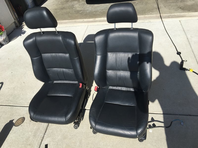

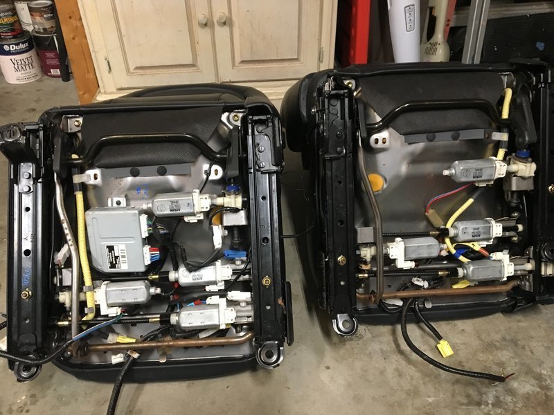

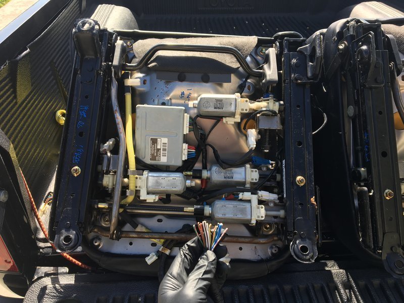

    I bought power seats out of a Lexus ES300. It is SUPER complicated electrically, there is something like 30 wires coming out of the driver's side for things like the airbag, seatbelt sensor, seat ECU (yes the seat has its own ECU), etc.
    Surprisingly getting all that to work was the easy part. Welding and modifying it to work was the hard part. I haven't put em in yet, but damn they are comfortable. I sat in 100-200 different cars at the junkyard and the Lexus seats were the most comfortable with the leather and memory foam.
    Has black leather, memory foam, two stage heat, memory positions, etc.
    There's about a million motors in each seat along with airbags and other junk.
