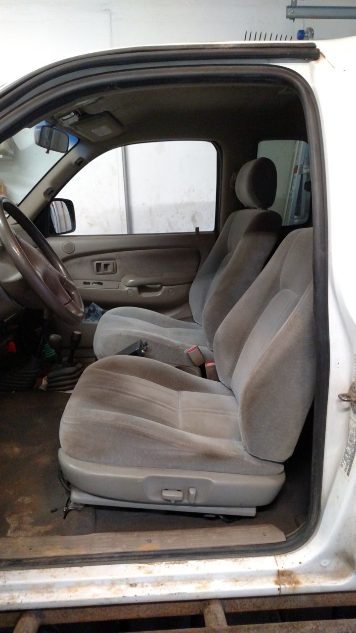

    Cut the feet off my taco seats and welded them to the Camry seats. Each seat needed 3 new feet.

    How are they height-wise?

    Pax side sits higher than stock, I didn't measure. The driver's side is adjustable from lower than stock to head touching the ceiling.

    any pics of the finished install?

    The seats really aren't that nasty, it's the lighting

    what year Camry are the seats out of? was it worth the effort? is that the trucks original console between the seats?

    1999, it was worth the effort because I had the car and it's going to the scrapper after this, so basically I paid my time. It's a modified 2wd console because I have triple shifters for my crawl box and transfer case.
    Yea it would be a pain in the ass, but realistically the only thing that goes in the back "seat" is luggage and camping gear on off-road trips, nothing that I can't toss between the two seats.
