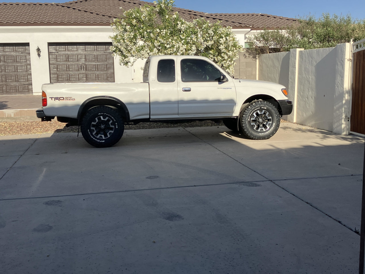

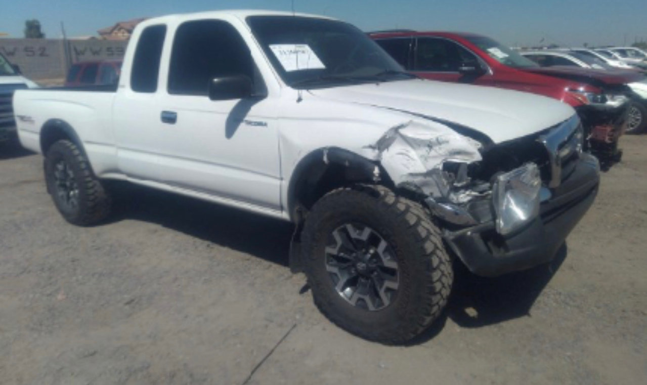

    I've attached a picture of the damage, and a picture I took when I bought it. Frame horns appeared to be in good shape, and the repair work looked solid, so I wasn't much concerned there.

    That damage does not look particularly bad, and no airbag deployment?!?! o_O
    I've seen vehicles in much worse condition than that driving around; I'm guessing it was totaled because of the age and mileage?

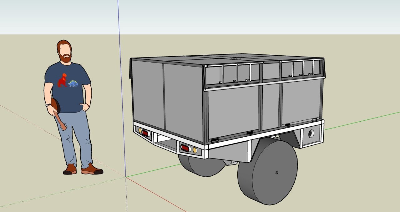

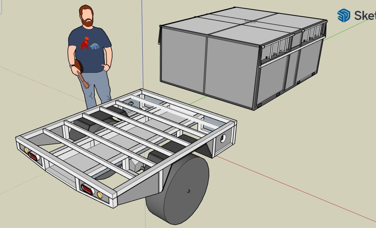

    Here are my tentative sketch-up models. Everything in the model is scaled to exact proportions. The biggest variable will be whether we run into any obstructions where the mounting brackets go once the OEM bed is removed. Calculated weight for the flatbed alone (with diamond plate bed cover) is 290lbs. I will either need to be creative with the dog box build or have it made out of aluminum in order to keep the overall weight down. each dog is between 60 and 90 pounds, so working weight will be a concern.

    There is going to be a headache rack, I just didn't draw it out because I won't know the exact dimensions for it until I get the height of the bed properly nailed down. I want the rack to be flush with the top of the cab, so we will fab that up last. The sketuchup design has space allotted for it, you just cant see it in the screen shots.

    Yeah I was a little surprised when I first went and looked at her. It really was pretty hard to find any sign of the repair.
    There's a high probability that I'll do more damage to her hunting out of it at some point, so the salvage title wasnt a worry to me so long as the frame was straight and nothing had been mickey moused under the hood.
