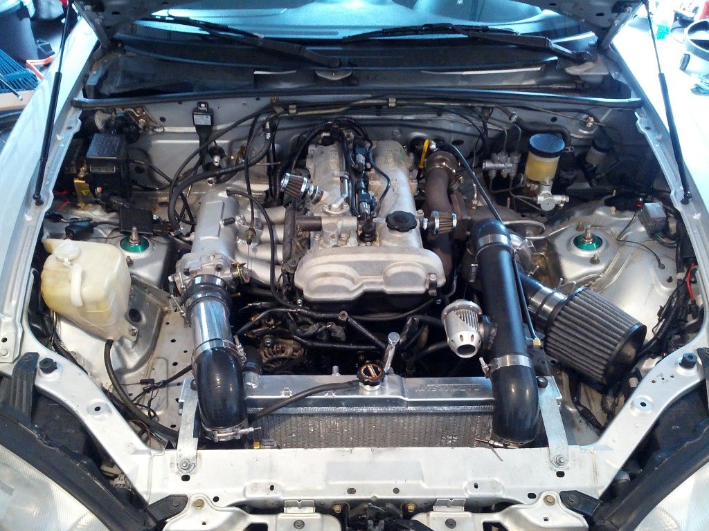

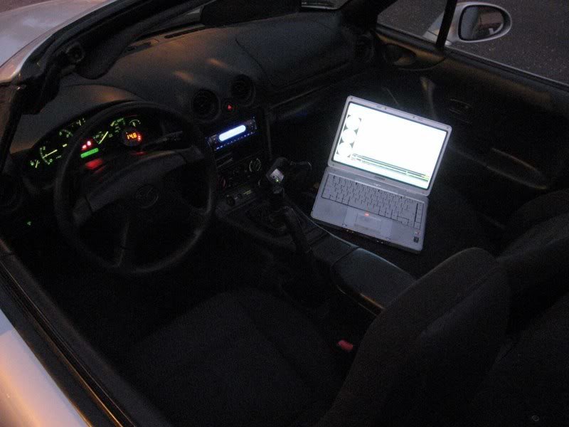

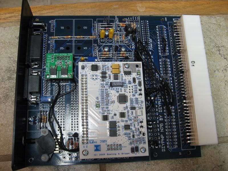

    First thing I did was get a rollbar and wheel/tires, and then later suspension (Tein Flex). At the same time I had a Megasquirt EMS assembled, installed that and began to learn the ropes of the software before I started changing everything on the engine hardware-wise.

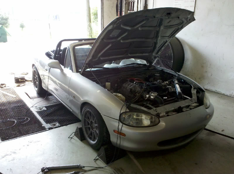

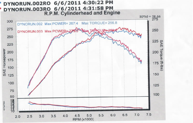

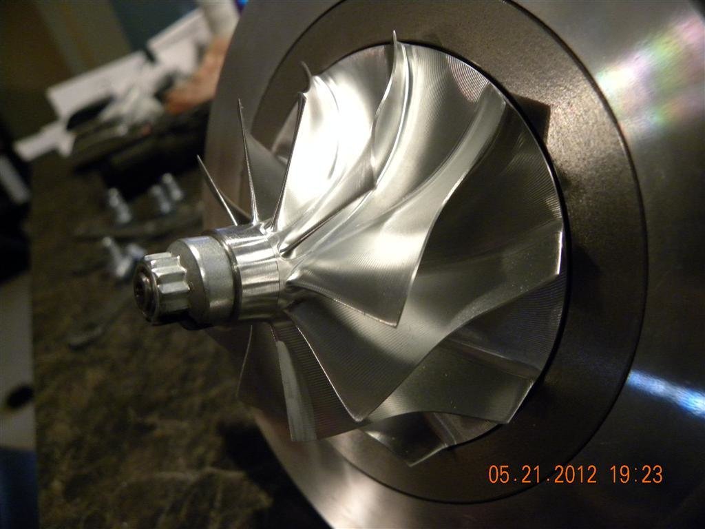

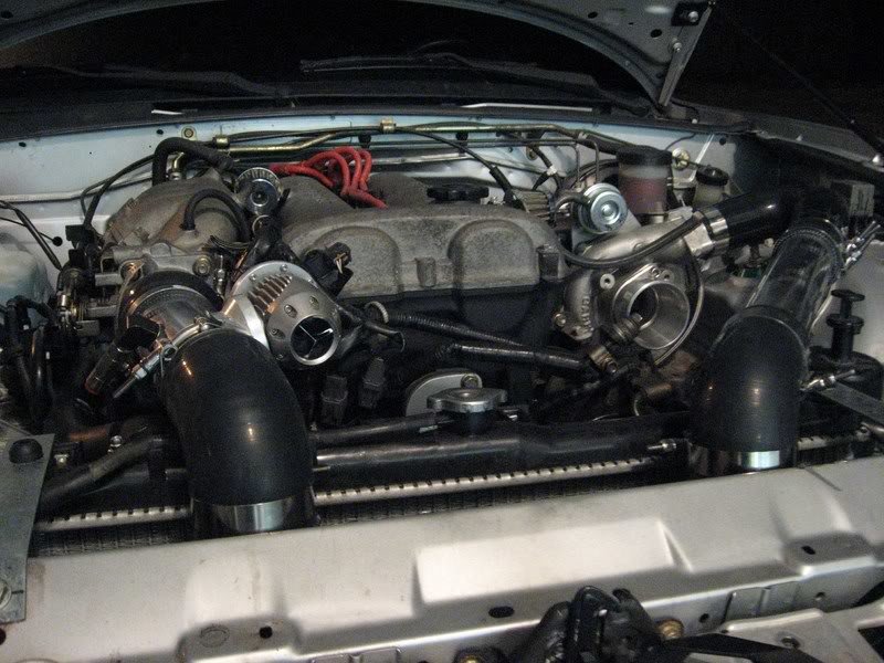

    Not too long after, got all my turbo parts assembled and installed. Had my fair share of fail along the way...but I learned as I went and got it all in working order. First setup was with a GT2560R turbo, small ebay intercooler, and a water injection kit with a small nozzle for safety. Went onto eventually make 275whp and 250wtq

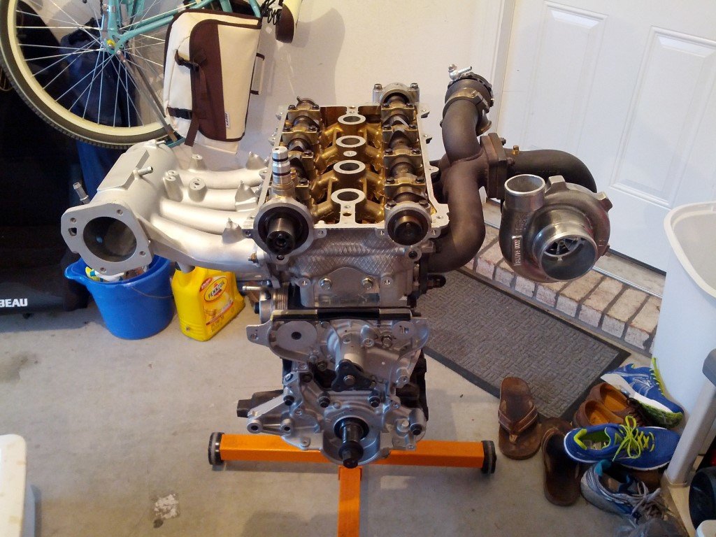

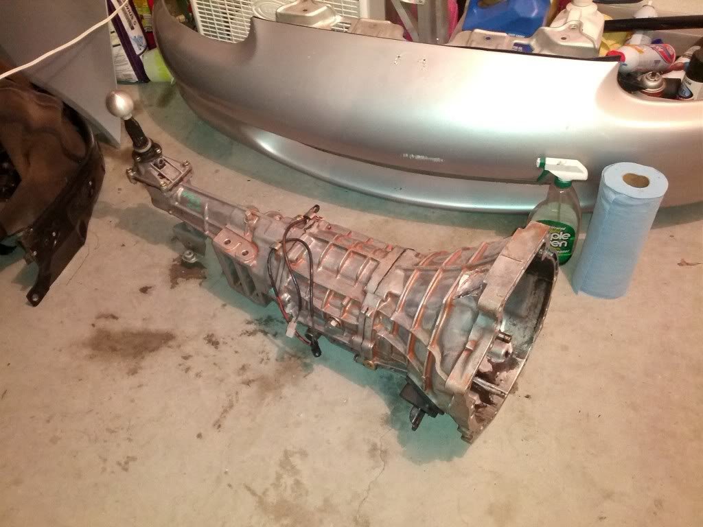

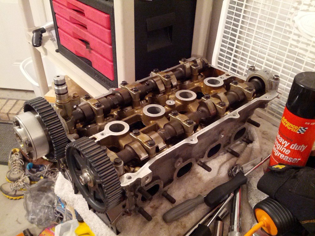

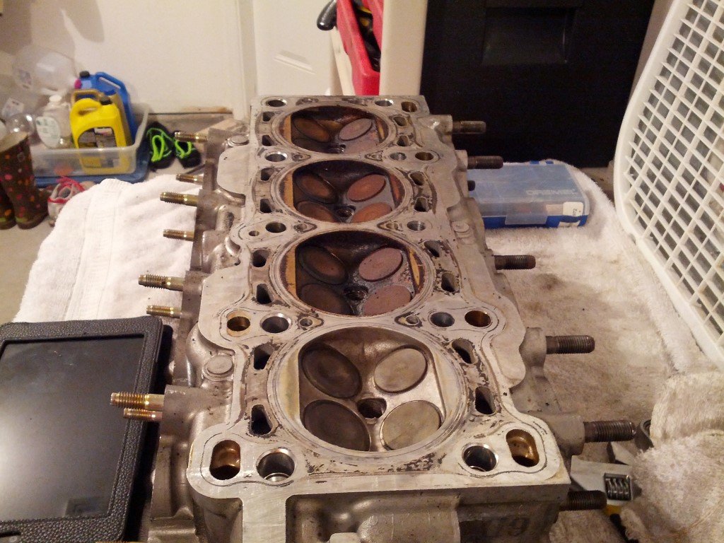

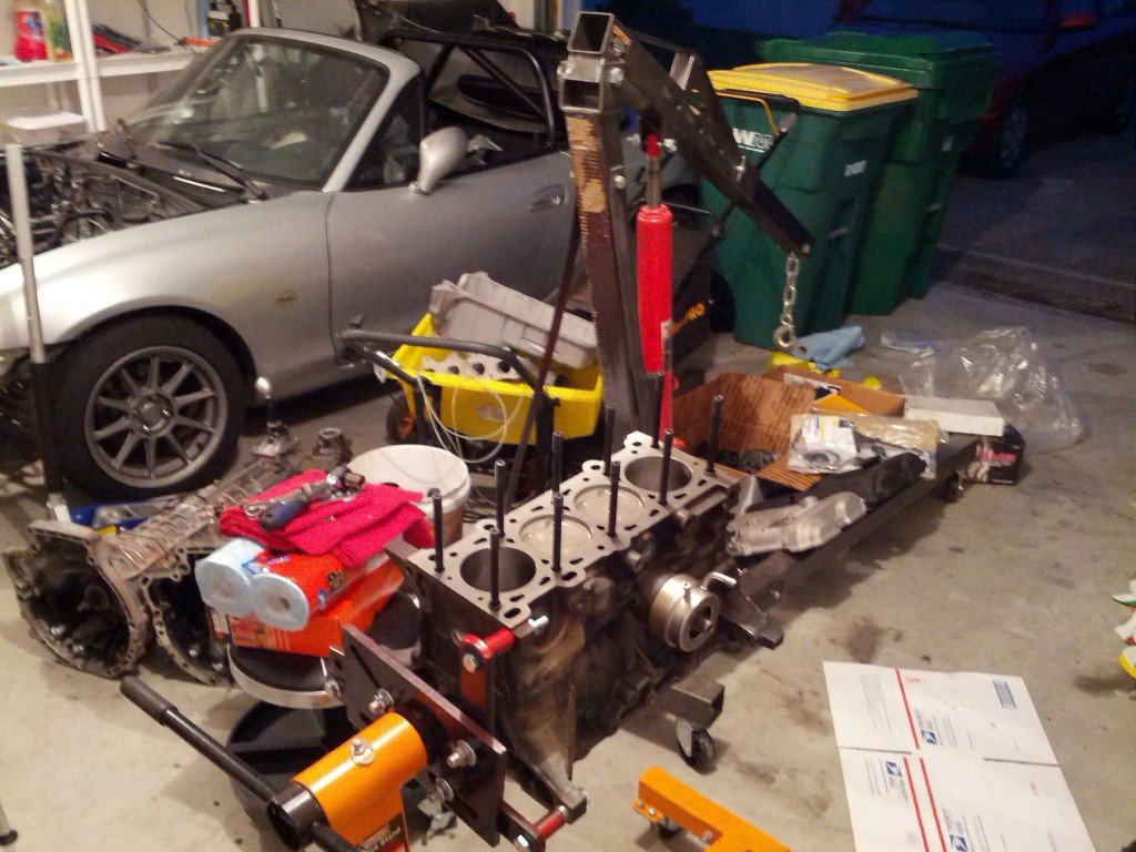

    All was well in paradise for awhile, but I knew I was running on borrowed time on the factory 5-speed trans, which eventually blew. I pulled the whole engine/trans assembly to replace the trans and decided to get the engine built while I searched for a stronger 6-speed replacement trans.

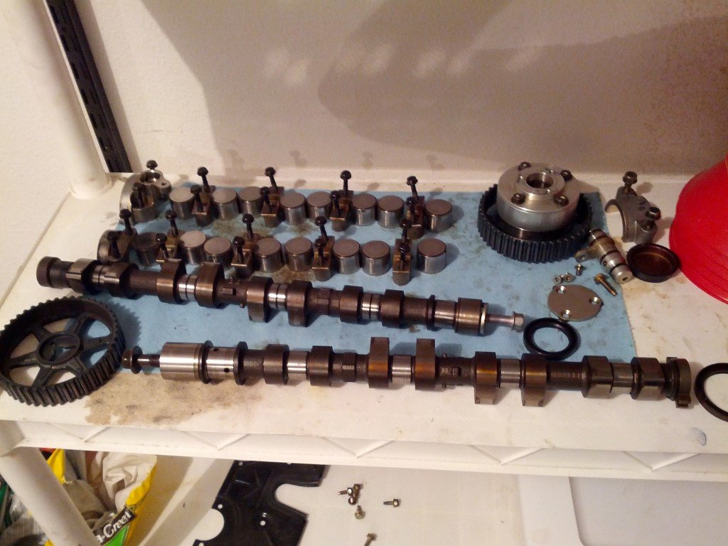

    I'm not going to go into the nitty gritty details of the engine build, now after the fact, but it was quite the shit-show. As it sits now I have a complete, running engine. It's my original bottom end, now rebuild, with another engine's stock head, while my original head (with custom cams, whole 9 yards) is getting finished up in the meantime.
    As it is now, I have 250 miles on the new engine, running a GTX2867R turbo, ID1000 injectors. The setup should be capable of holding 400whp or even more, but I will probably settle for mid 300s if I had to guess...really I will just stop turning up the boost once I get scared to drive the thing (on street tires at least).

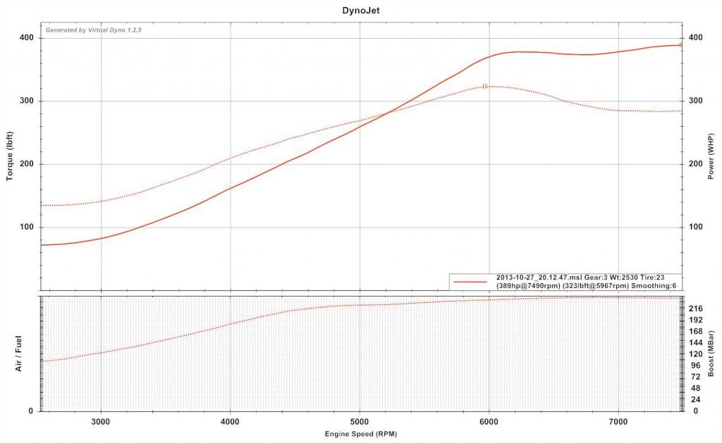

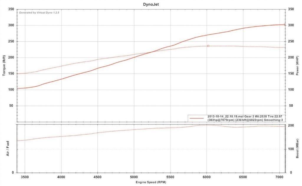

    Well, I guess I wasn't totally full of shit when I felt the car now pulled and pulled more towards redline. As far as boost control right now, I just have the 5psi spring in the wastegate, running open loop boost control (solenoid running 35% duty across the board... haven't messed with closed loop yet), hence the slow building of boost/lack of low end torque and whatnot. Looks like boost peaked at around 14psi and hangs out in the 13s in the upper RPM.

    20ish psi. had a tiny bit of tire slip at 6k rpm, hence the weird rise in torque there.
