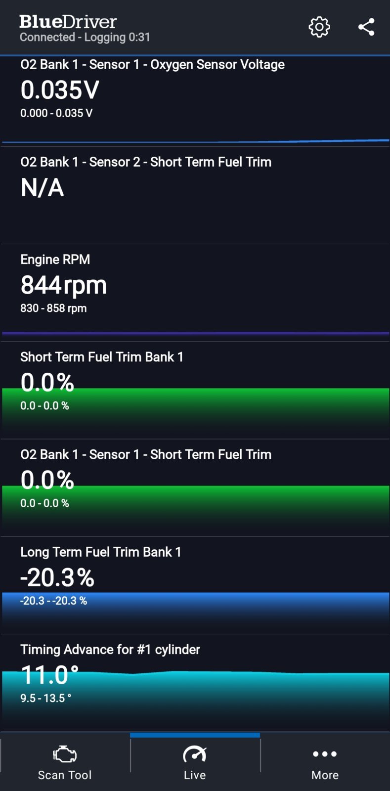

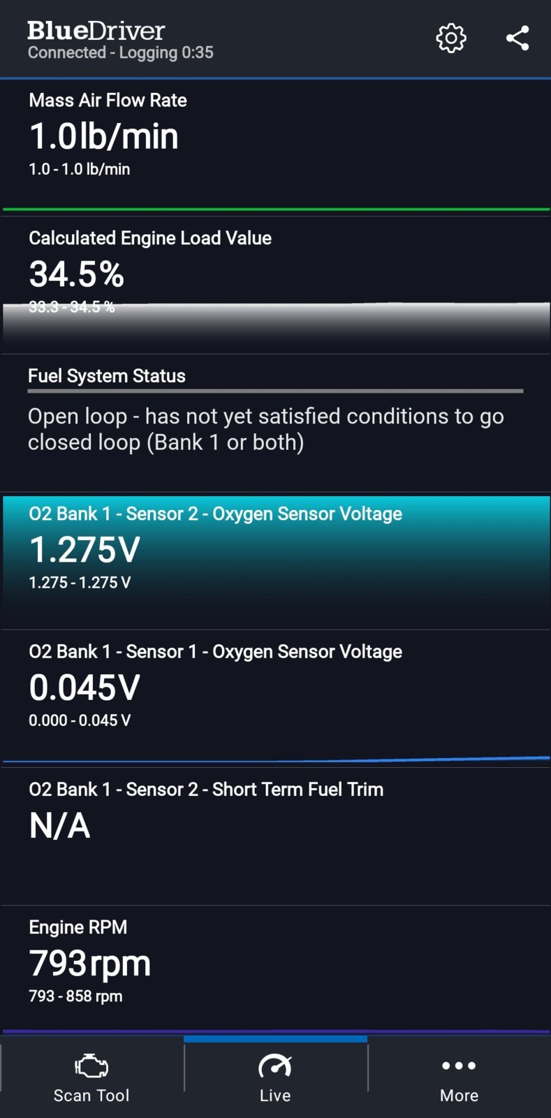

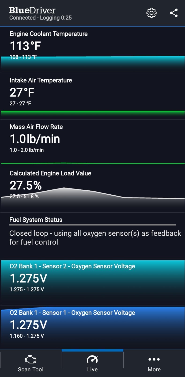

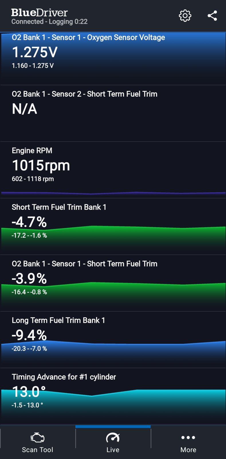

    Ok I was finally able to get out and do a little more testing;
    So I checked power at MAF connector, connector has power and good ground so I'm no longer worrying about that. I put a brand new oem denso coolant temp sensor in it about 3-4 years ago, but just for giggles I unplugged it when it was warmed up and it still runs the same with it unplugged. So I'll rule that out too since I know it would normally run fine with that unplugged (my old one was broken in half, was a pain to cold start that way but ran fine). As far as vacuum leaks, I can't imagine that would cause this as it's an intermittent (although persistant) problem, and I've had a vacuum leak on this engine before years ago and it ran bad all the time but nowhere near this bad.
    I got some more live data info too, first two pics are when engine was cold, second two are once it was warmed up a bitScreenshot_20240317_222908_BlueDriver.jpg Screenshot_20240317_222904_BlueDriver.jpg Screenshot_20240317_223242_BlueDriver.jpg Screenshot_20240317_223245_BlueDriver.jpg

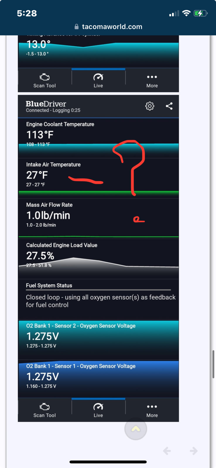

    Hmmmm
    I’m not ‘big’ on realtime data(bc I’m more mechanical….(a fault of mine))
    But
    I may have found something

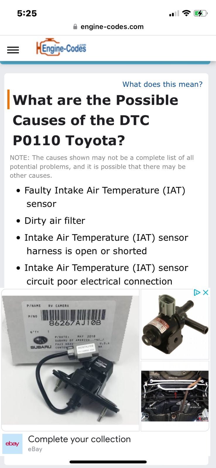

    Brrrr Rabbits
    Unk if you are in Alaska but 27 degrees is cold
    guessing here
    But possible that IAT(bad) is over ruling the CTS(good)???
    I dunno
    Just a thought
    Electrical Gurus members might be able to explain

    I forgot to mention that now with new IAC, the MAF codes are gone. Now the codes are for CTS circuit, throttle position sensor circuit, and insufficient coolant temp, the first one likely from having it unplugged. Also tested TPS with multimeter and tests fine, and CTS is brand new oem.
    As far as the 27 degrees, that was acurate it was cold out that day, I live in northern Michigan. Also the IAT sensor is part of the MAF sensor, which is brand new oem.
