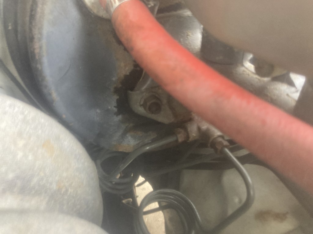

    My truck started engaging all four brakes while driving down the road and smoked the two front rotors yesterday before I could stop. Smoke was pouring out of the wheels. I had to break the fitting loose at the master cylinder and you could hear them all 4 release after bleeding off the fluid . What could be causing this ?

    Bad rubber lines can allow fluid to push one way but not so much the other. Weird it would be all 4 though.

    Sounds like your brake master cylinder / booster is suspect.

    If this is your only vehicle that puts you in a tough situation... if it were me, I would get a new brake master cylinder and take my old one off and disassemble it for an inspection. Look at the end of the master cylinder where the circlip is to see if it is wet with brake fluid, if so, the rubber in the brake booster is probably shot. If you have a non ABS truck you can pry the master away from the booster enough without cracking the brake lines.

    There have been a small number of trucks I’ve seen on here with a vacuum leak in the booster. Pinch off the hose and see if your idle issues go away (if they’re still present).

    one time i installed the booster's V hose on backwards(that check valve)
    this caused the opposite thou......no brakes...hard as a rock....barely could stop backing out of inclined driveway
    i have never heard of this b4....
    but
    what if the internal MC's push rod gets stuck in full position? (from wear)
    would kinda explain the full 4 corner lock up

    So I pinched off the booster and the brakes were very responsive and after it warned up it idled at 1100 ish down from 1700 rpm’s . On initial startup it idles up real high and on the down idle it drops to 5-600 ish and then dies if you don’t give it fuel and once it warms up its 11-1200 rpm . Now the brakes work better with the booster pinched off from the vacuum what’s that about?

    I just noticed this after the power wash yesterday the mc is now leaking at the booster gasket .
