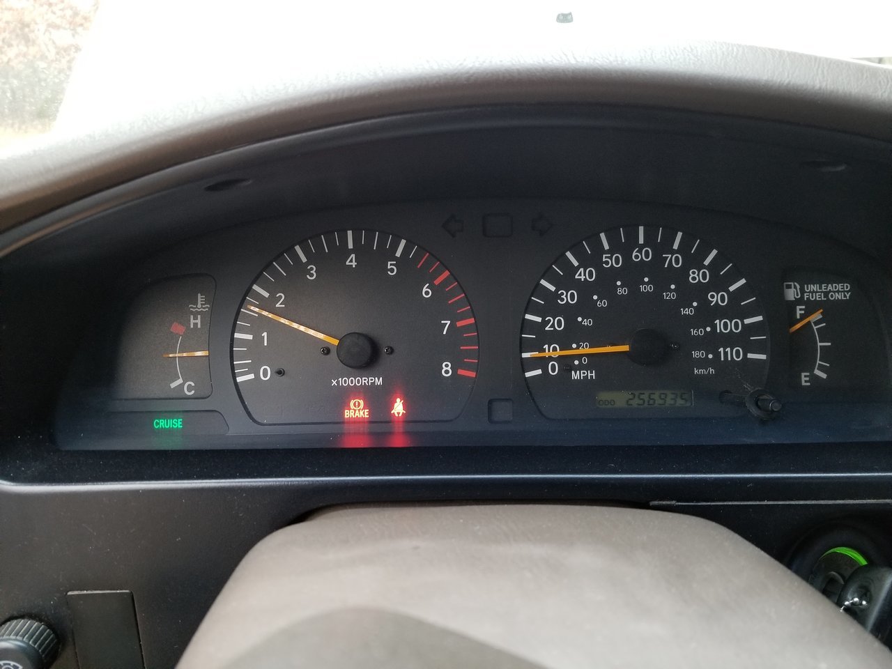

    All right tacoma world. Shes fired up and running fine. No CEL ... cruise works... no weird noises woooohoooo

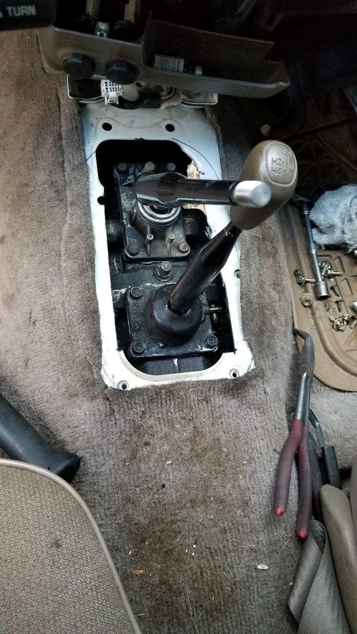

    Tranny tunnel

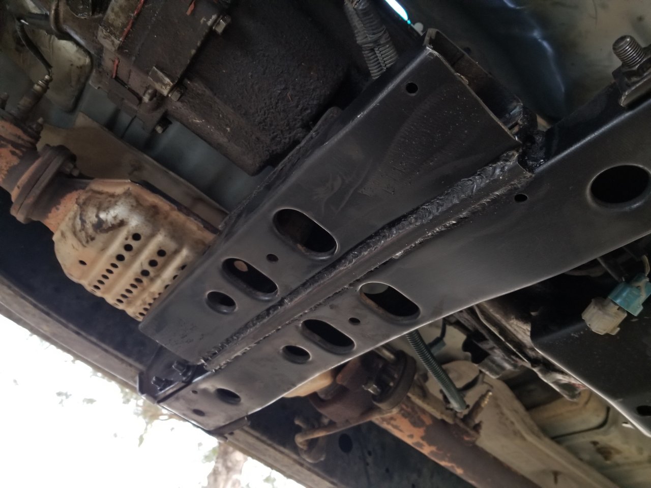

    My double crossmember. Lol

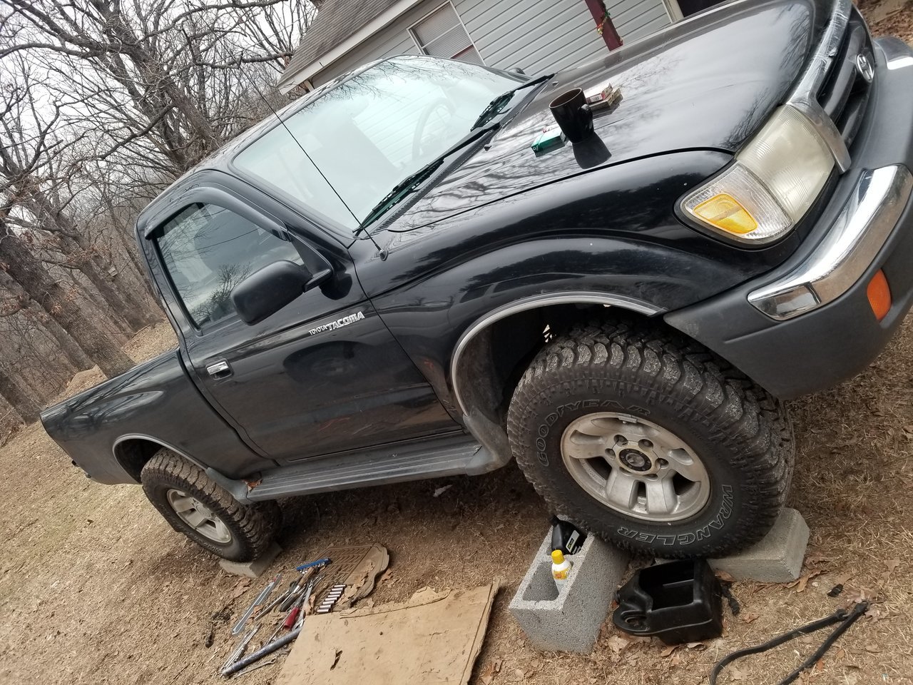

    My best friend... the donor truck. Lol

    Shit man congrats. So you're using the manuals ECU and no repinning was required?
    That double crossmember is genius. The way I've seen it done is people cut out the center of the auto one and move it back and re-weld it with plates on each side

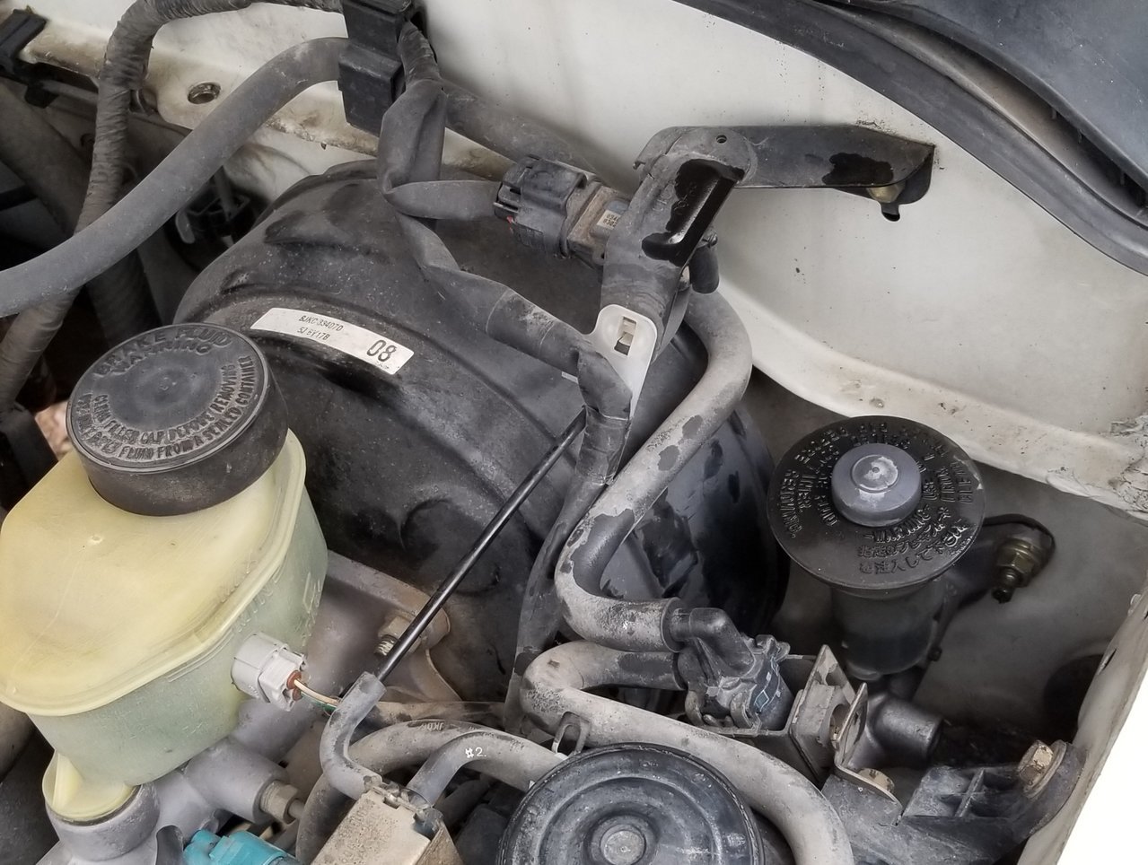

    Just factory. 3 holes, measured 100 times. Lol. Just ran the hard line down like it was on the other truck. Took the factory bracket off the donor truck and welded it to the same little ridge it was on. Then the soft line, and slave cylinder to transmission. I let it gravity bleed for about 4 hours. I had enough pedal to work the gears but I'm bleeding it properly tomorrow after the wife wakes up. She doesn't know it yet. :)
