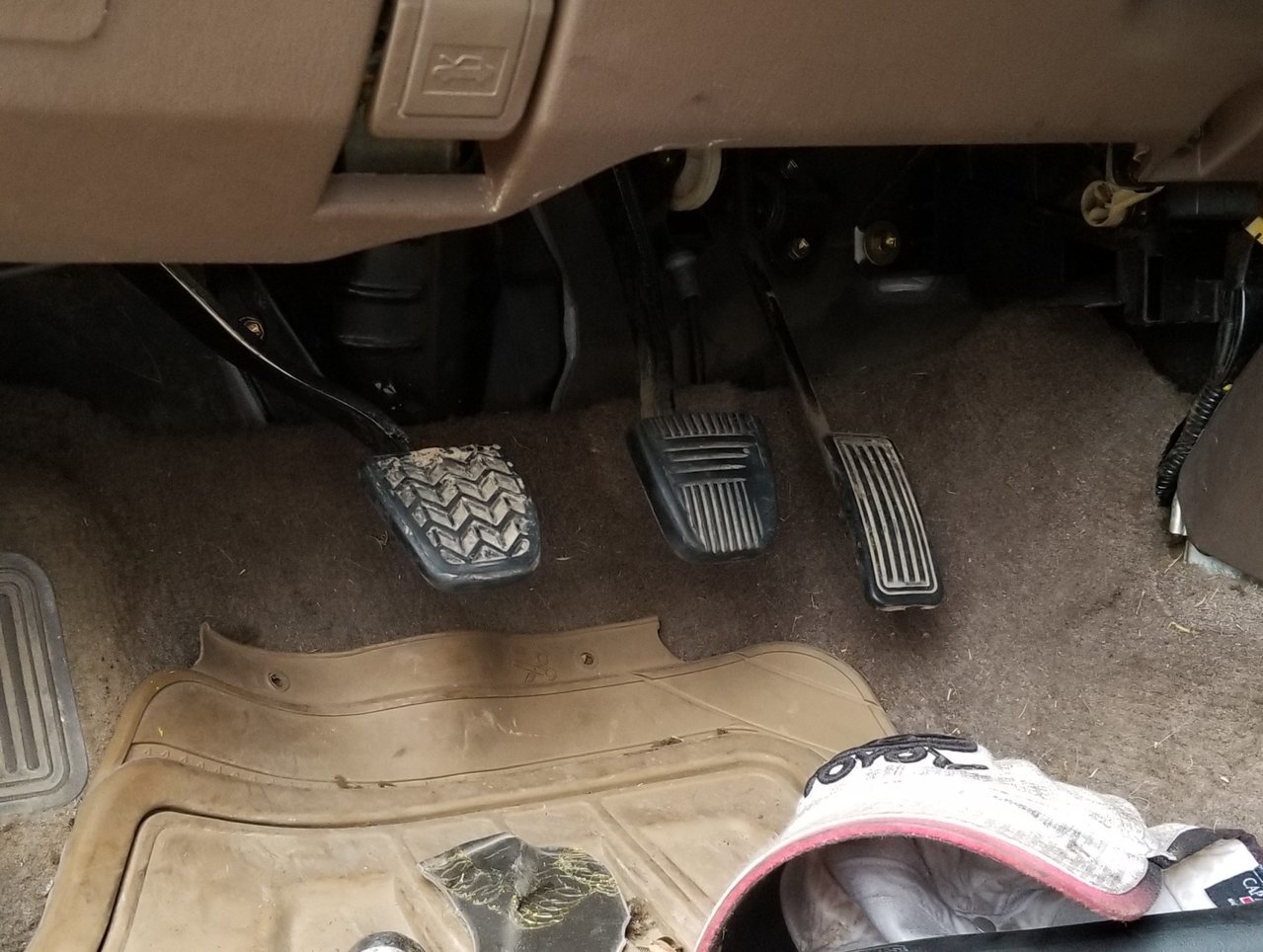

    Starting new...
    Here's the pedals...

    I'll take pics tomorrow how the clutch lines are run. But if you get under a factory manual truck, it'll be just the same. Lol

    Also how did you get a welder in that spot to tack the clutch hose bracket in. I couldn't get at it so I used a right angle drill to make three holes then riveted it with steel rivets.

    I have Lincoln might welder... the gun fit up in there...I just welded all the way across the bottom of the bracket. Make sure you pull your carpet and lay a wet rag on the sound deadening tar or it'll melt and smoke. Lol

    Haha very true about that sound deadening junk. I was gonna use a stick welder cause my MIG gun doesn't fit. But the rivets haven't loosened a bit so I may just leave it since the bracket isn't under much pressure.

    Yeah. Just keep an eye on it. If u put 3 in it it should be fine.

    Oh yeah, speedytech7, I welded the bracket in before I installed tranny. That's why I had so much room to work.
