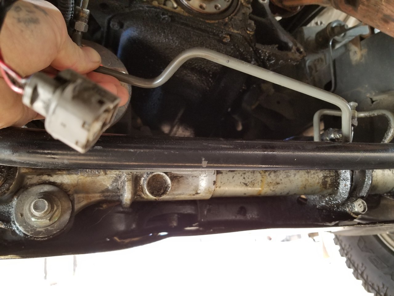

    This is the hard line on the steering rack that I recommend removing before dropping transmission.

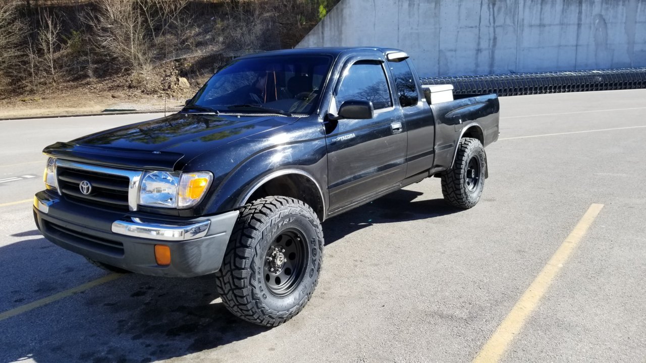

    Posting my finished pic guys. I'd still like to give it a new black paint job. I'm very happy and thanks everyone for all your help.
