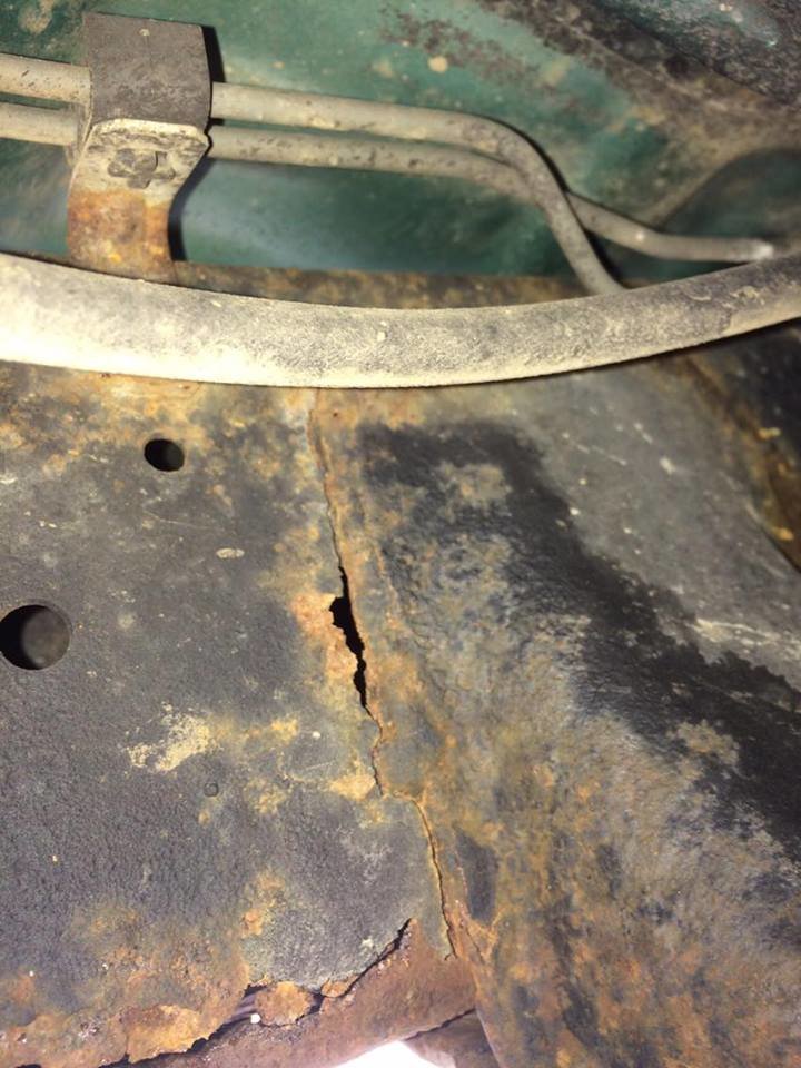

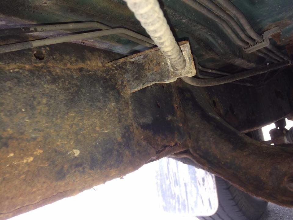

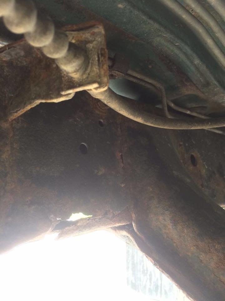

    I naively bought a 99 tacoma off craiglist only to learn that the frame is rusted out entirely. I don't think it's safe to drive, and i've been told that the window to have toyota buy it back or replace the frame closed in 2011. Do I have any recourse? Any advise?

    Wow. I wouldn't drive that if I were you, that is some bad rust.

    If I were you I'd check you local state laws, maybe talk with a lawyer. You may have some way to go after the previous owner but that may be an "empty well". You defiantly need to get that dealt with before you drive it any further. If it is that bad in that spot the rear spring hangers are probably in bad shape too. Don't let a shop put it on a lift, it could snap the truck in half...

    From the pictures I don`t think it is that bad but then I have been fixing these Frames since they started to rust
