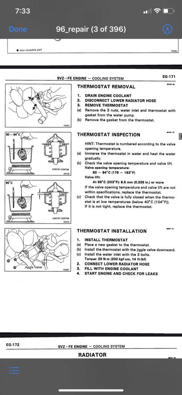

    Did you put the jiggle valve on the thermostat in the downward position, or the 6oclock position?
    Using Toyota red coolant?

    @96BlueTacos I don't remember jiggle valve position, I've seen different people saying different things on the position, I think I went with whatever my Haynes manual said. I use the yellow/green Prestone coolant. Haven't checked for air in the system yet, guess that should have been first. But I've drained it a couple times, when replacing the thermostat, and again for the radiator, plus some for the fan clutch, wouldn't have figured it'd get air each time, I'll check though. I just noticed yesterday doing the fan clutch, that I'm missing the lower fan shroud as well, was wondering if that could cause it.

    Ya I wouldn’t recommend anything other than the factory coolant. They designed it for the engines. I.e. for the metals it contacts, the viscosity, weight, and all of that chemical engineering is done for a reason. Corrosion can wreak havoc on the coolant passageways and I’d prefer just avoid it by using what they intended to use.
    the jiggle valve goes down
    See thermostat installation (b)
