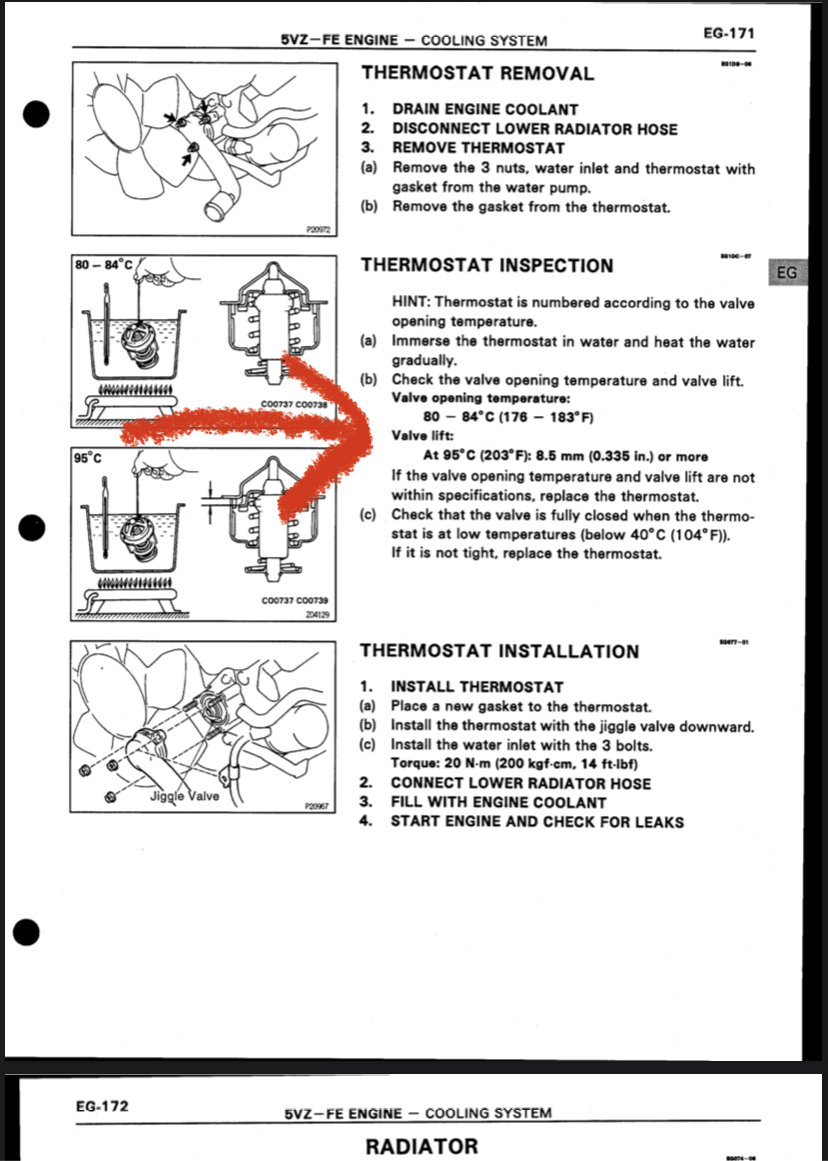

    Here’s fsm page

    I haven't seen any open much if any before 180°. But I suppose it would be okay if it did
