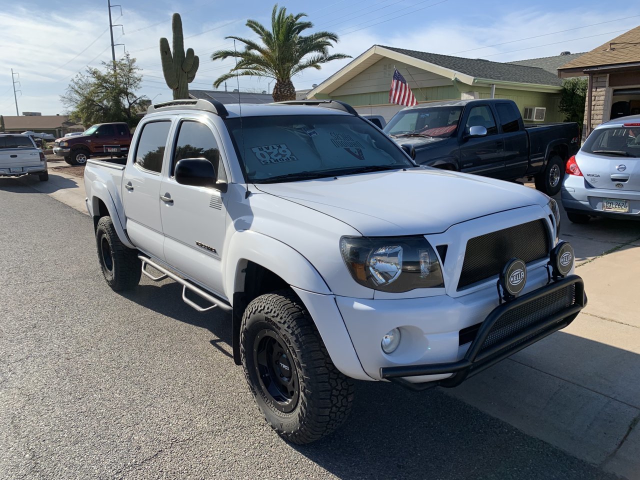

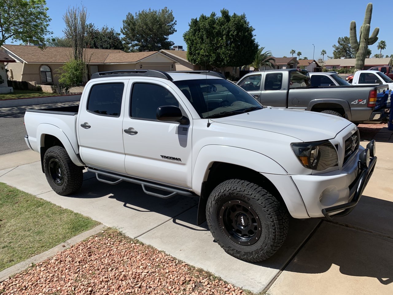

    -2009 Toyota Tacoma TRD Off-Road double cab short bed
    -Bought with 67,000 miles
    -Currently 105,000
    Interior
    -Center consol organizer
    -Tufskinz white and black foam cup holder inserts
    -Upgraded sound system from local shop in AZ, with a custom sub box I got from Super Crew Sound, and a new head unit.
    -China climate control knobs
    Exterior
    -Avid Off-road custom front bumper guard with extra cross bar and mesh
    -Avid Off-road bolt on sliders with kickout
    -Factory roof rack
    -Black headlights from eBay
    -Color matched grill from eBay
    -Hella 500 black edition lights on front guard
    -Mobtown Off-road steel front skid plate
    -Fumoto oil drain valve
    -Relentless Fab bed bars
    -Smittybilt Overlander RTT
    Suspension/wheels/tires
    -Bilstein 5100 shocks up front on 0
    -OME 884 coils
    -1/4 top plate spacer on driver side
    -Bilstein 5100 shocks in rear
    -Deaver AAL
    -TRD beadlock wheels with black hex socket set screws in the holes
    -Falken Wildpeak AT3W 265/75/16
    Miscellaneous
    -Blue TRD oil cap
    -Black TRD emblem on tailgate (debadged all else)
    -Black TACOMA emblems on front doors from dealership
    -American flag decals under mirrors/Fox sticker on rear window
    -AJT Designs key FOB (white with black screws)

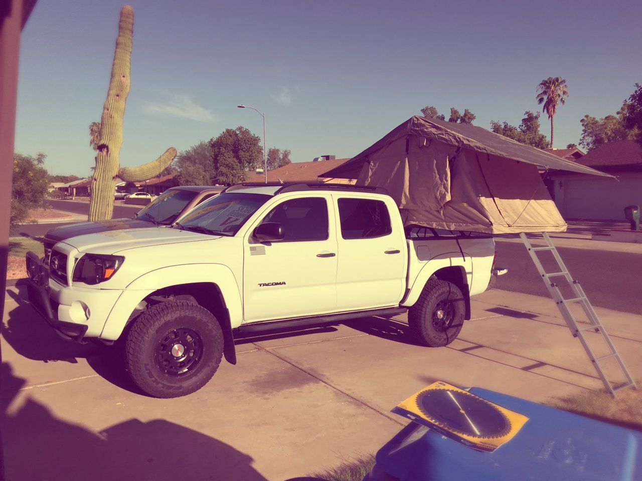

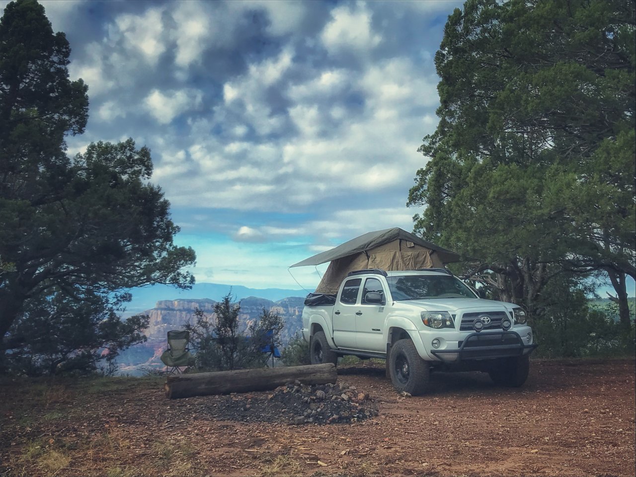

    Pictures!!!
    ^At lake pleasant a few weeks after I got the truck. Green bike is my 99kx250, blue is dads 99yz250
    A8DD33D0-24B8-4C76-8890-8FD20B49FC14.jpg 7C861ABB-3479-471B-8521-9964C4006DA3.jpg

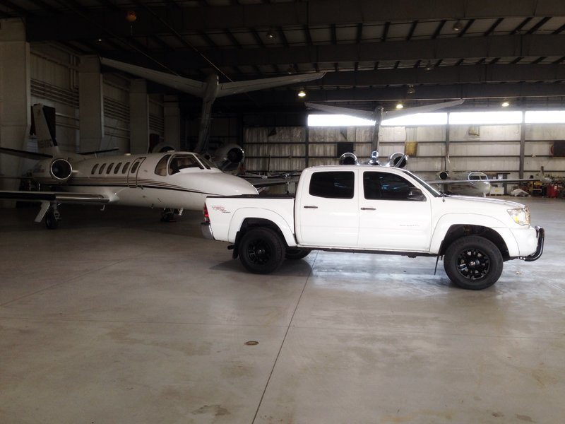

    ^These are at my last job as line service at swift aviation. I cleaned my truck inside the hanger every Saturday and the second pic is the day after I got the bilsteins put on
    3DDBDF66-82E0-41DB-88CC-8919C0264BCA.jpg EB42BD69-1075-4CDE-9629-22C39CCFF70B.jpg C9C8C6D8-D507-4469-BB49-F39367684A21.jpg
    ^Monunent Valley. Two day trip, got tons of awesome pictures and truck worked great.

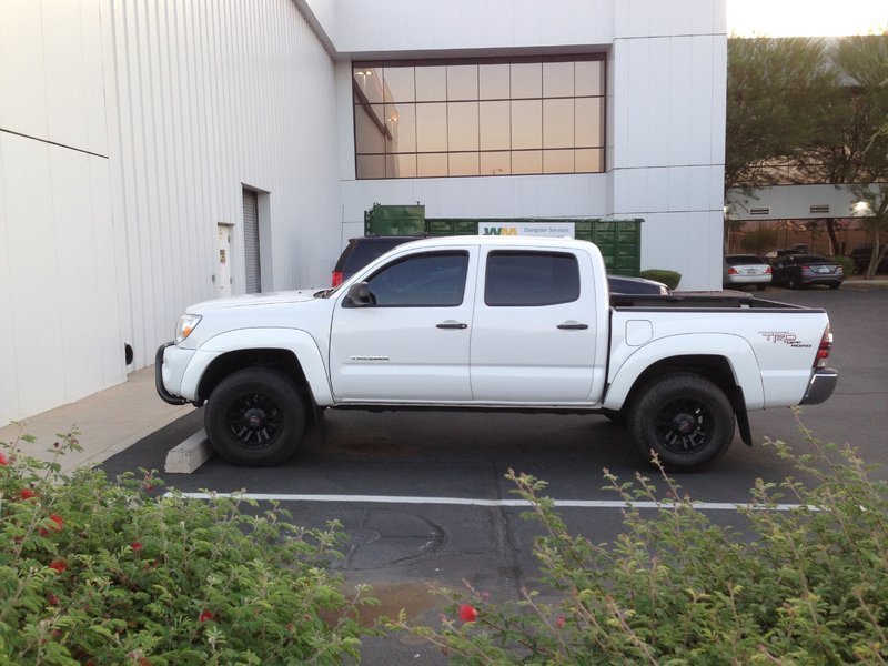

    ^After upgrading tires from stock 265/70 to 265/75. No rub

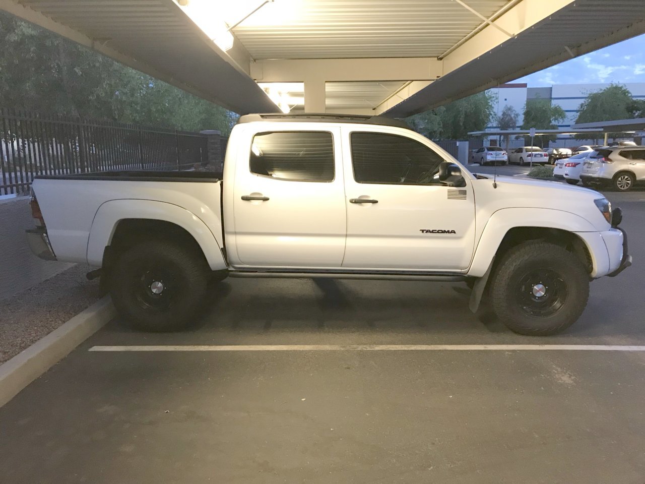

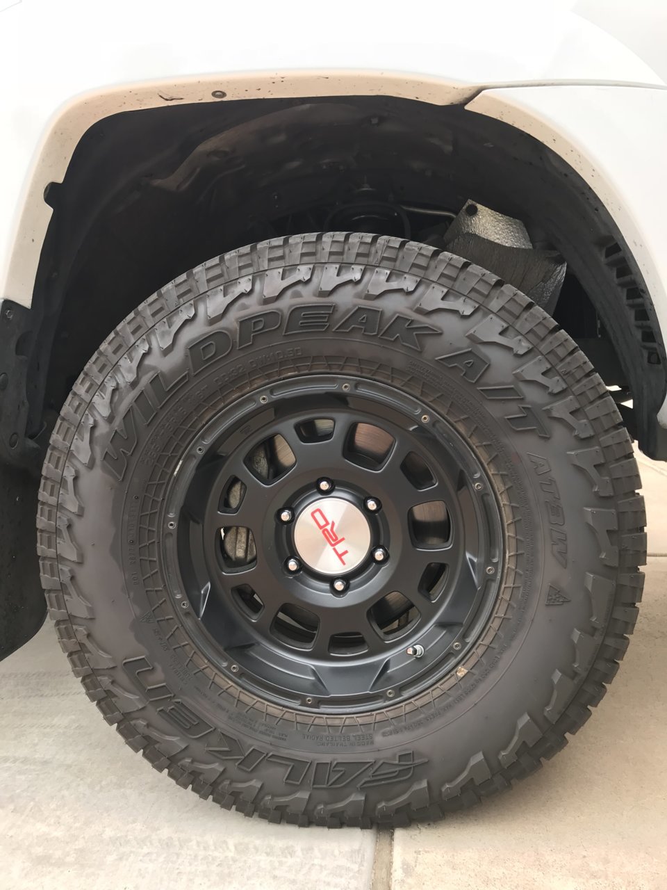

    ^TRD beadlock wheels, ring off, with 5/16 black hex socket set screws in the screw holes so the chrome isn’t sticking out. Falken Wildpeak AT3W 265/75/16 tires
    ^Tufskinz foam inserts
    65C0CD33-472C-4665-919F-77D3AFC8F1BE.jpg 870C38A7-3593-4B23-A880-866A160A2EAD.jpg

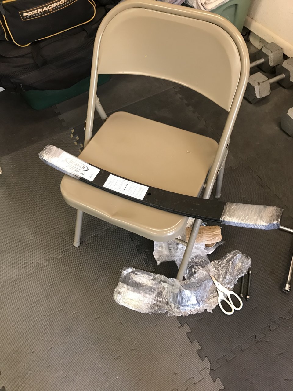

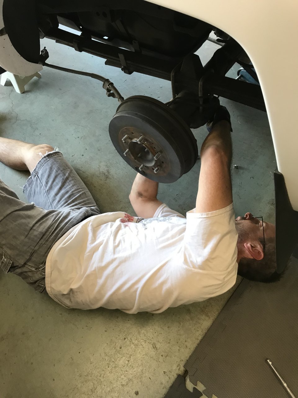

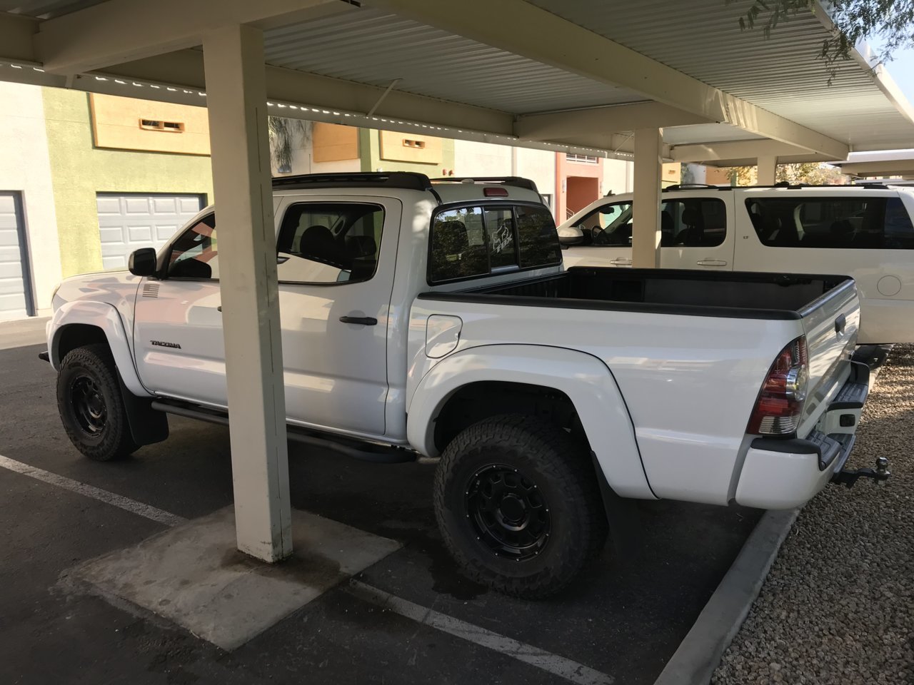

    ^Single Deaver AAL install. Took about 3 hours
    5F1DDF58-7FDB-47EB-941F-A6E872D30148.jpg 232DFFFD-38A2-460A-BFBD-D41D51D3777E.jpg 75E869E7-0366-4E36-89C7-23BEA95EABE5.jpg

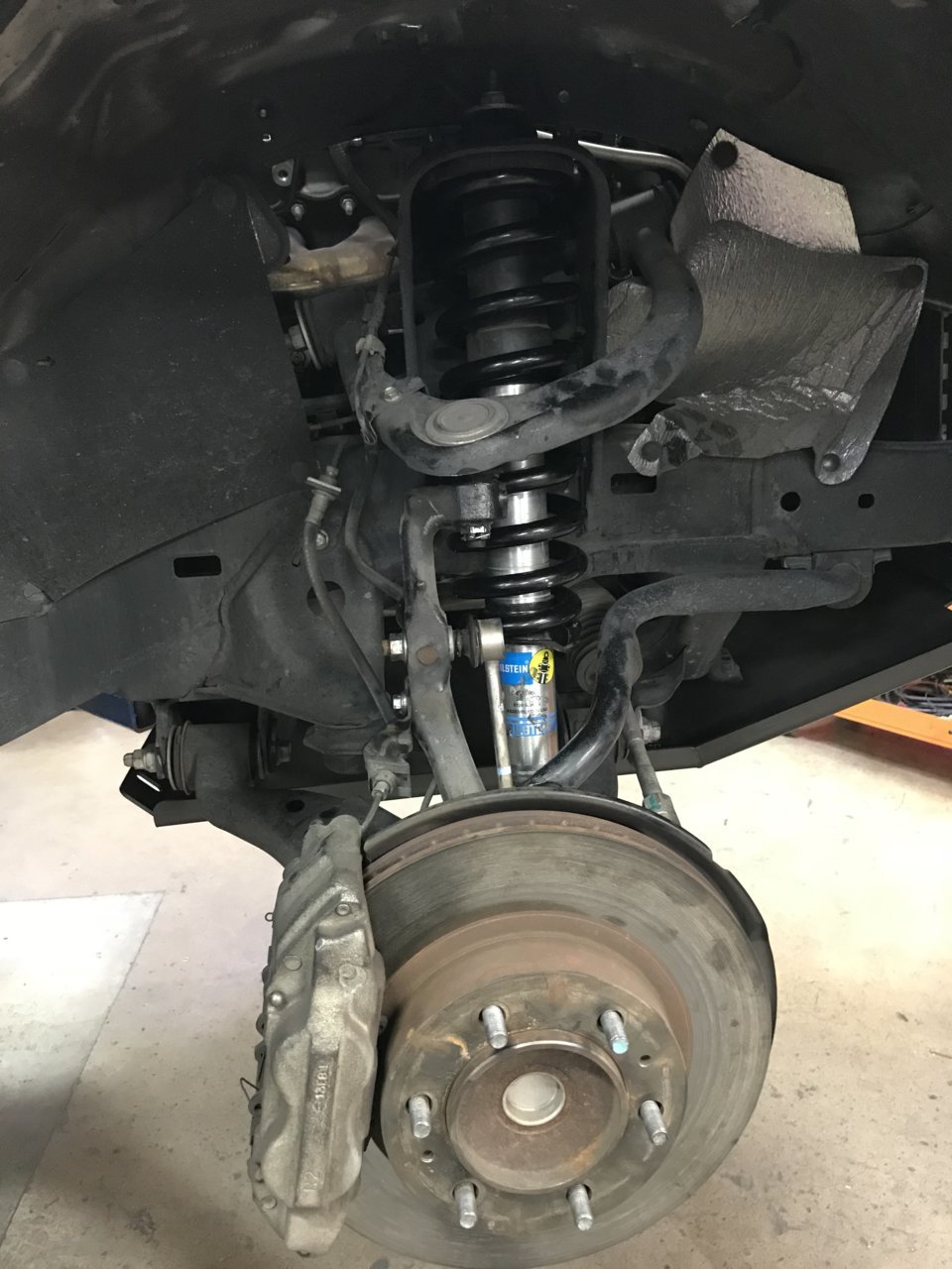

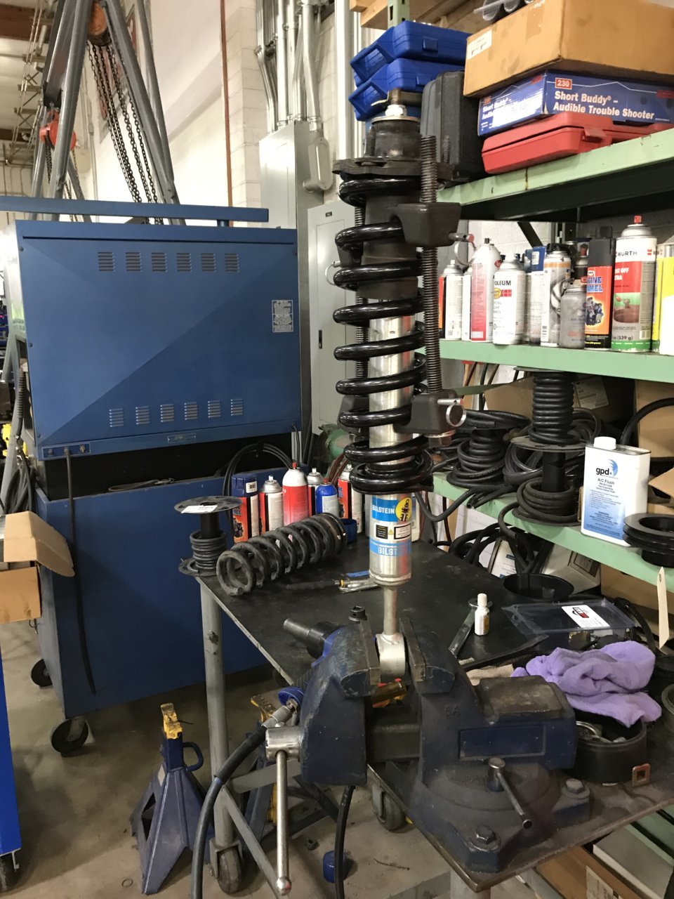

    ^Getting my front suspension done. OME 884 coils on Bilstein 5100 shocks. 1/4 top plate spacer on drivers side for taco lean.
    C4E23491-33A1-477F-AA7A-E12D7BA91C54.jpg 3D69D21D-E534-4091-BEDB-F1C1C5153477.jpg CAF58036-985D-4036-B115-FFFB41A7EE4F.jpg

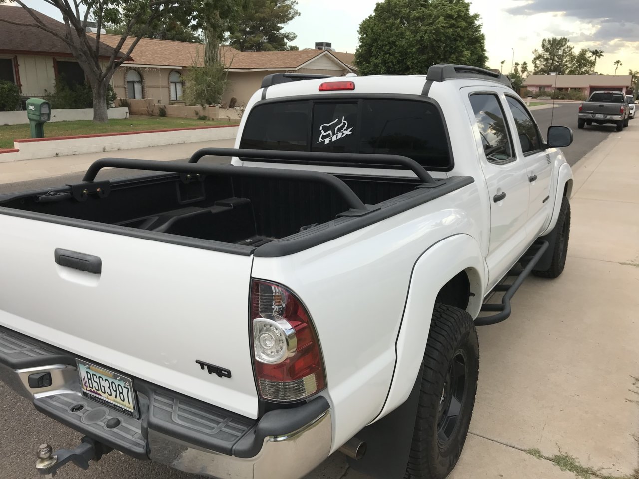

    ^Relentless Fab low profile bed bars powder coated wrinkle black
    BE7C9FA6-D1AA-4F67-A7F6-698318C4A9E7.jpg 16682D35-D475-486B-9379-35E53B76E283.jpg FD49AE35-44BC-46A9-AAE2-5D4B4617D3EE.jpg D40D7AC3-9C00-400E-8720-F21B0BF31555.jpg B9218B81-C233-4322-A2A6-00570E1873C7.jpg

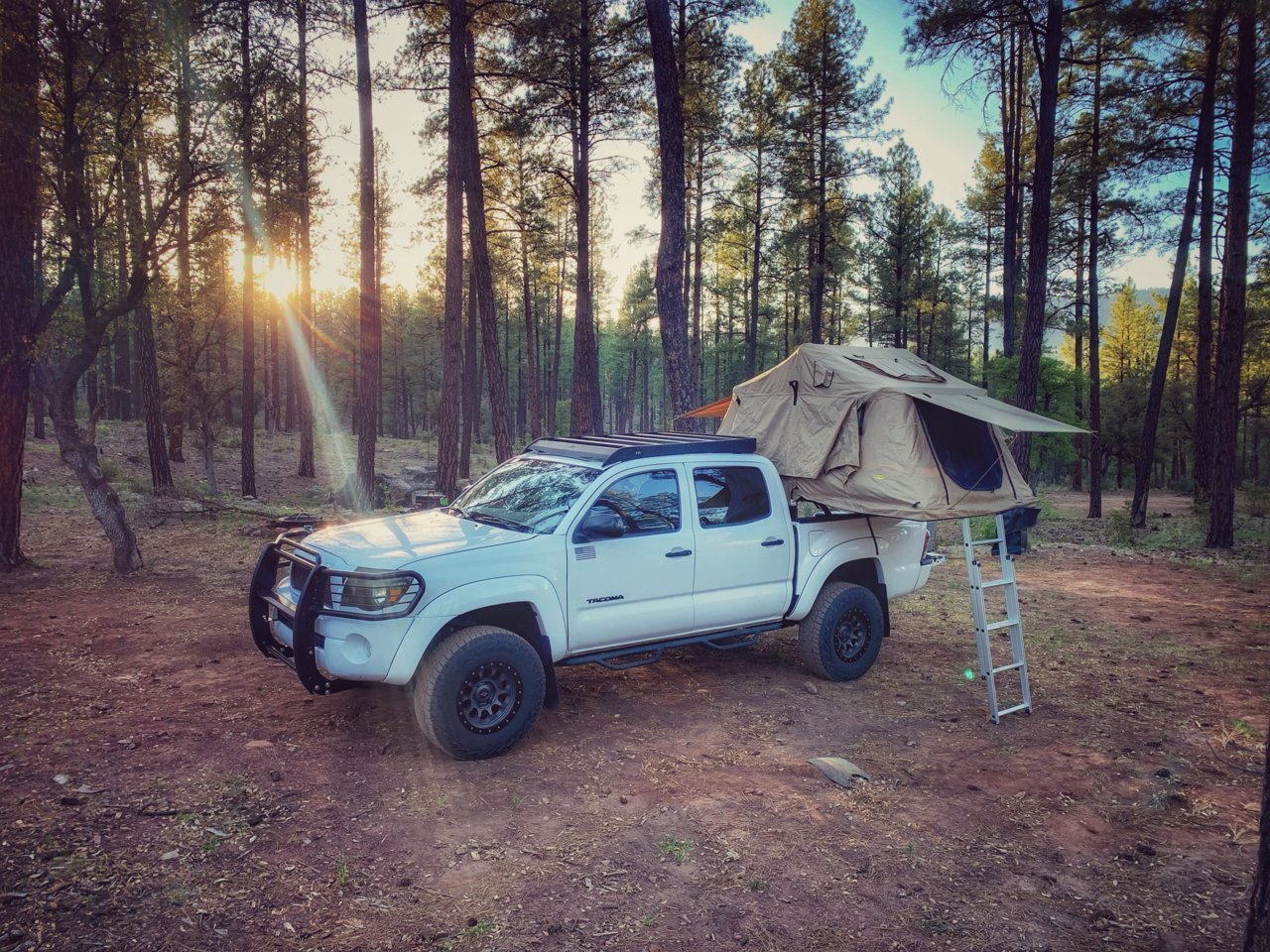

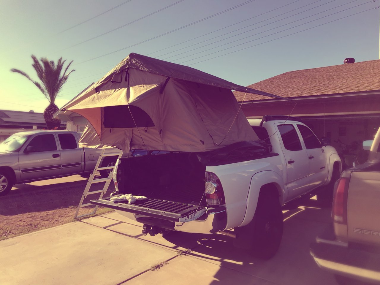

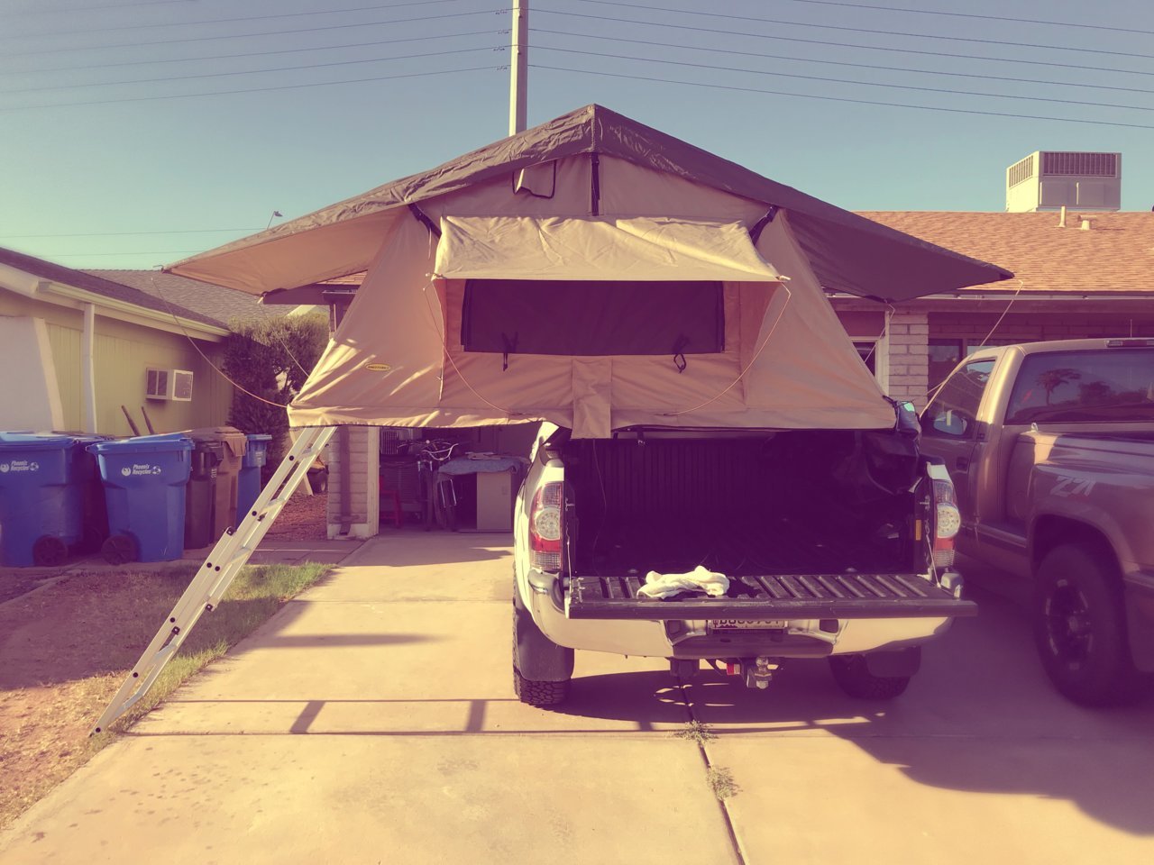

    ^Smittybilt Overlander tent, purchased from Amazon. Very spacious inside, sleeps 2 comfortably but could easily fit 3. Quality material, lots of windows and vents for views and airflow. Weighs around 120lbs, barely notice a difference when I’m driving.

    Deaver AAL in the rear = 2 inches
    OME 884 springs on my bilstein 5100’s in the front =2.5 inches
    With a 1/4 top plate spacer on the drivers side for lean.

    Did the rear suspension upgrade today. Single Deaver AAL on each side gave me about +2 inches. Whole thing took probably close to 4 hours with the help of my dad. Super happy with the outcome, front being done in a week. B17199B9-91F4-46D2-AE1D-A017DB340A57.jpg1A5784A6-DF44-4484-9D83-3BCD6B57981B.jpgA0783C4A-5D87-4BEB-BA18-E115986E4442.jpg

    Lift finished! OME 884’s on Bilstein 5100’s set at 0, and 1/4 top plate spacer on drivers side. Thanks to @HeadStrong Off-Road for the lift suggestions B8022656-2512-4A60-89A9-63798CB2CC7A.jpg8E8878A1-EDA5-4843-AC69-4F2005CA1B04.jpgCF94EEB7-A873-4887-AC4C-916AB4DAC569.jpgD407EDA6-D338-4DDF-9F5F-5EE32AD4E17C.jpg
