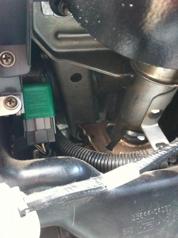

    The relay for the pump is under the dash.
    I’d see if you have power to the White/Red wire with the key ON.

    I have replaced that relay but it didn’t end up changing anything, I’ll check if I have power coming from that though.

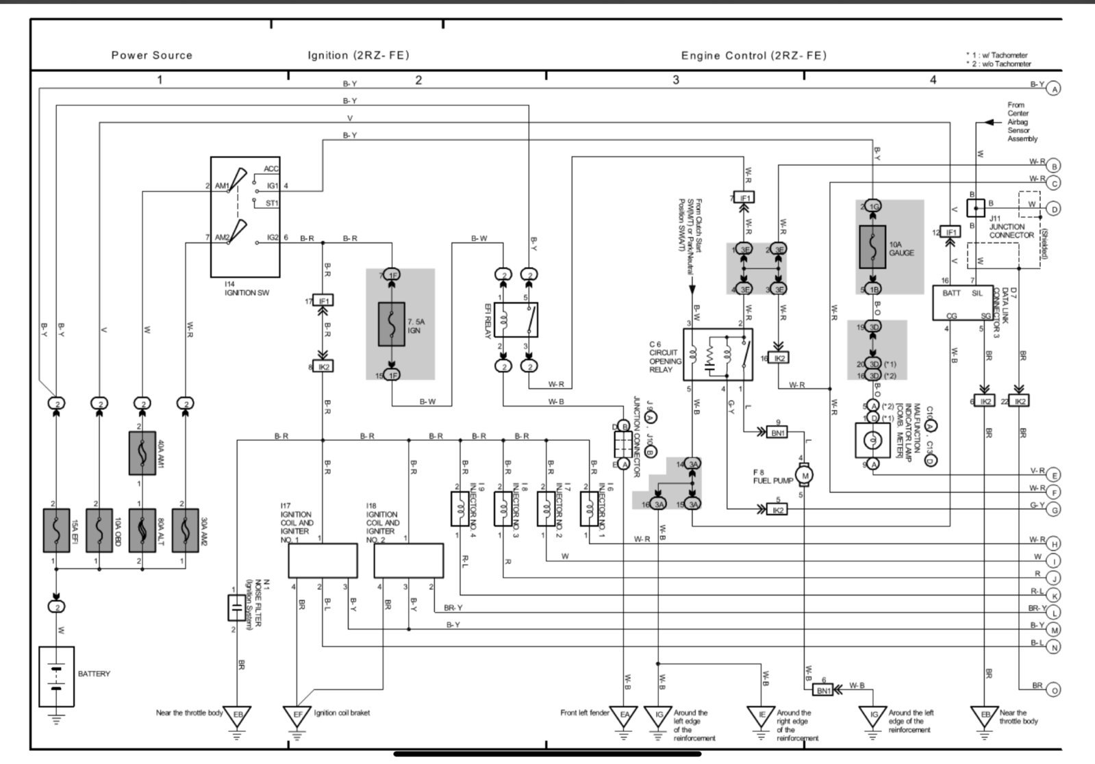

    Power comes in on the Red/White wire and out on the Blue wire.
