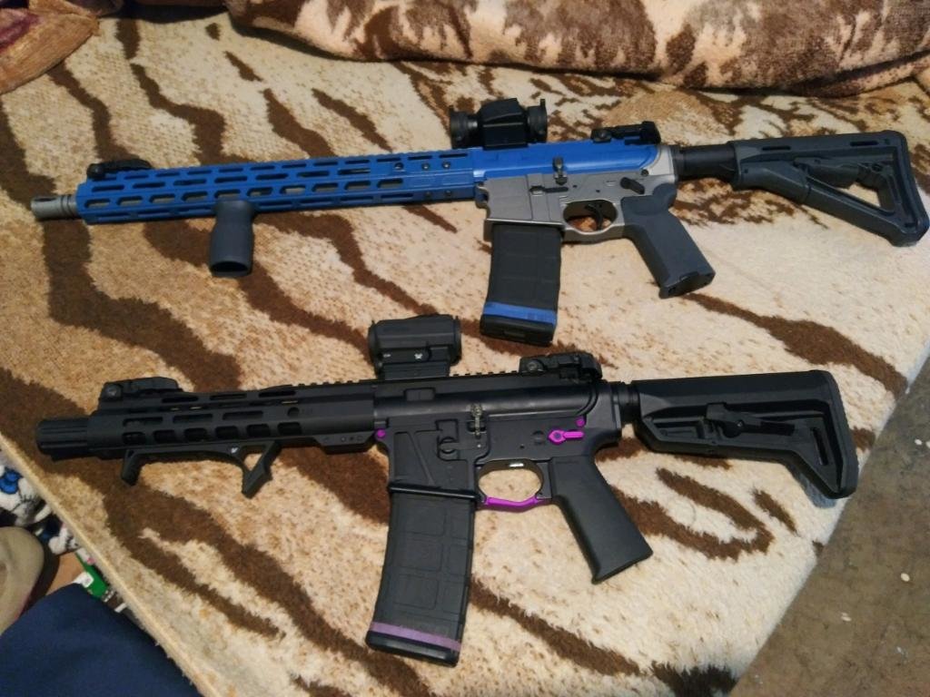

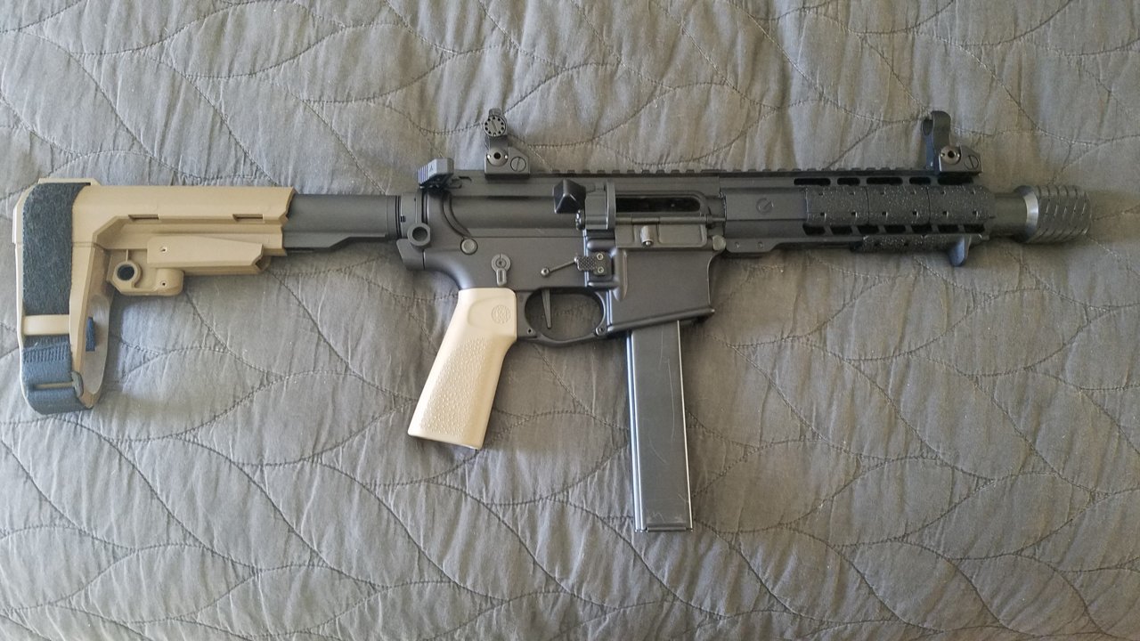

    IMG_0041.jpg IMG_0040.jpg CMMG, 4" bbl with an SWR Octane 9hd.

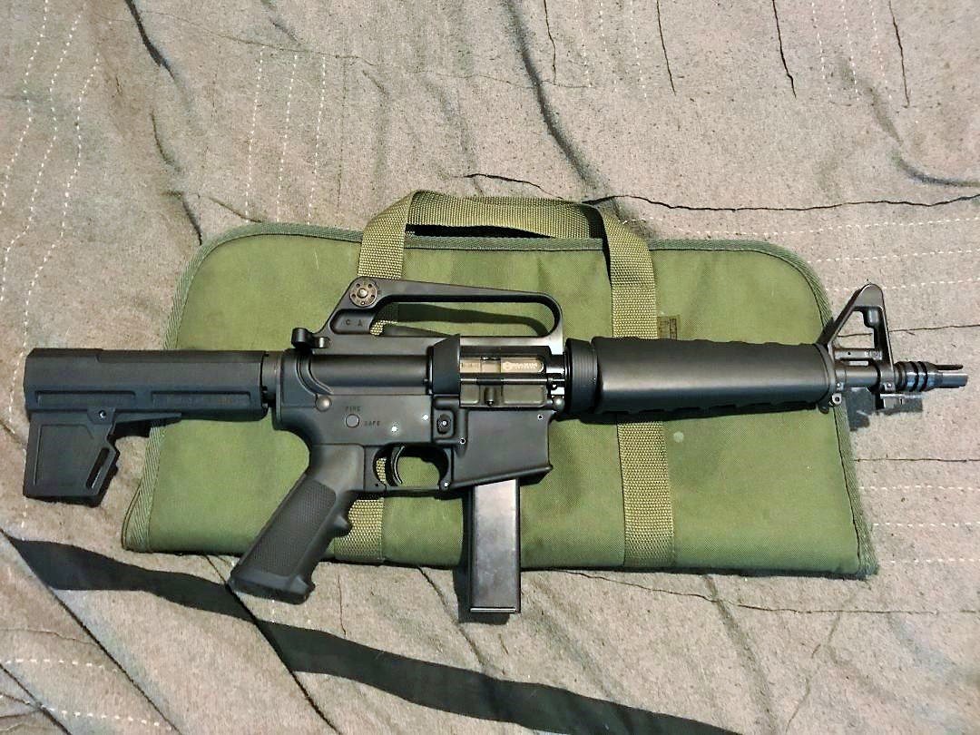

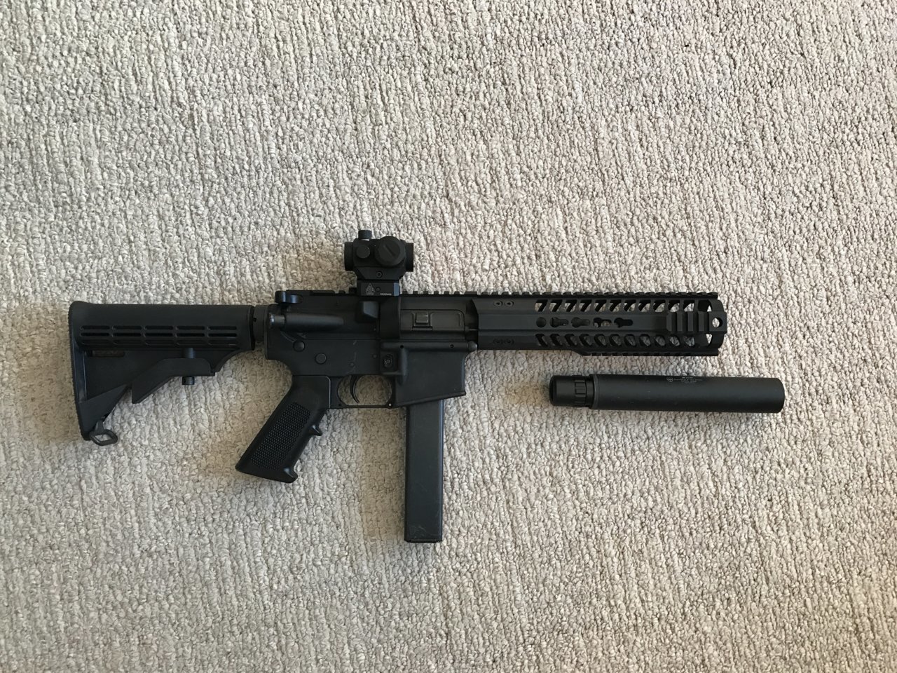

    Colt DOE clone. protecting nuclear power plants against terrorist attacks in the 80's. also used as transport protection of enriched fuels. folding front sight with flat base to stick through gun ports.IMG_3313.jpg
    same lower with another colt upper and 10" BCM barrel.

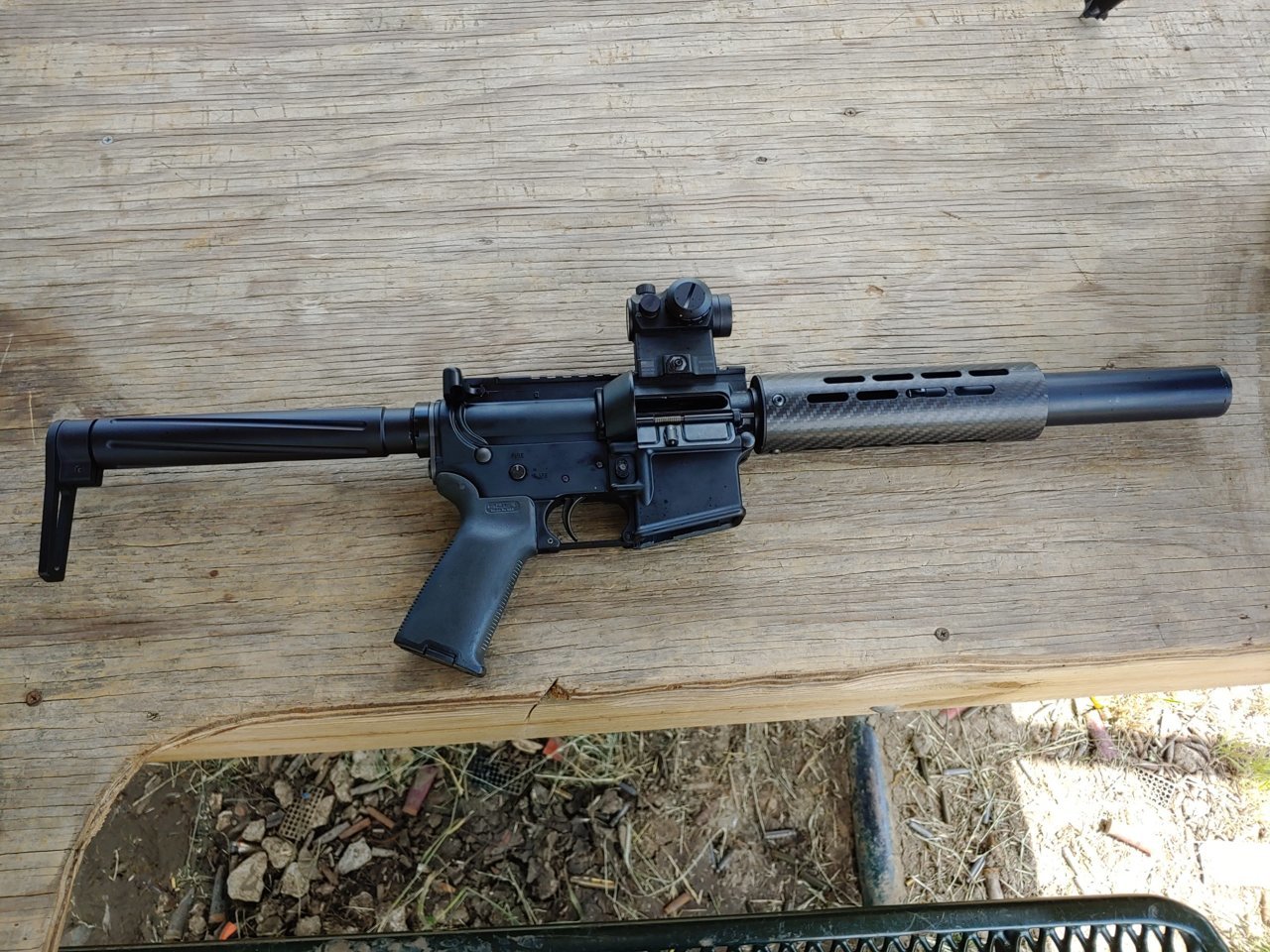

    2017 Toyota Tacoma Limited
    Stock and staying that way
    PSA lower
    ALG QMS trigger
    Spikes mag-block
    PRI Gasbuster charging handle
    CMMG remped bolt
    TROS 5" barrel
    AP Custom CF handguard
    Spikes ST-9x steel buffer
    Magpul grip
    Guntec Minimalist stock
    Liberty Mystix X suppressor
    Primary Arms red dot
