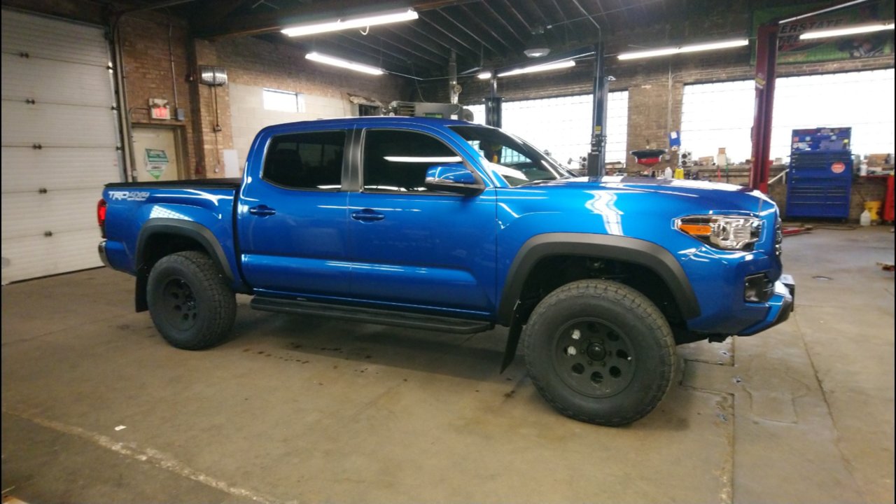

    265/75r/16 Falken Wildpeaks
    Thanks for the reply! Those are awesome looking and exactly the ones I've been looking at. The weirdest thing is that when I search on 4wheelparts, it says these don't fit my 2018 Tacoma SR5. I guess I'll just have to call them to confirm.

    Don’t waste your time. Yes those wheels will fit.

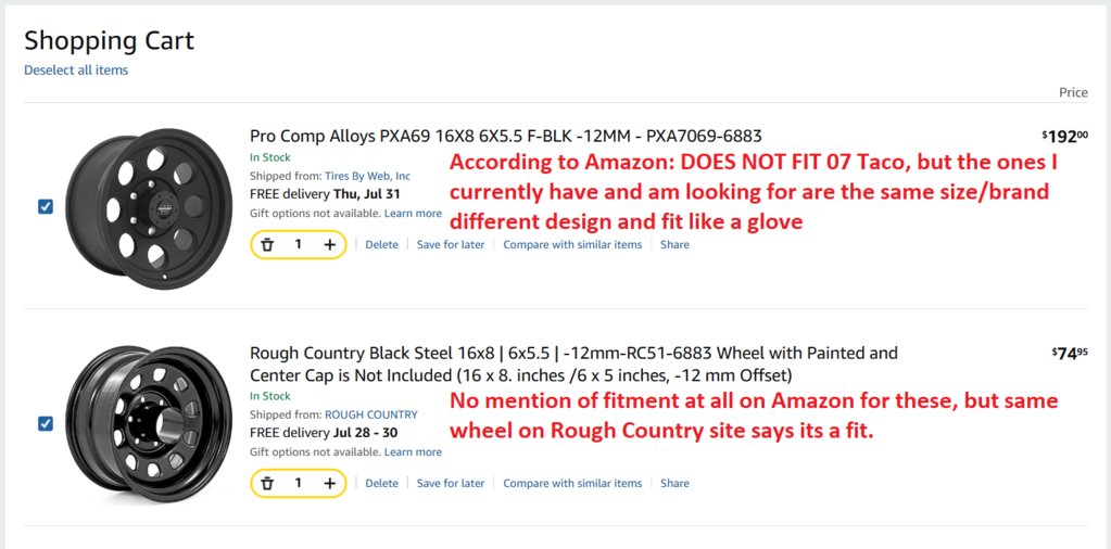

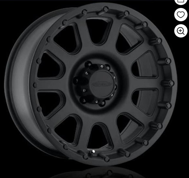

    put some pro comp alloys on a couple years ago that were inexpensive and looked great to me... cannot find them anymore nor can i see my order for them on Amazon. 16x8 with -12mm offset looked like these
    Edit: Looking for another set for my kid

    here are the ones i can find
