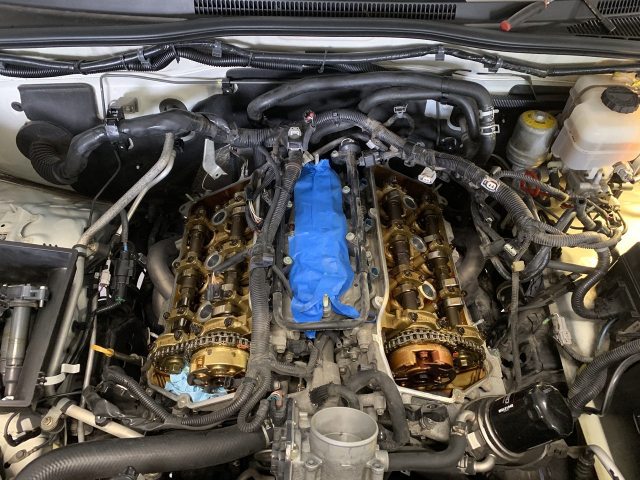

    I was planning on knocking this out yesterday but life happened. I came home to a jungle after all the rain, with more on the way, so I spent yesterday mowing.
    I’ve got some family obligations during the day today but I decided I would go ahead and tear everything apart for the cam gear install, these little engines really are easy to work on. Took about 45 minutes, but it will be ready for me to put the @mightytacoman cam gears in when I get back this evening. 590708AB-D844-4FD5-92C6-3E2B2F1FC0FC.jpg

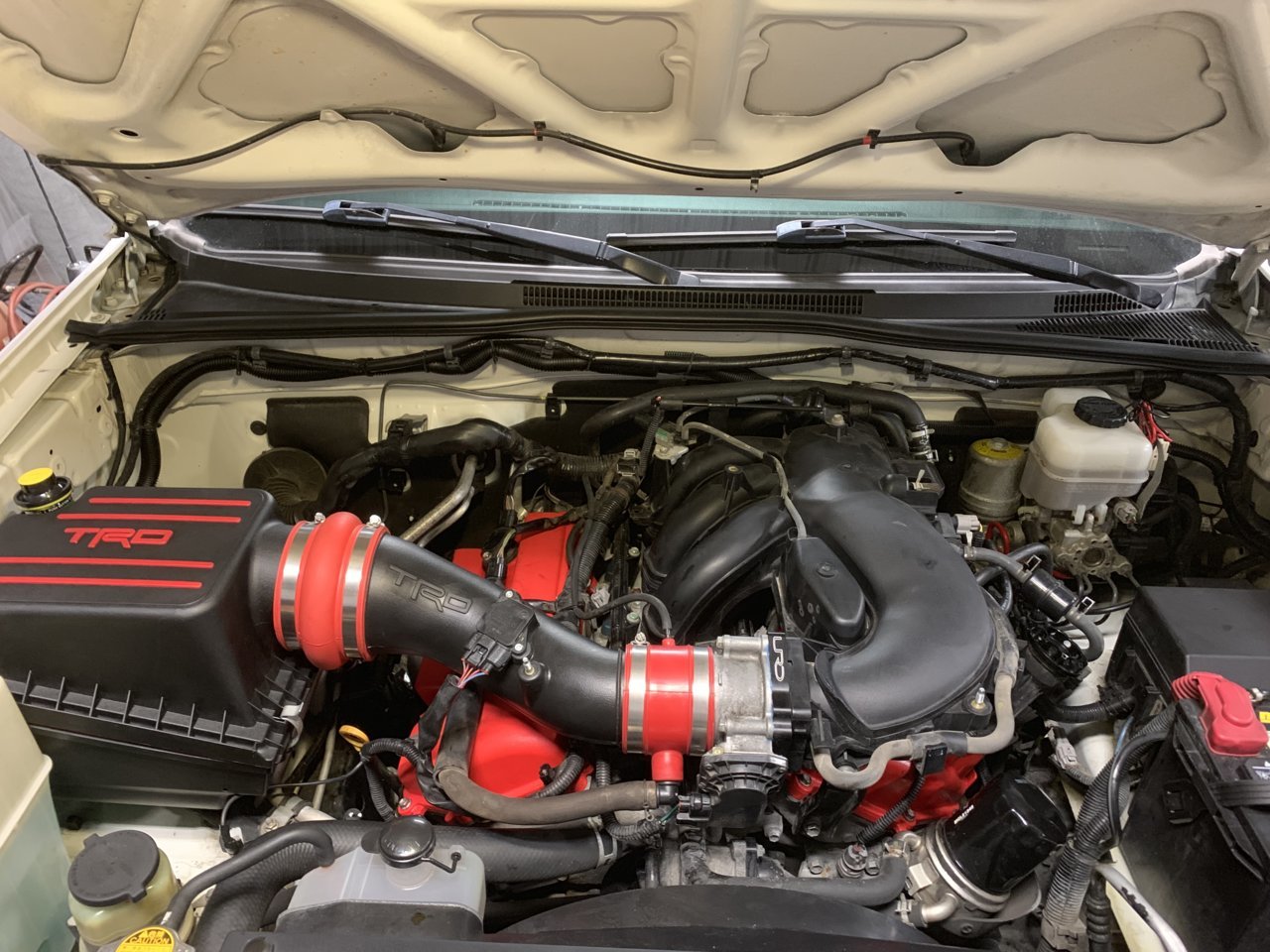

    #219
    DiamondW
    DiamondW [OP] Stockblocker
    Feb 1, 2019
    #281480
    2,206
    Kent
    Gonzales Co. TX
    ‘06 AC SR5, ‘17 Tundra, ‘14 GX460
    Cam gears are in after a few hiccups. I followed the online directions and completely missed the fact I was one tooth off on one side. It was my fault, I was joking around with my wife, and playing with the kids while working, I flat missed it. So after round two, the truck seems very happy, and the prelim data logs look good. I will be logging tomorrow with more throttle but easing around the county roads felt really good. A big thanks to the TW crew, that I won’t bomb with a tag, for helping me out.
    Here are a couple of videos showing where I went wrong, I hope they will help someone else.
    https://youtu.be/yXqMjctjLKI
    https://youtu.be/rxk0ivFN0ZE
    And finally the new under hood look
    I shot the cam covers in crinkle finish red before I left this morning. They did not turn out wonderful so I’ll probably see if I can find a set to have powder coated.
