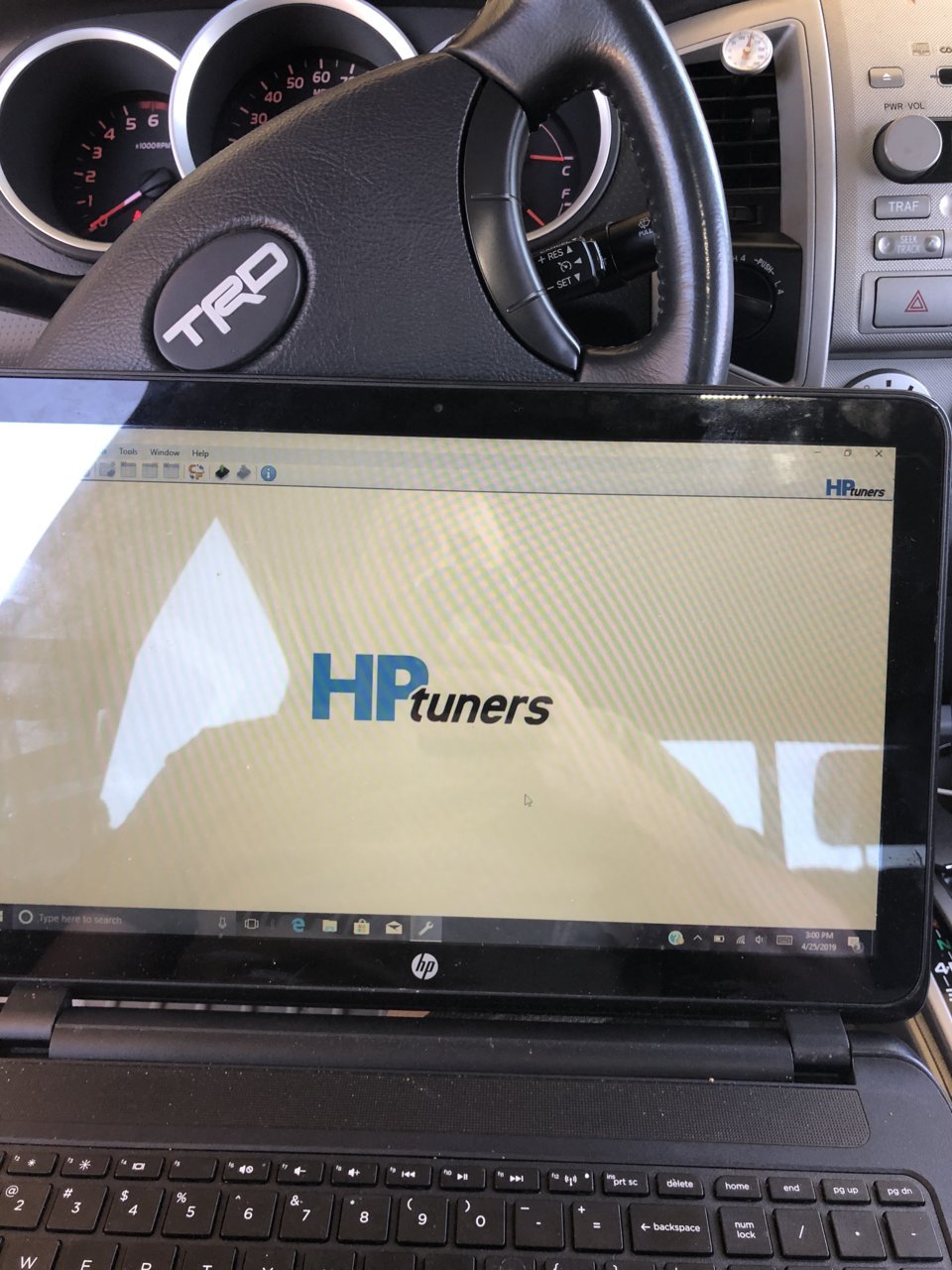

  6. Apr 25, 2019 at 2:15 PM
    #86
    DiamondW
    DiamondW [OP] Stockblocker
    Feb 1, 2019
    #281480
    2,206
    Kent
    Gonzales Co. TX
    ‘06 AC SR5, ‘17 Tundra, ‘14 GX460
    Learning right now. Gonna try out @JustDSM tune later and see where that leads.
    Took a drive and hit 130 on the intake air so maybe a snorkel to cool it down. :)

    Ok, got loaded up with @JustDSM stock tune this morning. I haven’t conferred with him since, so he will be reading this with everyone else lol. Initial impression is positive. I haven’t had a ton of seat time since the flash but overall drivability seems improved. I don’t think there are big gains to be made without bolt ons, but the power seems more linear than before. I’ve never had a pedal commander or the like so I can’t compare to that. The place I think most of the improvements happen are 2.5-4K WOT, seems to pull harder there than before (perfect for highway passing). I will be hitting the rollers on the 9th and we will see if it’s all in my head. Would I buy it again, I’d say yes. I’ll be driving more over the next few days and update. After I get on the dyno to get baselines the bolt ons will start. I’ve always run 93 octane when available so I feel like I’m getting my money’s worth now :rofl:

  16. Apr 26, 2019 at 7:58 AM
    #96
    DiamondW

    2,206
    Kent
    Gonzales Co. TX
    Thank you man. Comparing your tune to stock in the editor is really helping me to understand gas tuning more. I am going to College Station Monday, and I’m gonna take the tacoma just to see how the fuel mileage plays out. Hopefully I will have some positive hard data for you to use. Looking forward to the cam gears, I’m much better at non computer wrenching :rofl:
