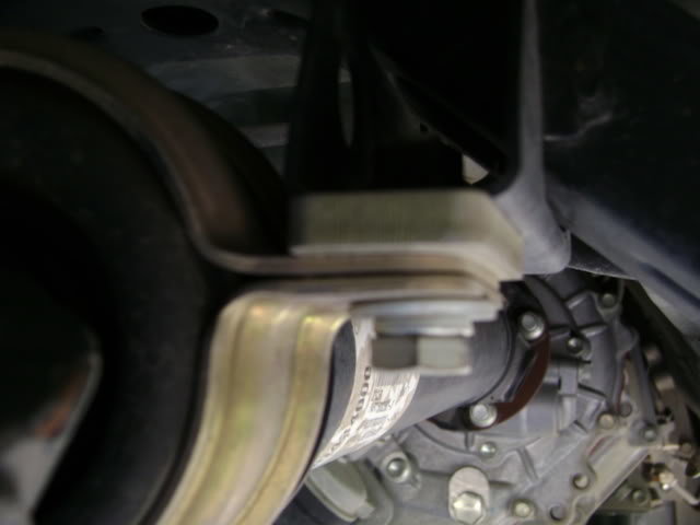

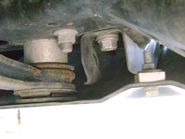

    My toytec 3" lift rides better than stock imho. (a little stiffer but not much.) I have the TSB done and a 1.5" block. If you have a DC truck Toytec reccomends the 885 coils I however got the lift before they made that suggestion, I have the 884 coils. The Tsb has settled and so have the front coils, it looks level to me. The price I paid for the lift to my house was $460 and I installed it with the help of a friend. I also installed the diff drops (rear is a shim) and all other drops. You could get it cheaper and make your own hanger drop, front diff and front skid.
    Skid and front diff drop.
    Hanger bearing.
