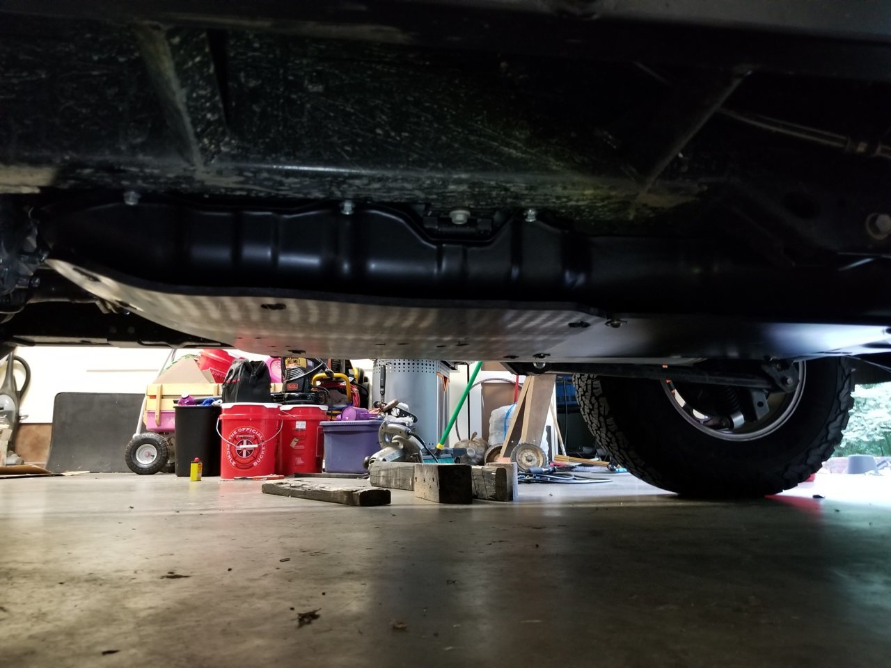

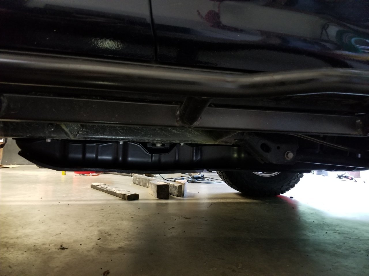

    Gas tank skid almost done.
    Welded flat bar strips to oem skid so i could tap holes and have nothing protrude on the tank side. Used 2 small sections instead of 1 big piece to mitigate big thermal expansion differences of plastic vs metal. Still need to spotface the holes and cut screws to exact length.

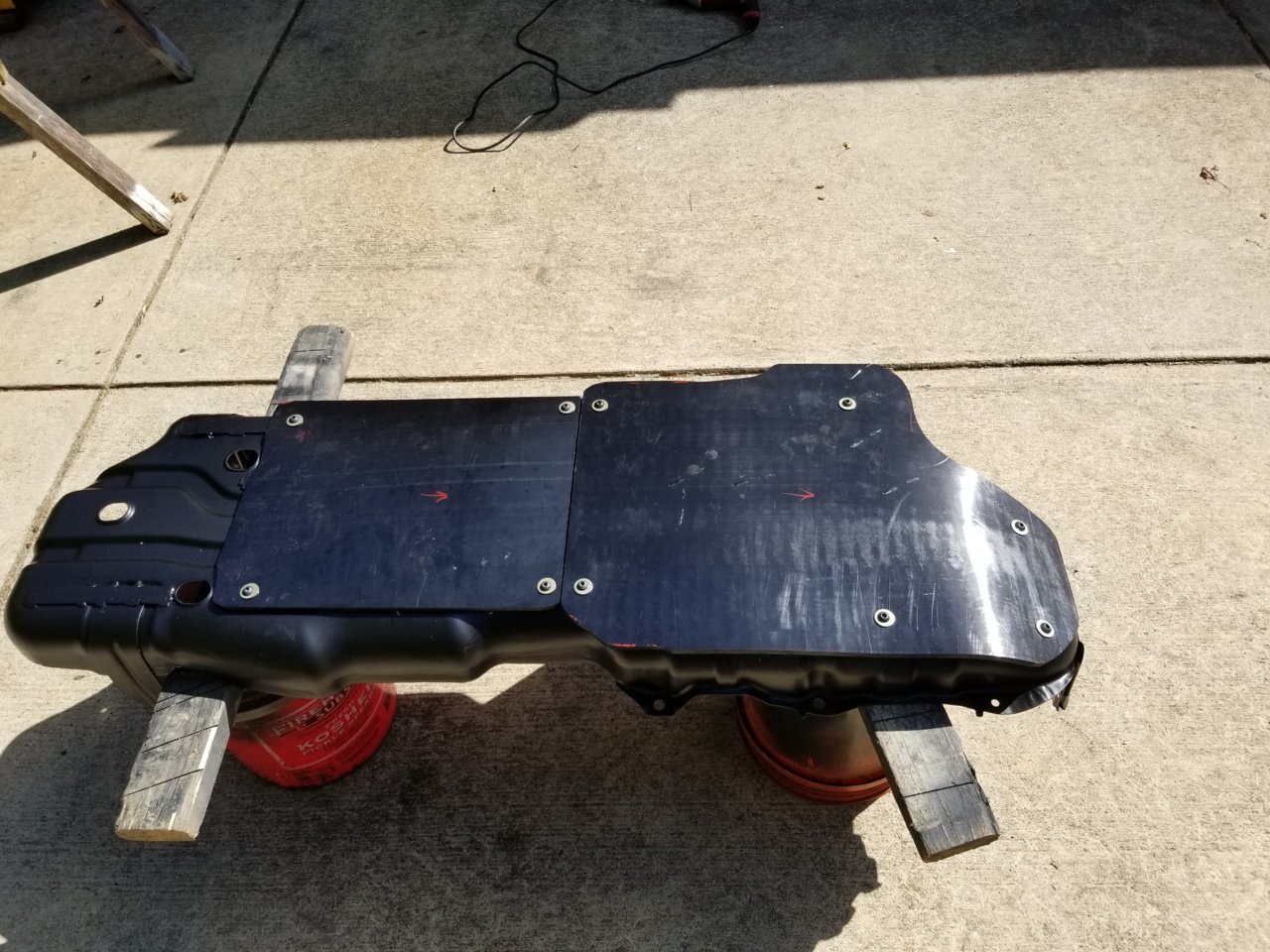

    4,665
    Daniel
    TN (memphis-ish)
    4Runner, Tundra
    Cut & broke off some stuff.
    All mounted.
    OEM skid with UHMWPE skin added.
    Front skid is being a pain getting plastic to form sharp enough bends.
    Mid skid will be easy.
    Trans skid i need to make a frame or something since there is nothing there stock.
