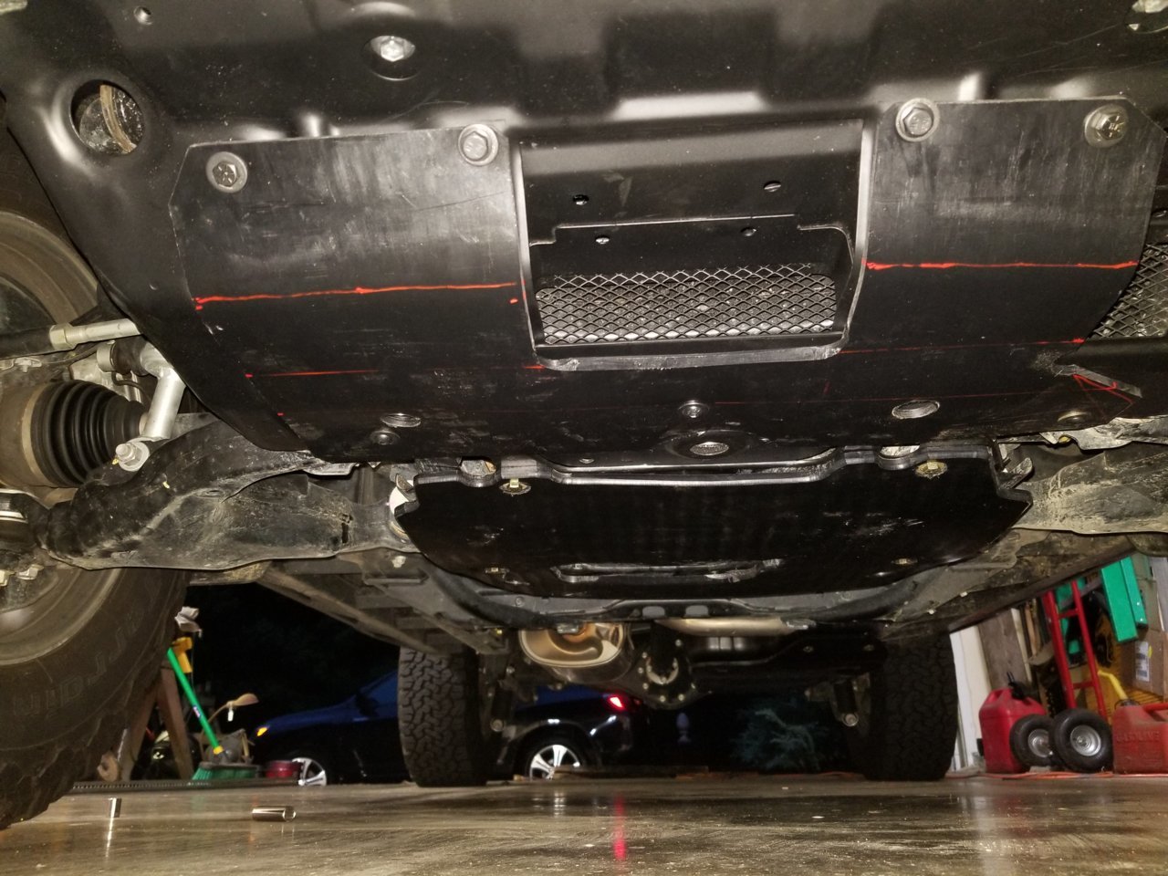

    Cut & broke off some stuff.
    I decided to reinforce all the front oem skids similar what i did for the gas tank. If/when it gets bashed too much to be worth the effort of hammering back out, then I'll get some aftermarket.

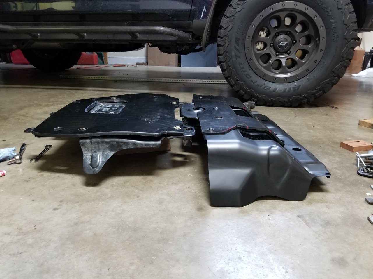

    Front and mid skids done.
    I have materials still to make a transmission skid but I've lost the will. ATF pan is tucked up there pretty good anyway.

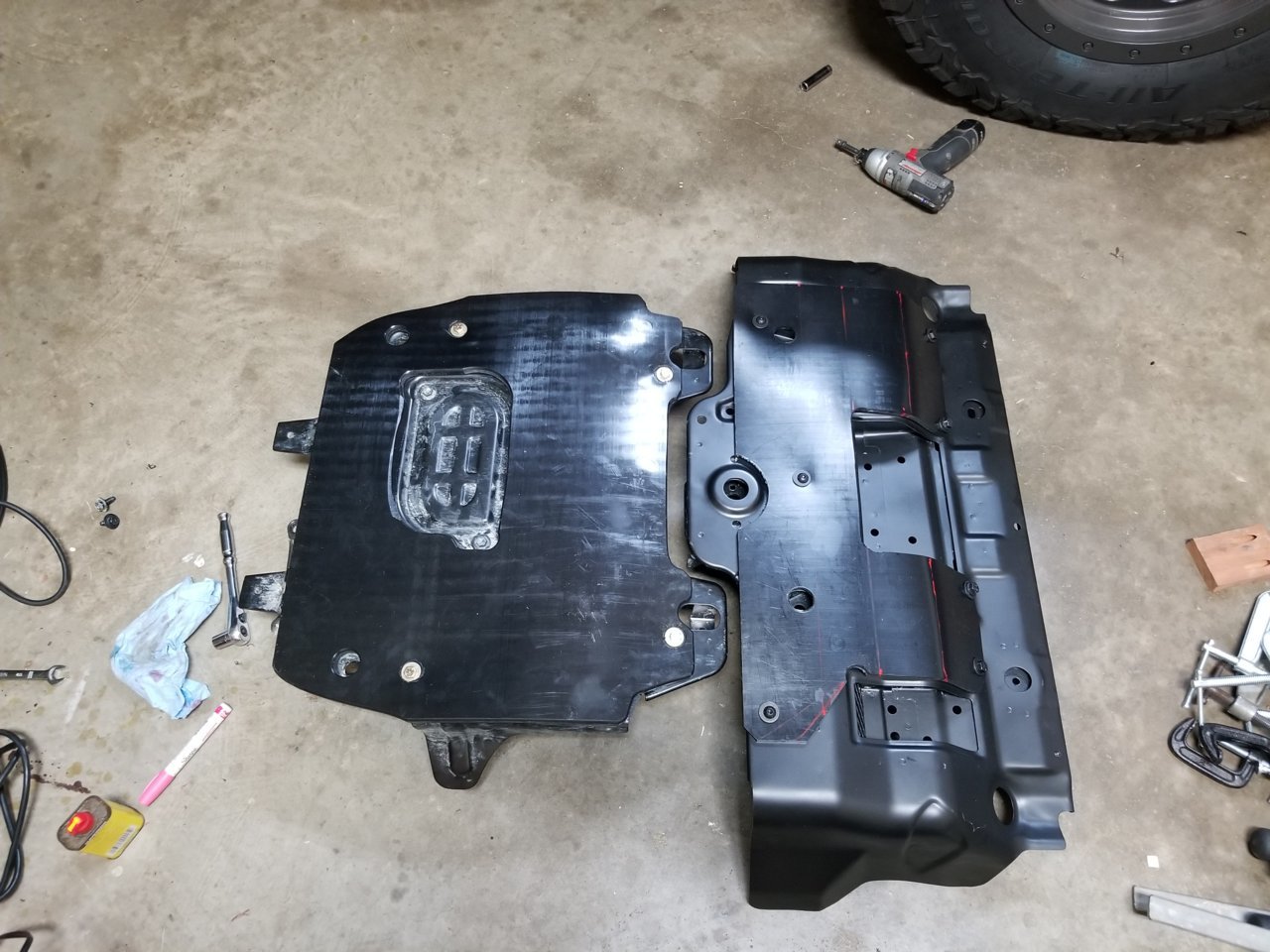

    More pics.
    I think i slotted holes in the UHMW enough to account for thermal expansion and didn't over tighten the bolts for it.
    Thinking i may eventually heli-coil the frame nuts that factory skids mount to. Didn't like how rough their threads felt tightening down the bolts.
