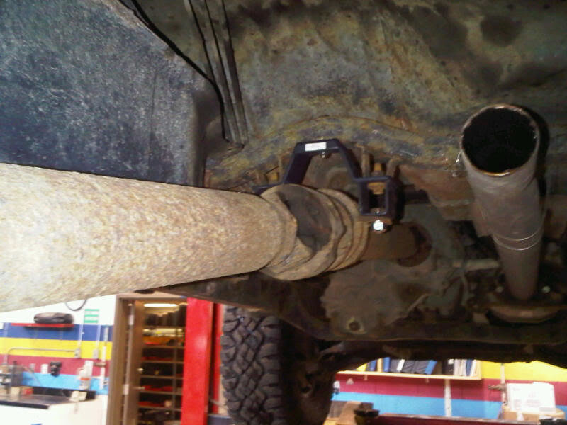

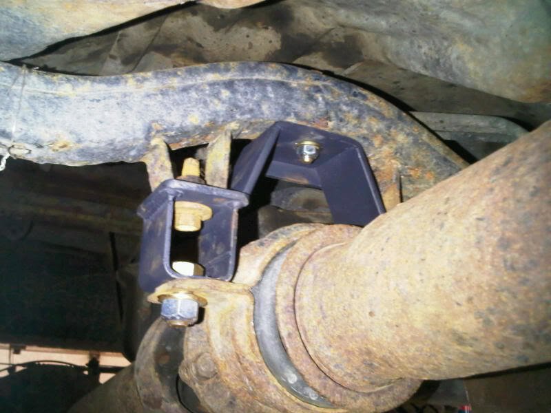

    Hey everyone,
    I just received my carrier bearing/center support bearing drop bracket from Beefed Tacos.
    I would just like to say that it is phenomenal! Its is an extremely well made and durable design. Comes with gr. 8 hardware too.
    My truck is quiet again. Before I installed the drop bracket my interior rattled pretty good when I was accelerating and decelerating thru 40kmh/25mph. Now it is so smooth. My dash makes no noise and my steering wheel doesnt vibrate at all.
    My driveshaft angle is damn near straight! lol im excited as you can tell.
    Soo all in all THANKYOU BEEFED TACOS for manufacturing a great solution!

    Op any info on what rear set up was causing you vibes?

    In the back i have 2.5" springs with overload from Northwest Offroad and some 9" travel 5125s.
    With my truck being a 96 I do have play in my CB. All u joint are fine.
    Also what I forgot to mention is that with the CB drop bracket now the slip joint is back to its stock position. Before it was extended about an inch. I had heard that this also causes vibes.
