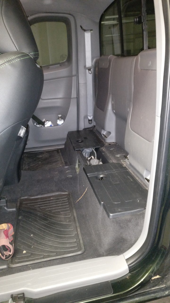

    Today I changed the oil in my truck - done it before, no big deal but I knew what size socket I needed and the torque specs for the drain plug with ease.
    Then came the second task:
    I have long wanted to remove the rear jump seats and head rests b/c ain't no one gonna sit back there, they were in the way of my dog platform, a waste of space, etc. . .
    Like most things, I tend to research/read/research before I commit. I had read multiple threads on the rear seat delete procedure along with all the mistakes made along the way. . .
    I got the seats out, the belt buckles out, the center console out - no problem; I was gonna stop and do the headrests later b/c I had read it was a PITA but I had some extra time so I started down that path.
    I was careful and didn't pull on the fabric parts of the rear panel, I slowly popped the plastic clips, one by one [full disclosure - I own a set of panel pullers and use them to help] and got enough room to unbolt the headrests and get them outta there, without dropping a bolt or a socket or anything else behind the panel; nor did I break any of the clips :)
    A few times it got dicey, I was close to loosing a piece or breaking something and I remembered the people who said they rushed and XXX bad thing happened so I slowed down, took a breath and backed off a bit. I even put all the bolts back in the holes they came out of in case I wanna put it all back in one day.
    I felt great, like I had won at something finally!
    Never ever have auto projects gone so smoothly for me.
    Again, I am extremely thankful to everyone who contributes to this forum.
    Here is a photo of the end result:
