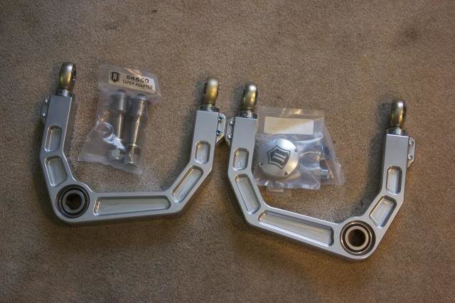

    New UCA'S (2014)

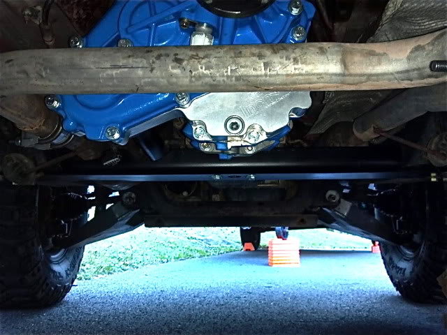

    Drivetrain.

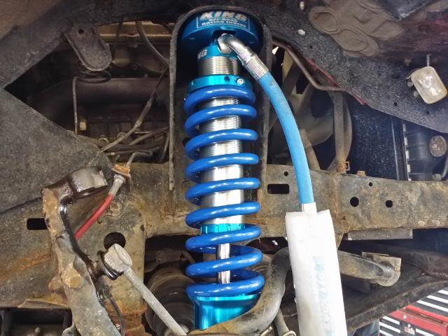

    New set Of King Ex-travel CO's 4/14
    20140405_133455_zps93891736_25e0193b4bb3c679c015e45599fb2cdc9a766fd0.jpgOne of these.

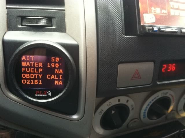

    OBD II gauge.

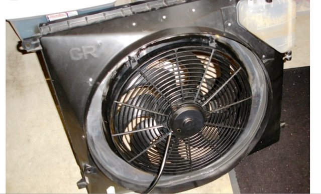

    Electric fan.

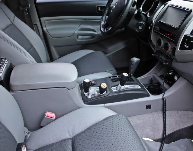

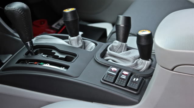

    That manual transfer case is awesome!!! Where did you get your electric fan?

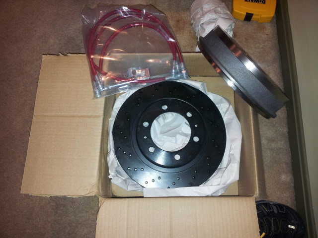

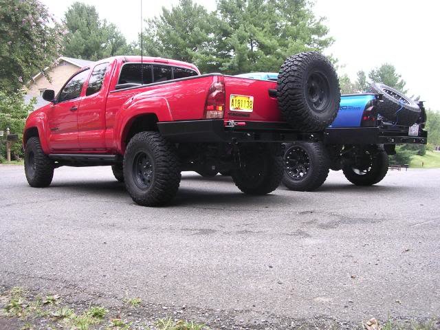

    All new brakes went on the old girl this week.
    Shoes, drums, pads, rotors, Crown lines front and rear.
    I also ordered up some A/T tires gonna be interesting riding around on such a smooth tire since I have been on M/T's for the past seven years.

    Yea same here I was finally able to bolt down the rear brake line plate back to the axle. Been running it like that for a couple of years now.:eek: They seem like a quality product even though a tad on the pricey side.

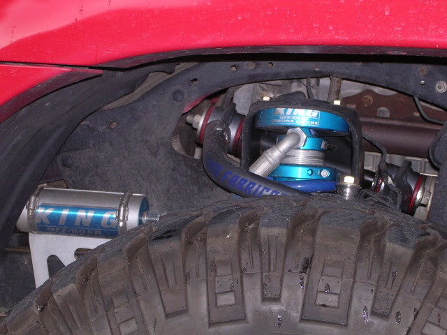

    How much length did you have to take on the drive lines to fit the Marlin?!?

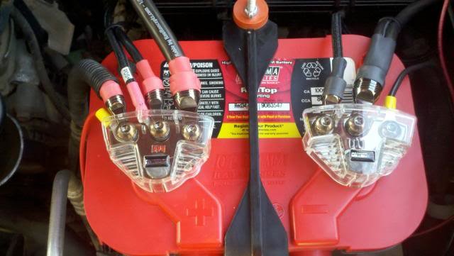

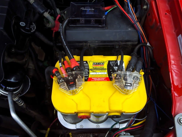

    Oh and swapped out the redtop for yellow. for as long as the truck sits without being run I thought it a good idea to have the deep cycle? I also got rid of the shat battery hold down. When we were in Moab in may I heard a loud clunking coming from under the hood, it was the battery floating around and taking out some of the wiring. The hold down broke so had to use some ratchet straps to get off the trail and make it back to town. SO I replaced it with a bottom hold Optima tray when I got home.

    None for installing the Marlin & lefty that was just a lot of cutting and beating cursing and yelling to make it all fit:rant:. Much easier in a manual trans!

    Weird. I thought the website said you had to modify the drive lines.
    If that is the case and you didnt, makes it more disirable!!
    Thanks
  18. Sep 9, 2012 at 8:54 AM
    #18
    Round II
    Round II [OP] Member #12005
    Jan 16, 2012
    #70777
    4,843
    You do have to modify the drive line (drive shafts) the front gets lengthened and the rear is shortened by 8" I had a custom one piece TW rear made up for this app.
