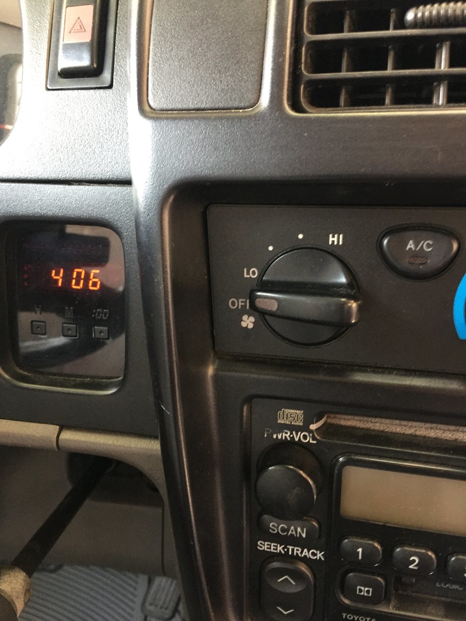

    Even went aim park the air comes out with nice flow like is a low position .

    1. Check the vent in OFF position with ignition key turned on and off. Any difference in flow and sound? If not, it is just air blown by the wind.
    If you see the flow with the key turned on (and you will hear the sound of the motor) than your blower switch knob is off. The blower switch has five possible positions: OFF - Low - MedLow - Med - High. If your knob has only 4 positions (like you shown on the video: OFF - Lo - Med -High) than the knob is off and really what you have is Low-MedLow-Med-High. In other words, you don't have Off.

    Off postion now and went i turn the switch on i do hear the motor go on an the flow coming out so is it my fan switch ? That not working ?

    Found the problem is was glue on u got to be shitting me who would glue it and not feel the air ... fix guys

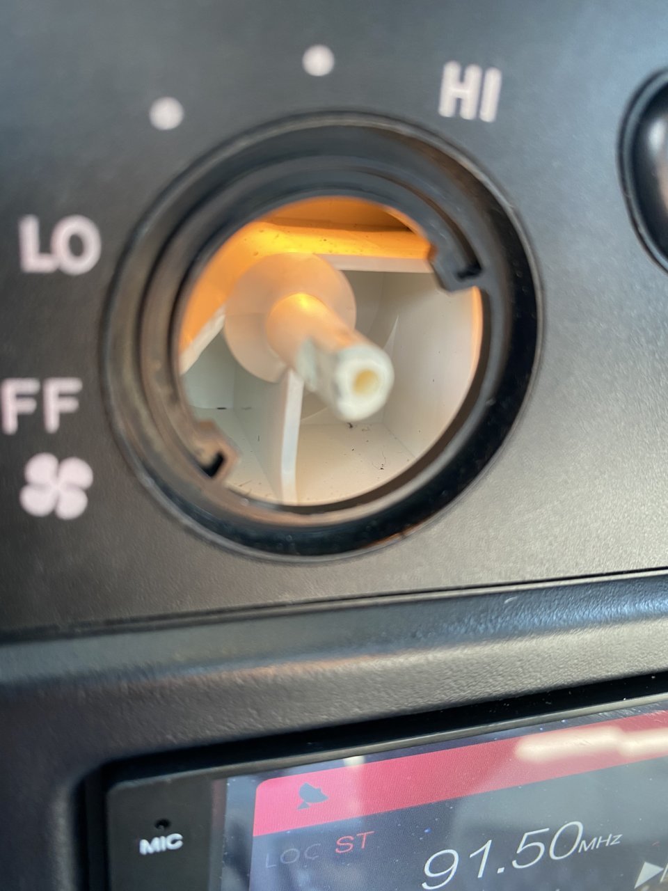

    Hello i am having same issue

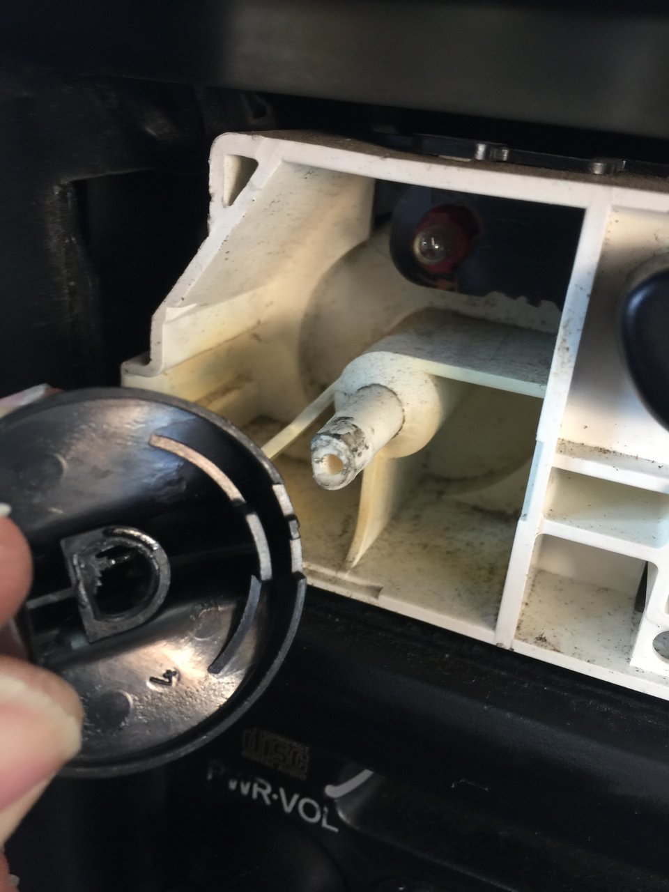

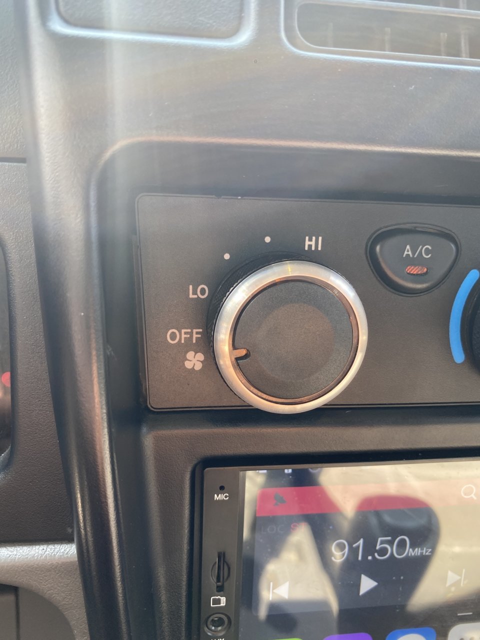

    I took
    Knob out dont seem to see any glue and i applied13E7FB9E-D39E-49D2-B223-CEBEA3ADEF83.jpg bit pressure towards off but no luck
