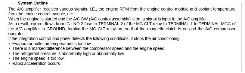

    7.5 Ohms is very high for a clutch coil. It should read between 3 to 5 Ohms.
    Light Green wire is from the IG1 No2 Fuse 10 Ampere.
    I do not know what clutch switch Knute is referring too. But you checked the relay by swapping it. Did you verify that you are getting a ground at terminal # 1 on the relay when the clutch should engage? The AC Amplifier switches the ground on and off, If you don't get a ground it will never work.

    Check the pressure cutoff switch. Even though you said the refrigerant was good, the switch could be bad. Check the pressure first, Reinstall relay, jumper the pressure switch, and see if the clutch picks up.

    OP, for sure check the refrigerant pressure switch listed in @caribe makaira's list above^^ in Post 6. The pressure switch detects very high or very low pressure and will not allow engagement. The switch is on the passenger side refrigerant pipe coming out from the condenser at the very front of truck heading back to the firewall. I will check for its parameters and post back.

    the ground to relay should be at terminal 1 no? You will still have some voltage drop across the relay coil, if the relay is pulled I wouldn’t expect to measure ground (0V) at terminal 2, I would check for it at IA1 terminal 31

    I had an issue where the connector was loose and worn on my Ford and would cause intermittent connection as the engine vibrated and would cause the clutch to drop out, ended up replacing connector with new. If pressure is good the switch should be closed.

    Yes I misspoke when I said terminal 2. I should have said terminal # 1. :oops:

    See the PDF in Post # 11 it tells you how to bypass the pressure switch.
