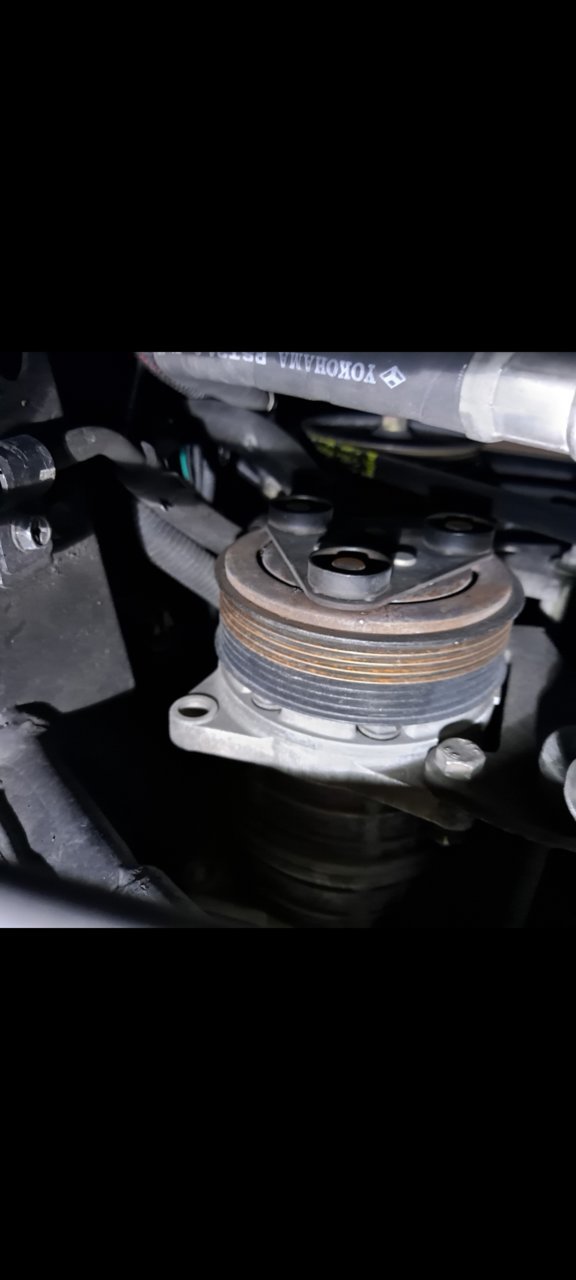

    I have been attempting to troubleshoot the compressor. Clutch cycles on & off. High pressure was too high. i had it evacuated, changed out the drier, pulled a vacuum. It held pressure over night. Recharged . i heated the garage to 70 & warmed the truck up. It is still cycling on & off. The high is at least 170 before the clutch cycles off & then it drops. Low is 15 & then it rises when the clutch cycles off. Blowing super cold air.
    Maybe I did this backbuttwards, however last night I pulled out the handy stethoscope. Being that it's difficult to listen directly to a cycling clutch, i used the bracket & can hear a distinct rattle of sorts only when the clutch is disengaged. I can't pick up any consistently odd noises from the compressor. No rattle of sorts when the clutch is engaged.
    I found a Denso troubleshooter guide. It stated if there was a rattle when the clutch was disengaged, check the bearing. If there was a constant rattle from the compressor, check the bearing.
    Are there two bearings? One clutch, one compressor? I have only seen reference to a clutch bearing. Or is it simply that there is the one & a disengaged clutch rattle would come 1st & then it would progress to a consistent rattle? Like many others before me, the "predict the future quandry" is clutch vs compressor.

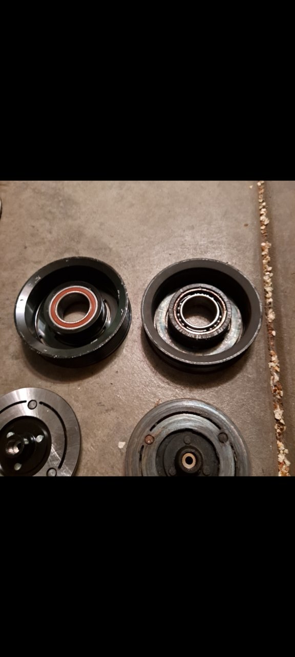

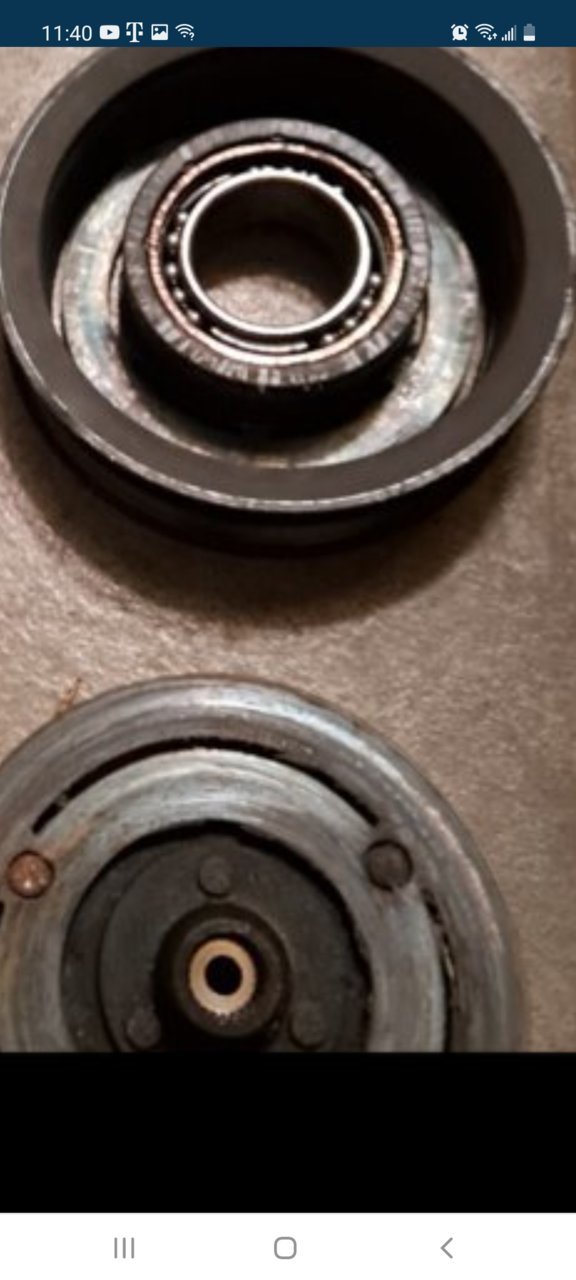

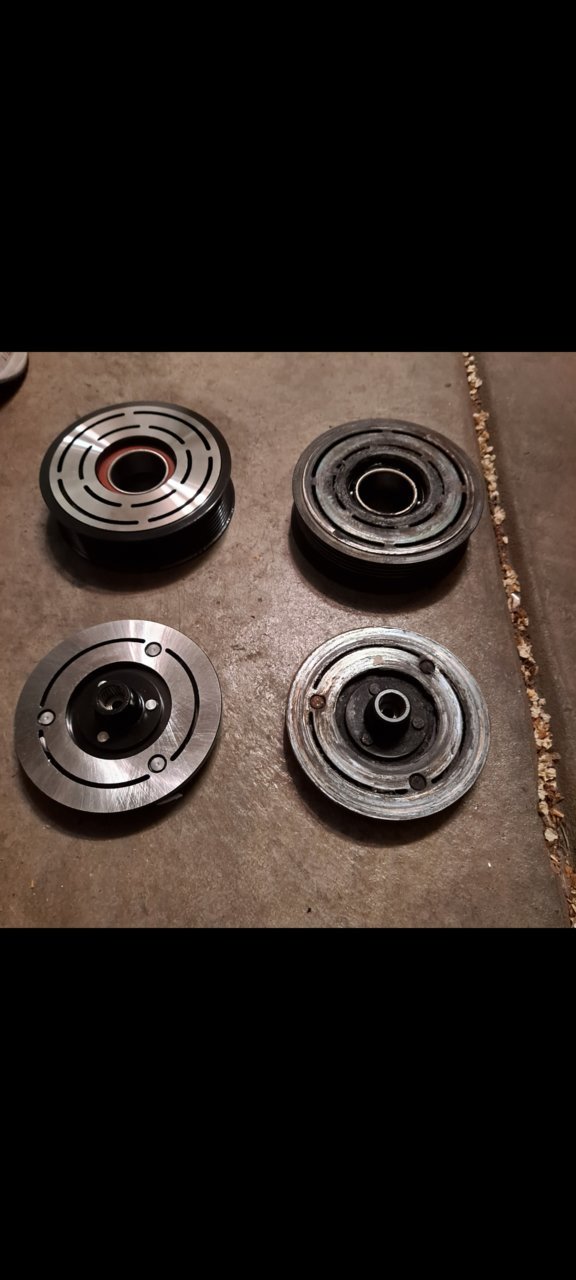

    My compressor is an aftermarket but the same thing,
    Here is my old clutch and bearing is bad.
    There is one center bolt that holds it on and the pry the clutch assembly off
    Kristi with a K[OP] likes this.

    excellent pictures… on 1997Tacomav6 last picture shows what I forgot to post in my prior… there is a selective washer, the copper looking washer on the inside if the snout, and its purpose is to space the clutch plate sufficiently far enough away from the magnetic base so that it doesn’t drag but not so far that the magnetic field cant pull it in when energized.
