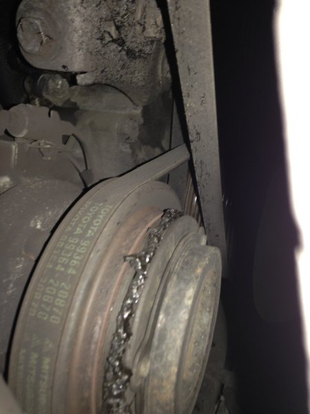

    Has anyone successfully replaced the clutch only on the A/C compressor without removing it and discharging the system? If so, what are some tips? I know the prevailing wisdom is just to replace the compressor but after much scouring of the web, I still see references to replacing the clutch only. I have telltale melted plastic around my clutch that leads me to believe that the problem is isolated to the clutch.

    For reference, this is what I have now.

    that pic looks like the pulley bearing seal went bad and grease leaked out

    The A/C does not engage at all. The first indication was that the green indicator light went out and there was no cooling. Found a blown fuse under the hood, replaced it and the new fuse blew immediately. That's when further investigation seems to indicate that the field coil melted. That stuff looks like grease, but it's melted plastic.
