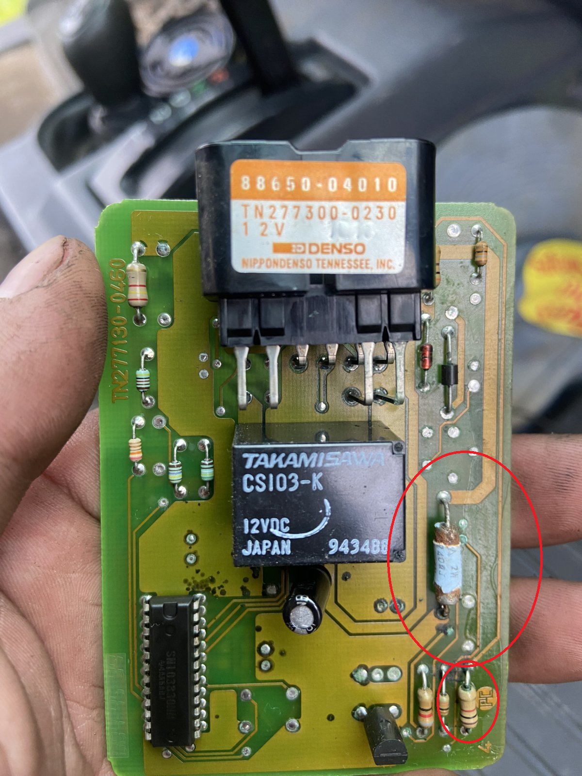

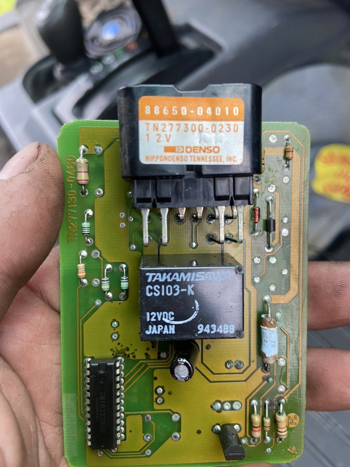

    Also could i have blown my AC amplifier trying to jump the pressure switch that way? The picture is how my AC amplifier looks like right now.

    These two look like a problem.

    The rusted one forsure. How come the other one u circled? Just want to know im curious.

    The smaller one has some green looking corossion on one end.
