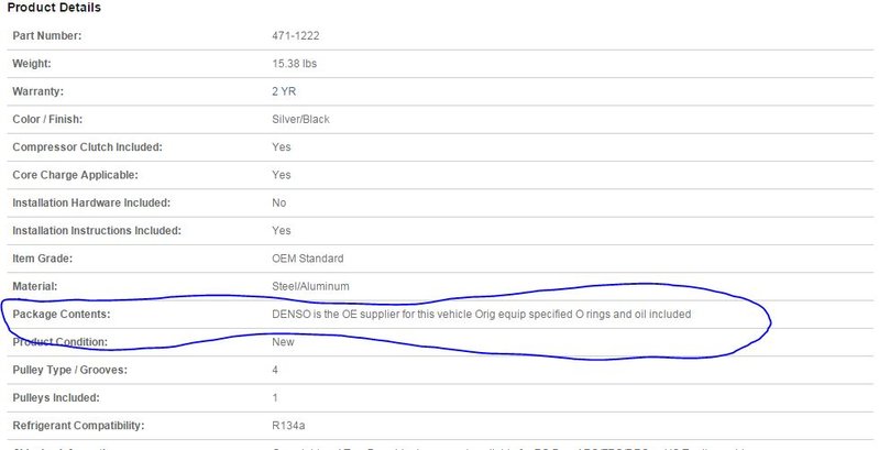

    instructions read it comes with oil already. ?????
