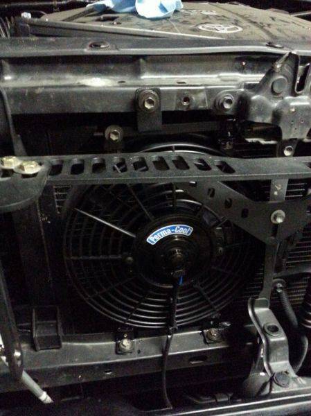

    So this weekend I'm hoping to install a 10" fan on the front of my condenser on the passenger side. Having a black truck plus it sitting in the parking lot all day equals a not cold enough a/c vent temp on the in town drive home. I've seen one thread about it, but I'm gonna wire it to come on with the compressor and be able to turn on at all times in case of overheating(I know not too likely). And I'll be able to shut it off completely during the colder months. I ordered the fan today from summit and I'm gonna fab up some mounts. Hopefully have it done this weekend. Here's the fan I ordered...

    So I mounted the fan tonight. It's secured in three spots with bushings at each to isolate any vibration. I'm just waiting on a switch from otrattw and ill hopefully have it wired this weekend.

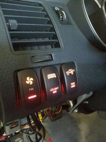

    Finished most of the wiring. Right now I have it wired to be on whenever I hit the switch. Probably wont be able to see if theres any improvement until monday back at work.

    So after a few days of testing and driving to and from work and picking up my girl from preschool. I've come to the conclusion of about a 3-4 degree difference. At idle the vent temperature stays pretty consistent at about 45 degrees. I tested it with the blower motor at the 3rd highest setting. In the mornings its gotten to 39 degrees with ambiemt temp around 80, and that was my short drive tp work, about 10 minutes in town. So to be honest I was a little disappointed but oh well. Now I have an extra fan incase it gets crazy hot. Plus it sounds cool when I'm idling. In the future I may put another one on the other side but for now my mod bug has settled down a bit.

    Yeah it does. I think my expectations were a little too high I was hoping for the effects of a non fan clutch system. But I don't think it was totally a waste of a weekend.
