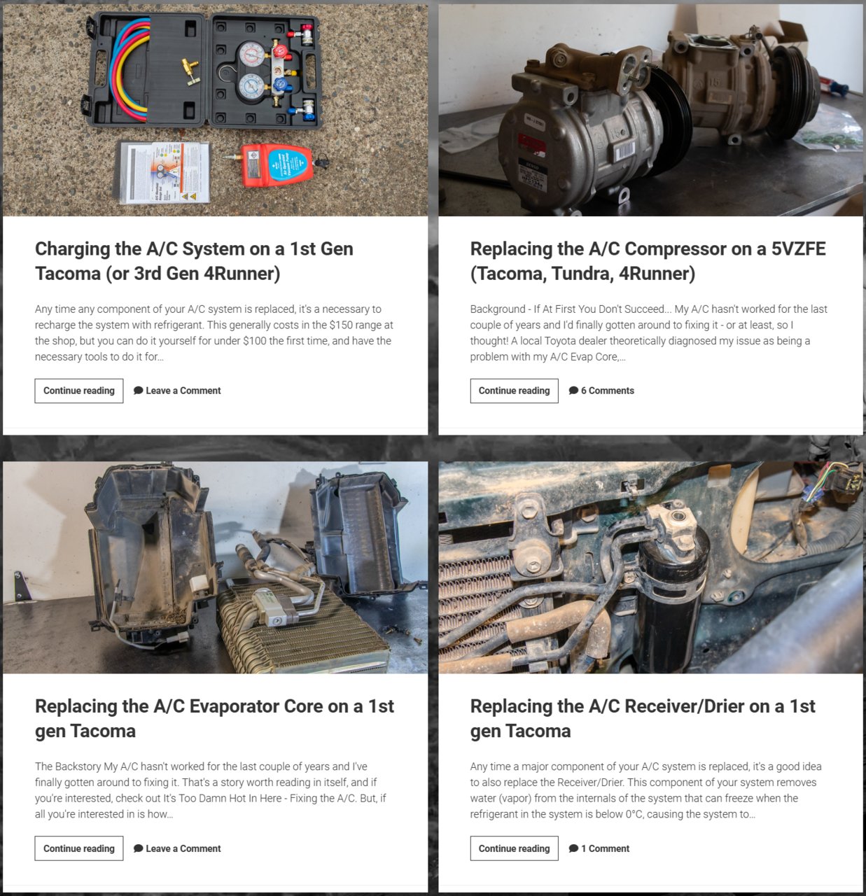

    I went through this myself recently (last summer). It's not that hard a job as long as you can get a shop to suck out any existing 1394a as @ThunderOne mentioned. When I did my work, I wrote up a series of how-to's, if you're wanting to have a bunch of photos and step-by-step of the process. Condenser was the only bit I didn't replace, though I have a Denso sitting in the basement since I figure I probably ought to do it as well just to get everything into the same age range.
    Climate Control Guides
