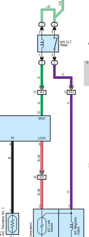

    I added a spal pusher fan in front of the condenser. I took power from the a/c fuse in the box under the hood. I assumed the fan would only operate when the a/c was turned on. Not so, it powers on when the fan switch inside is turned on, heat or a/c. Where can I get power to accomplish my goal?
    Thanks for any help.

    There is only 1 wire you can tap into to accomplish your goal. That's the purple wire that goes from the output of the MG CLT relay to the AC clutch.
    Your fan needs to be on it's own relay. You shouldn't power the fan directly off the MG CLT relay.

    Nice. Might I suggest using the tap to turn on a relay rather than adding the fan load to that existing circuit.

    Thanks, guys. I appreciate the diagram as well. I'll get on that this weekend.

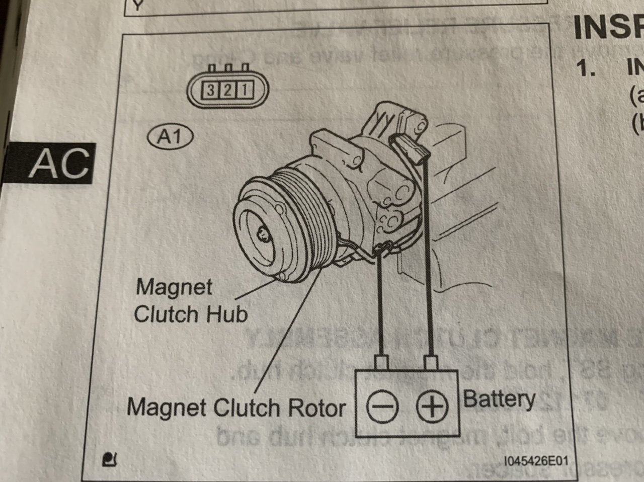

    Well, I don't get it. These replies and the manual I bought show a purple wire coming from the ac clutch. Got to the clutch and there is a black wire going to ground and a red wire going somewhere. No other wires visible. Where is the purple wire? Thanks for your patience.
  12. Feb 11, 2020 at 10:34 AM
    Muddinfun
    Muddinfun Well-Known Member
    Apr 17, 2017
    #216500
    7,489
    The red/white wire is the sensor wire on the compressor. It lets the AC amplifier know that the compressor is turning/not turning.

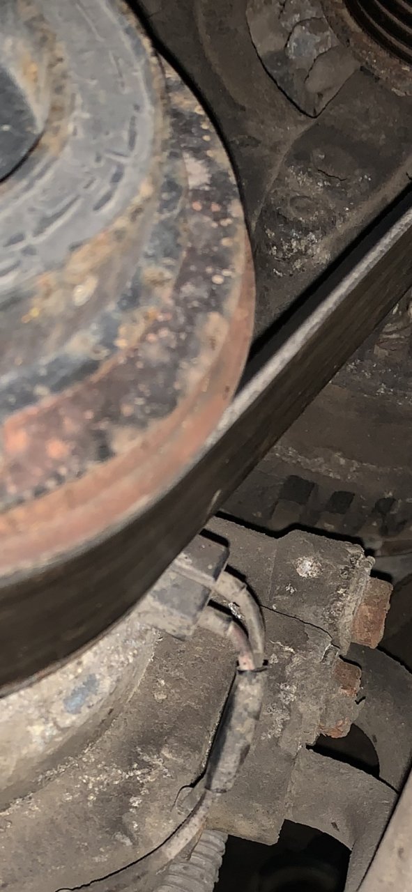

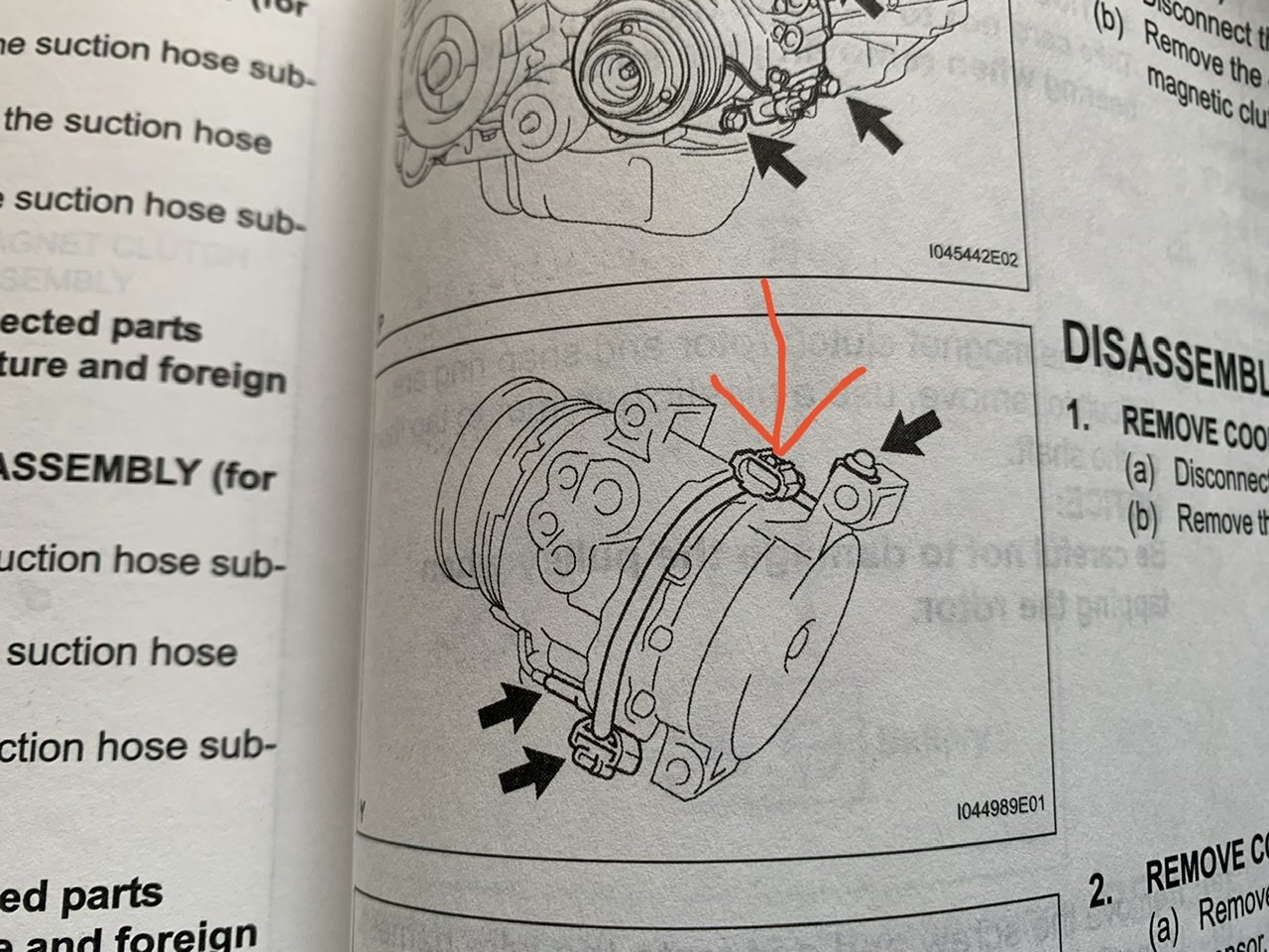

    If you look down behind and below the alternator, you will see a 3 wire connector mounted to the compressor. 2 are for the sensor and 1 is for the clutch. The ground for the clutch is just a little short wire bolted to the compressor.
    It’s horrible to get your hand down in there. From underneath the truck, you can see where the wires enter the clutch near the pulley. My clutch wire is orange. I couldn’t see what color the wires are at the 3 wire connector.
  17. Feb 12, 2020 at 4:29 PM
    #17
    Muddinfun
    Apr 17, 2017
    #216500
    7,489
    At that connector, it’s terminal 1.
    If you want to go underneath, here’s the clutch wires.
