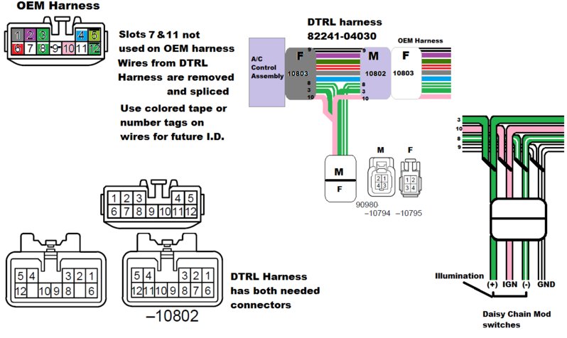

    This is an overbuild, unnecessary to most, neat removable t-harness to tap the ground, IGN and dash illumination of the Air conditioner control panel to add aftermarket switches. Especially the OEM looking ones.

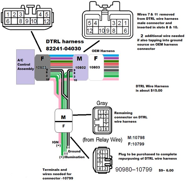

    More detail...
    If you have the TVIP Alarm (RS 3200 PLUS) you'll know what this is duplicating.
