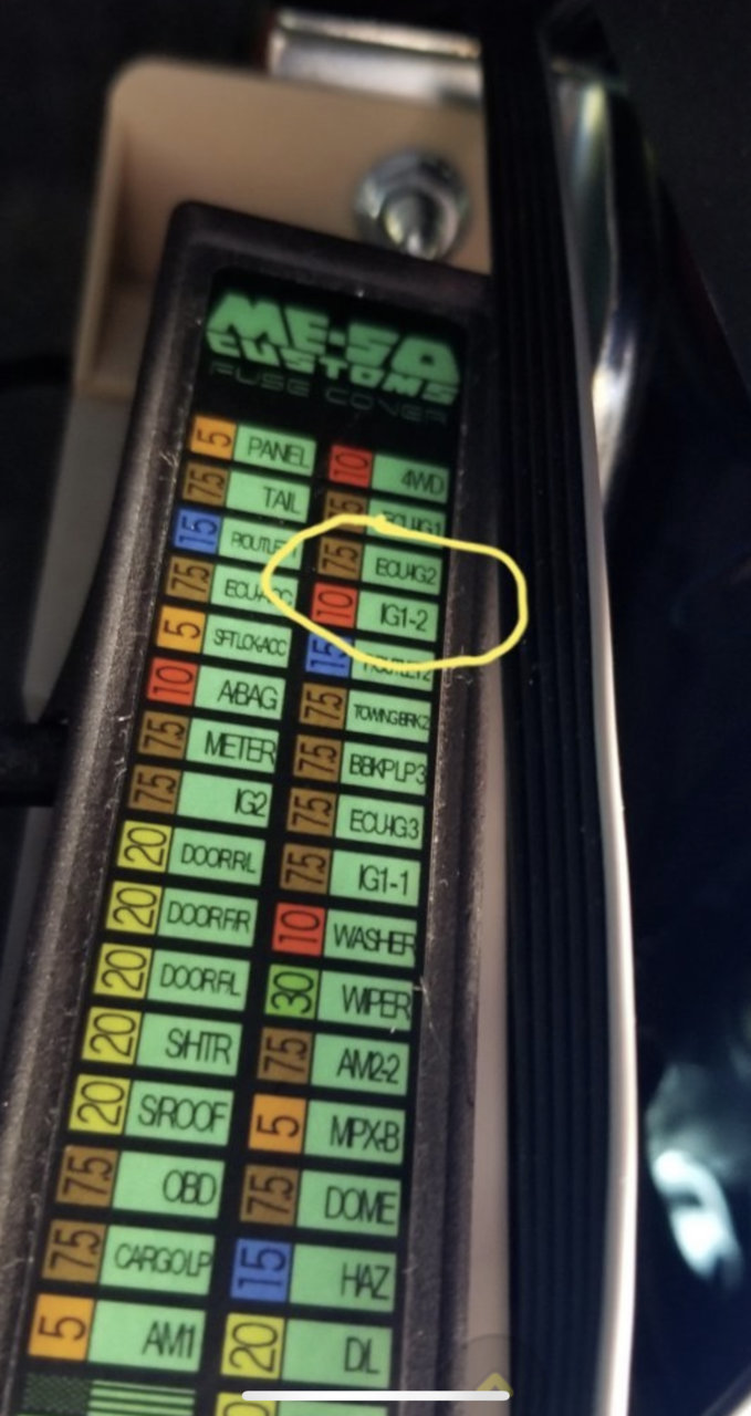

    With a multimeter I just checked the two fuzes shown in the picture, one 7.5 and 10amp. The 7.5 marks 6 amps, and the 10 marks amps while all other fuses mark 0.0 . From what i understand this means theres a open circuit there, but what now.

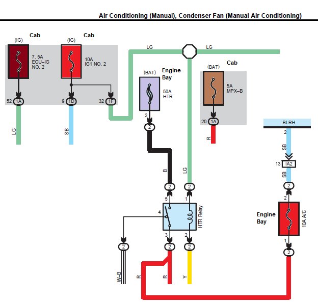

    The seat heater has a connection to the A/C amplifier.
    The ambient Temp sensor is also connected to the A/C amplifier.
    You'll need to get the A/C going to have those system/feature functional.

    Find & verify these fuses:

    Thank you this is extremely helpful. Where would the A/c amplifier be ? Is it the white cable connecters in the fuse box ?

    I checked it but it seems fine, ill take a look at all the wires related to it.
