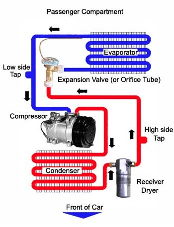

    Convert the old a/c compressor to compress just air instead of refrigerants. Some people swap in a different compressor instead but i have seen a stock 91 Toyota pickup compressor fill up a tank to air up 38s.

    Wow! That sounds sweet, I know nothing about these compressors though. My only thought would be a lack of lubrication :notsure:

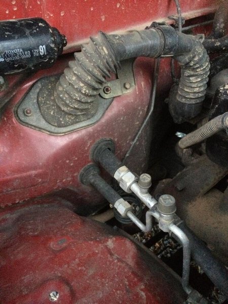

    ImageUploadedByTapatalk1409462515.618708.jpgwhat do I do here with these two?

    I guess my current question is how to remove the evaporator without killing heat. Reference pic.

    There is no reason to remove the evaporator. I didn't.
    I removed those refrigerant lines, and plugged them with corks :eek:

    In response to your PM'd question about using the compressor for on-board air, I kept them lubed with an inline oiler like those used for air tools. Its not perfect, though. Every couple of years, the compressor would burn up anyway, and I'd get another one from the wreckers.
    My setup followed the same basic design that you posted in post #11.
