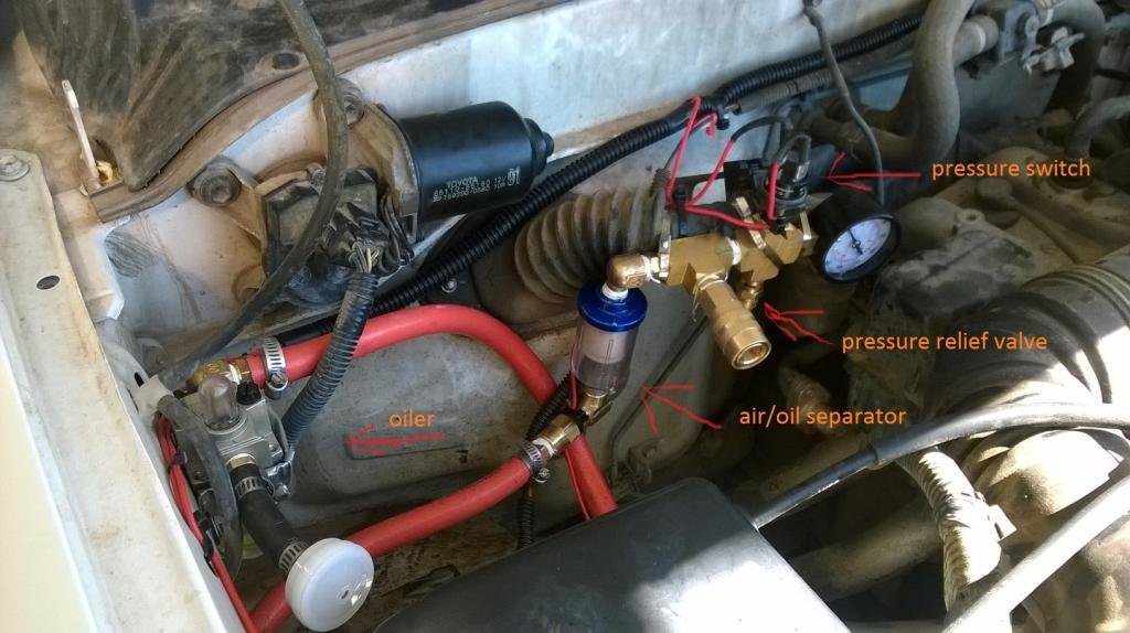

  7. Sep 12, 2014 at 5:32 PM
    #27
    vern650
    vern650 Well-Known Member
    Sep 2, 2013
    #111738
    837
    brandon
    hyrum, ut
    '97 4x4 taco xtra cab 3rz/5spd
    HBS leveling kit, 31x10.50 mudders, header/imco exhaust, rear billies, LR ucas, home brewed onboard air, cb radio
    i got bored last weekend so i went ahead with this project. i just cut the rubber hoses on the a/c lines and used barbed fittting in them to connect to the airlines. to them i just plumbed in an air tool oiler on the intake side of the compressor and just hooked an inline fuel filter on the end of the hose to help keep crap out. on the pressure side i ran the hose to a check valve then to an air/oil separator, then through a T with the air chuck on it. from there the other side of the T is plumbed into a cross which houses the gauge, pressure switch and pressure relief valve. i mounted a toggle switch under the hood and wired it in before the pressure switch, some folks like to mount the switch inside or im sure you could rig it up to work off the factory a/c button but i figured i gotta go under the hood to hook up the airline anyway so i stuck it under the hood. when engaged the gauge shoots right up to 120psi which is where the pressure switch kicks it off, i used a 90 on 120 off pressure switch and it works great. i didnt feel like letting the air out of my tire to test it so i tested it on my lawnmower tire and it aired it up in no time flat. i'll probably plumb a tank in in the future but for now it should work for airing up tires. cost was probably $150+, those little brass fittings add up pretty fast.
