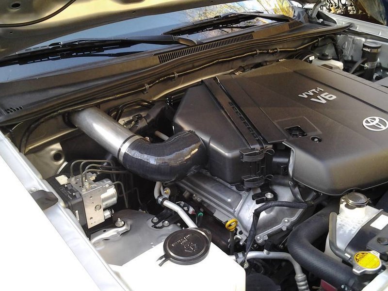

    image.jpg This is below the black thing under your windshield wipers. It's how fresh air gets into your truck when the Windows are up. A lot of people have problems with rats getting in there and making nest.
    You can see from the picture this guy has put wire over it to prevent rats from entering. But you could also put screen (window screen) over it to keep Pinestraw and leaves out

    To access it you really done even have to take the wipers off. All you need to do is pop hood. Go to pass anger side of engine, Locate the retention clip in the corner, remove it and lift up. If you do that you can access it. I have accessed mine many many times that way. Even had my snorkel ran into it for almost a year.image.jpg

    Thanks for the tip, and as they say, a picture is worth a thousand words. I'll definitely take a look.
