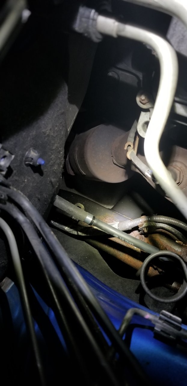

    1. I first connected the included hose to the adapter and put the zip tie on. Tighten it up as much as possible. Cut the excess zip tie.
    2. I then slipped the zip tie on the end of the new hose and slid it down to the adapter and put it into position. Make sure to not make the loop to small or else you will not be able slip it on just like I did on my first try.:D20211222_173219.jpg
    3. I unhooked the top right splash guard pin and then tightened the zip tie on the adapter and make sure to have it as tight as possible. Cut the excess zip tie off. Re attach the splash guard.
    4. Then I un hooked the lower splash guard pin and I zipped tied the hose to the foil wrapped hose behind the splash guard. Cut the excess zip tie off. Re attach the splash guard.

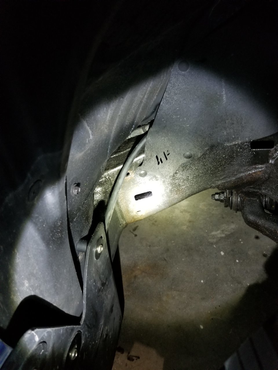

    5. Run the hose out the back and run it towards the mud flap. 20211222_182318.jpg

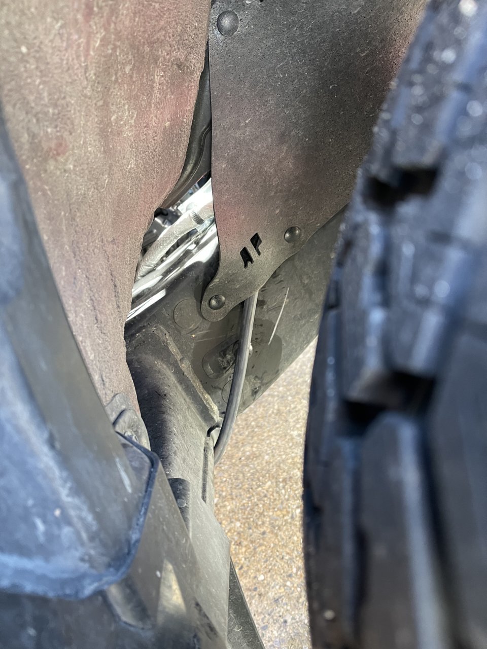

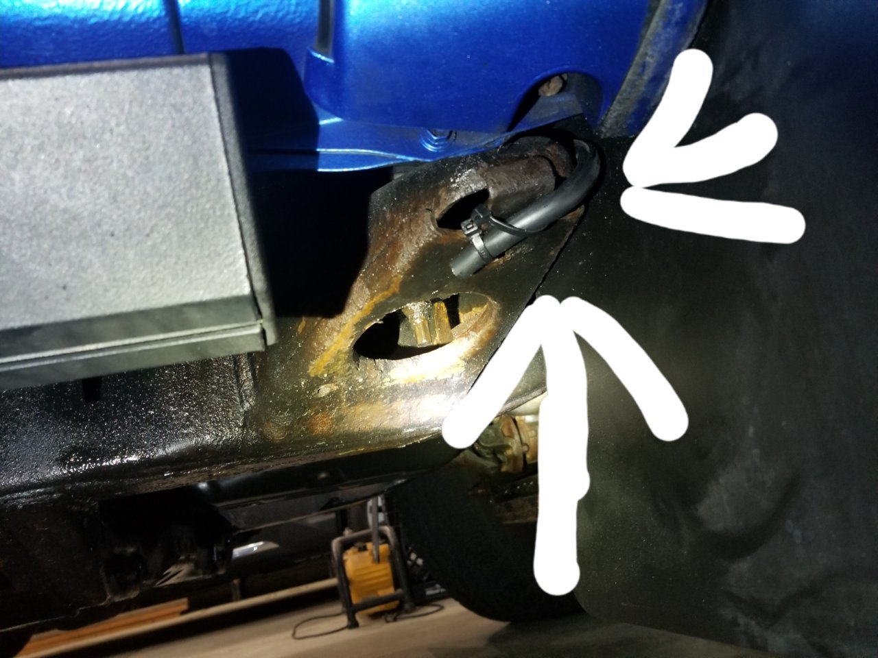

    6. Then I ran it to the end of the arm coming off the frame. I then zip tied the hose around the end of the arm. I ran one zip tie through the 2 big holes on the very end. I ran another one through the little hole in the center of the arm about an inch or so inwards.20211222_191147.jpg

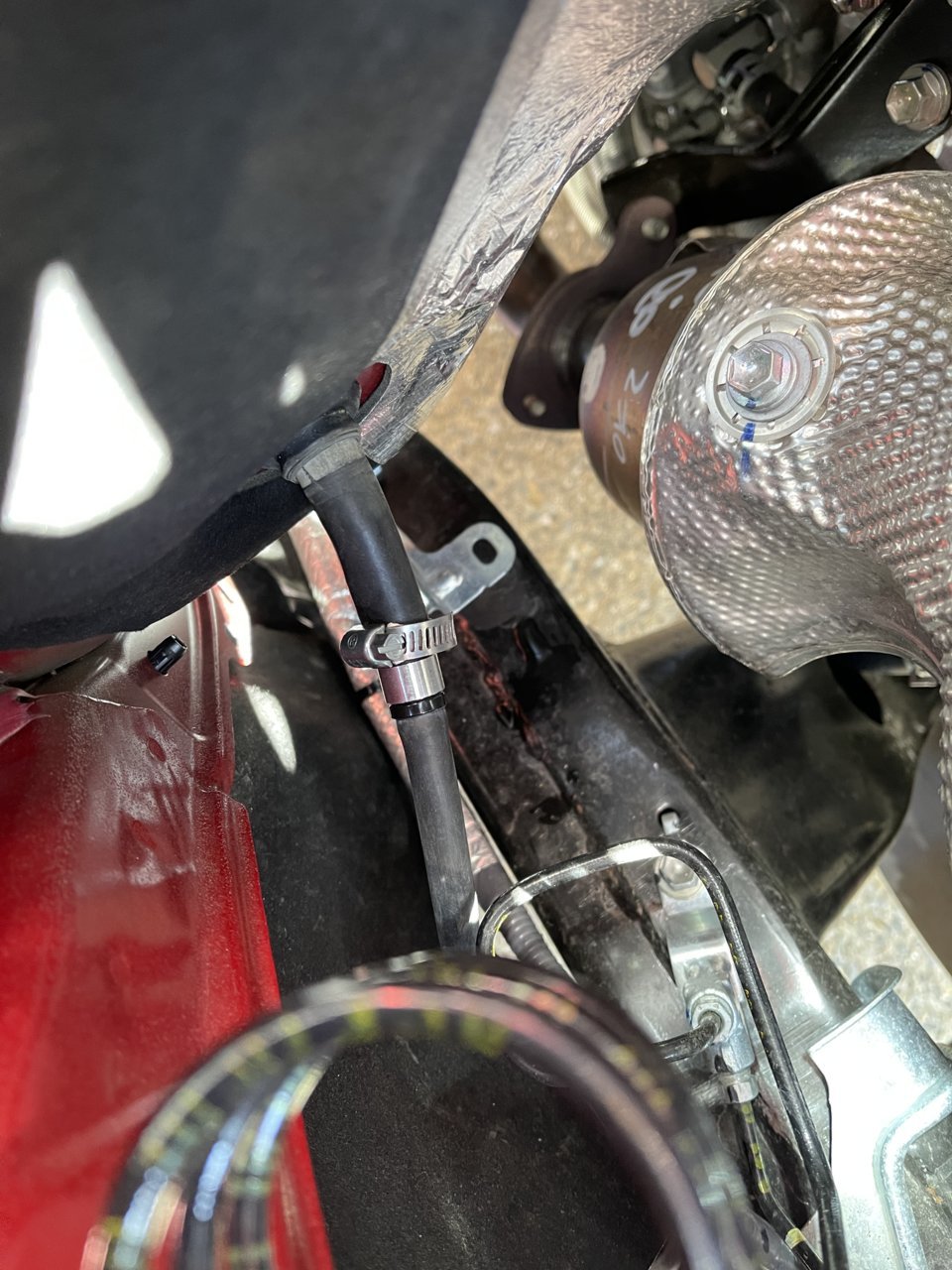

    Got my items quick! Had to get a metal clamp as the fitting kept sliding off even with the zip tie. :thumbsup:
