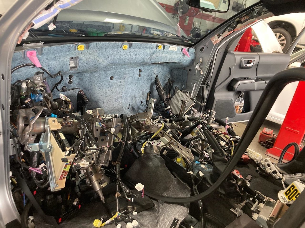

    Oh man. I’m not sure when the “redesign” part happened either but I have a 2021 Tacoma and I just finished having the dealer take a look at my AC and they concluded that it was the evap core needing replacement under this same TSB. I have only 12k miles but my car was making an intermittent whistling noise that got progressively worse when the AC was on. Soon after the AC also wasn’t cooling as well anymore. Glad to hear you got yours back and it was all good cause I’m a bit nervous about them having to take the whole dash off to get to the part.

    I expect the techs to have some sort of trouble putting the whole dash back together. It looks like a big job from the videos.
    My service advisor just contacted me saying they need to hold the vehicle another week since now they are having issues with the vent control system. The truck has already been in the shop for a week. Crossing my fingers they get everything sorted out by the time I get it. Going to test drive it around the area before taking it home since it sounds like something can easily be left disconnected or not put together correctly. Thanks for the update.

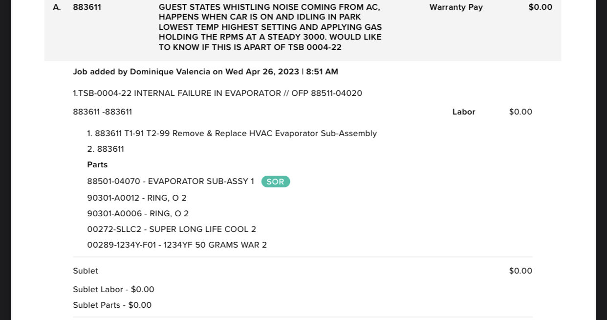

    #423511
    2
    Literally created this account to reply to this thread lmao! I had the exact same description as bazinga, intermittent whistle noise while AC is on! But never had any performance issues it was still quit cold. I mentioned the TSB to dealer, and they took care of it right away. I just got back my truck today, noise is gone, and AC is blowing way colder now! I never noticed that, probably cause its so intermittent. COVERED under warranty.

    #350646
    11
    2020 Tacoma 4x4 off road 6spd
    My 2020 DCSB MT OR has been intermittently “whistling” since i drove it off the lot. Last week it started to be more frequent. A few days ago it got really bad and started making “darth Vader” noises also. Took it right to the dealer along with a printed copy of Toyota TSB 04-22 and they are fixing 100% under warranty!
