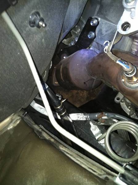

    And I found a way to route it inside the frame then exit at the bottom. It is still a pretty straight shot down so there shouldn't be a problem. I actually just went out and checked it, there was a nice pool of water underneath the new exit. If you don't want to put it inside the frame you will have to route it close to the exhaust OR where you can see the hose in the wheel well.

    I used a tube extender from an old oil funnel. It just happened to be the size that I needed. Then I used two old school hose clamps (spring type) you can seem them in the picture. I had bought them for my Fumoto drain valve but decided it wasn't worth it. Routing it down through the frame worked out much better than I thought it would.
    You should use a standard hose clamp. that would put more even pressure all around the hose rather than just crushing it like a zip tie would.
