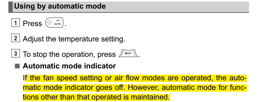

    Try manually adjusting the fan speed to see if it stops. Based on the below, it's possible for the auto mode indicator to be off but some functions to still be controlled automatically. For example if you changed the flow direction the auto light would turn off but the fan speed would still be automatically controlled.
    Or, hit the off button, then manually adjust the fan speed.
    I didn't have mine two days before I quit using the auto system because it randomly adjusted the fan speed. The attached file explains how the system works. In there you'll see the 'neural network' controlling fan speed.
