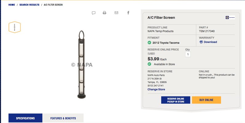

    Can someone tell me where the the Air Conditioner Filter Screen is located?

    No, I can find that under the glove compartment. I'm looking for this.

    I see, what does that do, and is it a routine maintenance item? Are you having A/C problems.

    It's just a part the dealership wanted to charge me for replacement during routine inspection. I figured I could do it myself while I check the other filters. I'm sure its nothing critical. My A/C seems pretty good, so prob. a waste of time, but I thought for $3 it may be worth replacing.

    HA ! No, that's a cheap easy up sell item that most won't question because it is cheap. But to actually change out ( and I doubt they ever do ) you have the discharge the AC system as it is in on of the lines at the evaporator expansion valve

    Right, I had a feeling it was part of the line system. I won't worry about it. Thanks for confirming.

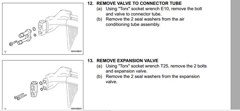

    Replace it. It is cheap and the chance of getting it clean after a compressor failure is slim and none. Also make sure all the lines are flushed clean and the condenser dryer are replaced.
    Here are some more pictures for you. Don't forget the filter in the tube.

    If my filter looks like the one above is it likely that my compressor is shot?

    yes it does I just pulled the evaporator core out because i had dye coming out below the dash. turns out the leak was at the expansion valve
