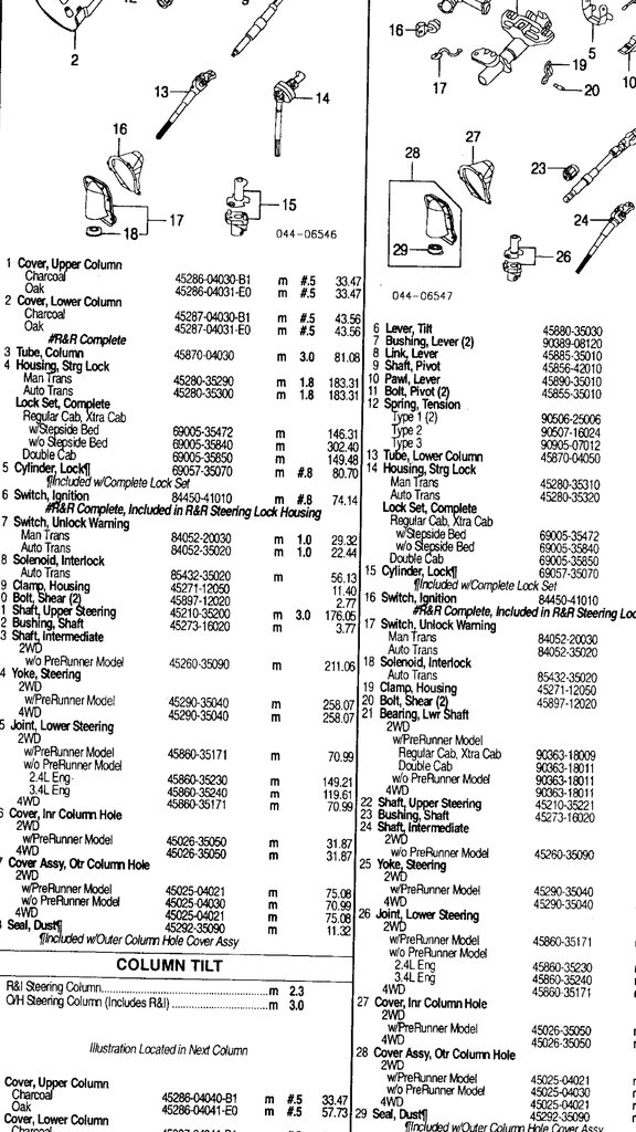

    Another thing to check, is the boot for the steering column shaft that goes through the firewall. Mine was gone. You can crawl under the truck, with a flashlight, and look directly up where the shaft goes in and see if there's a large gap. Can't remember exactly what it's called. Think its a seal. It's like a hockey puck type deal that is rigid, and is kinda pressed in. If that's gone then you would get a ton of air coming in.. I still get outside air smells but think that's due to a few small holes in firewall that aren't completely sealed.

    I honestly can't remember. The steering column doesn't need to be removed. But the mid shaft that goes through that does iirc. It's called a dust seal.
    Number 18 fixed column or 29 for tilt.

    Wait my bad, that's for first gens^^^
    Not the t100... didn't catch that at first.
