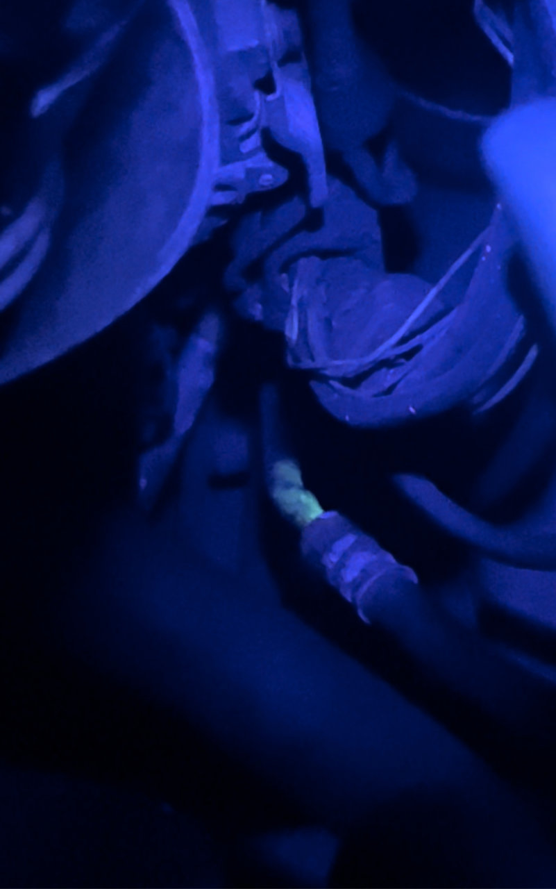

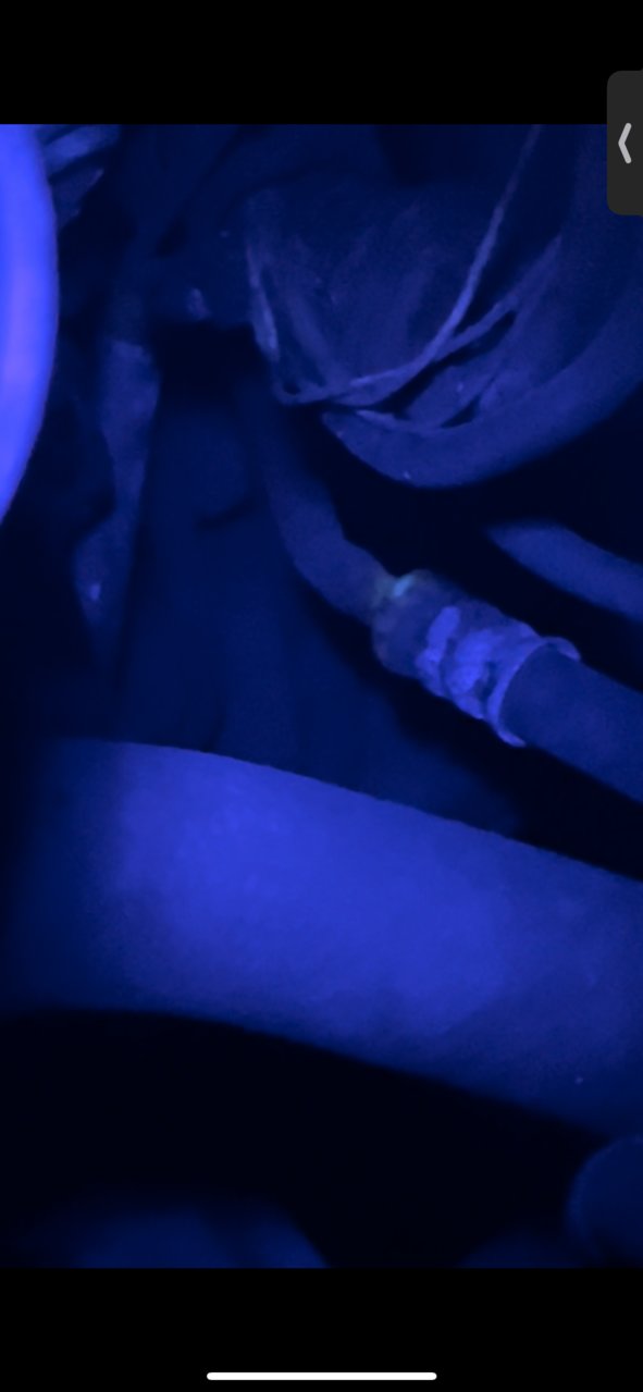

    Is that the hose you can see from the driver side of the engine bay. If so, mine leaks in the same spot

    Yes it is and I cleaned around it and ran a shot of dye into the system Again this time without spraying it everywhere. And sure enough

    Can anyone identify that hose I have that’s Leaking; maybe even the part number ? I’m not sure if it’s one hose or two jointed together. Looks like it’s connecting from the compressor

    Here is another (and more clear to see) shot of the leak
