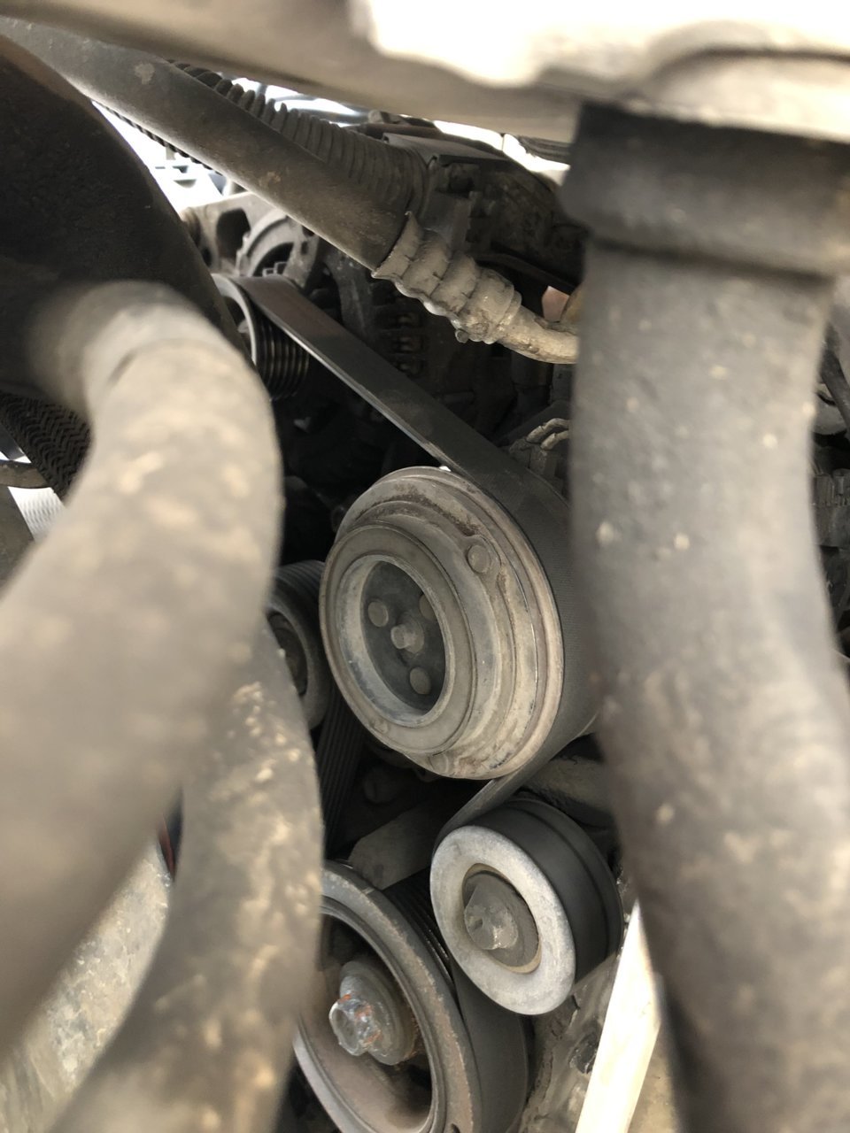

    First post here. This forum has been so good for so long I’ve never had the need to actually ask for MORE info, but alas...
    My A/C light is blinking intermittently as well. Been going on a couple months. Turning it off/on/off/on, it will eventually work for a day or two before it happens again. Of course, when I took it to the shop it worked fine. They checked everything, pressures looked good and they couldn’t figure it out. He guessed what it was and replaced the sensor in the dash that controls the expansion valve (I forget the name), but that didn’t solve the problem. He put back the original sensor and refunded me. I replaced the mag clt relay; no luck. I replaced the AC amplifier; no luck. I just tested the compressor pickup sensor per instructions in this thread; 2.7V and voltage increases/drops near a magnet as designed - i.e. no luck. There are no strange sounds coming from the compressor when it’s engaged.
    At this point, the only things left are the in-line pressure sensor (the shop said it’s OK) and the clutch and/or compressor. How do I go about identifying if I just need a clutch or should I just replace the whole thing? Would really like to avoid opening the system if it’s just the clutch.

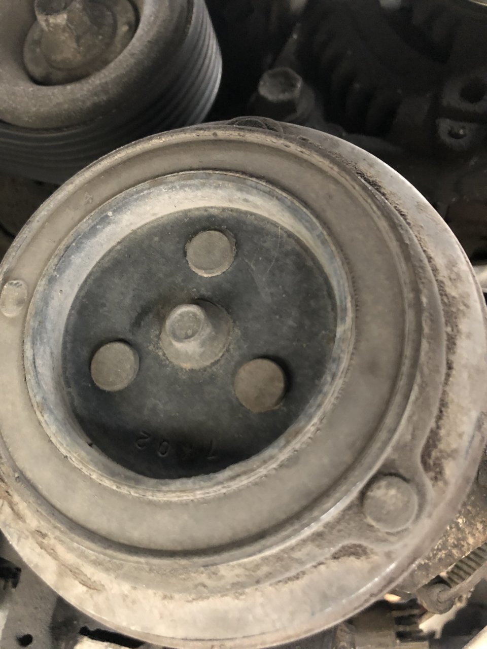

    Well, the AC was working again today, which signifies to me the relay is still good. Because the engine was hot and the plug is hard to get to, I jumped the in-line pressure switch with the engine on and the clutch engages on command. That suggests both the sensor and the clutch are good. There is no play in the clutch/pulley and I can turn the clutch/compressor by hand with resistance I would expect from the oil in the system. Also, I don’t see any sign of the ‘black goo’ others on the forum have seen to indicate a bad clutch.
    Amplifier ✔️
    Thermistor ✔️
    Clutch relay ✔️
    In-line pressure switch ✔️
    Compressor Pickup sensor ✔️
    Clutch ✔️?
    Compressor ✔️?
    Still lost. 2D2080D9-3A81-4D6E-889F-B9E400C962E6.jpg353ACB92-2ABD-48E9-943F-564E463806DB.jpg

    you put a multimeter on the speed sensor? The sensor is a pain to remove/reinstall.
  14. Jul 31, 2019 at 3:33 PM
    #54
    Marsevar
    Marsevar Member
    Jul 30, 2019
    #300766
    12
    08 TRD Off Rd
    Yes sir, I did it last night. Measured 2.7V and went up/down with a magnet. I removed the skid and went from below with a small 1/4” socket and an 8mm socket. It wasn’t that bad that way. Only thing I noticed was the little bolt didn’t really ‘break’ free. Maybe it was loose? Idk.
