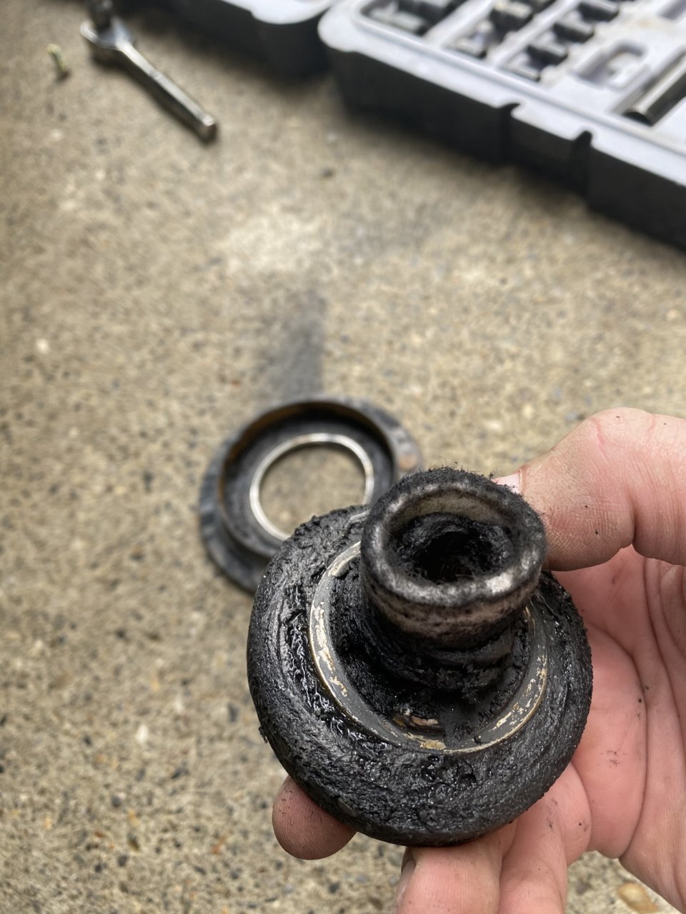

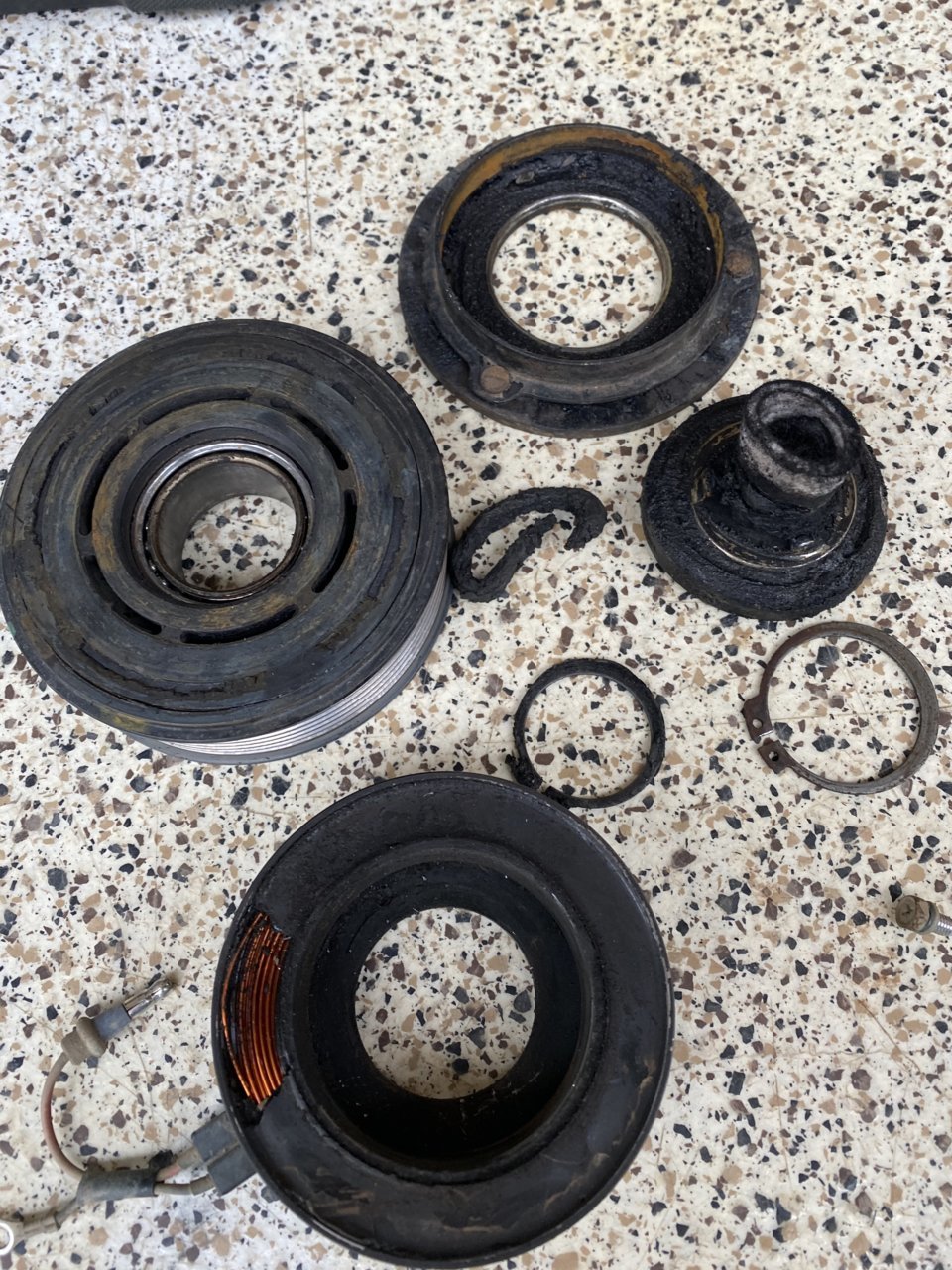

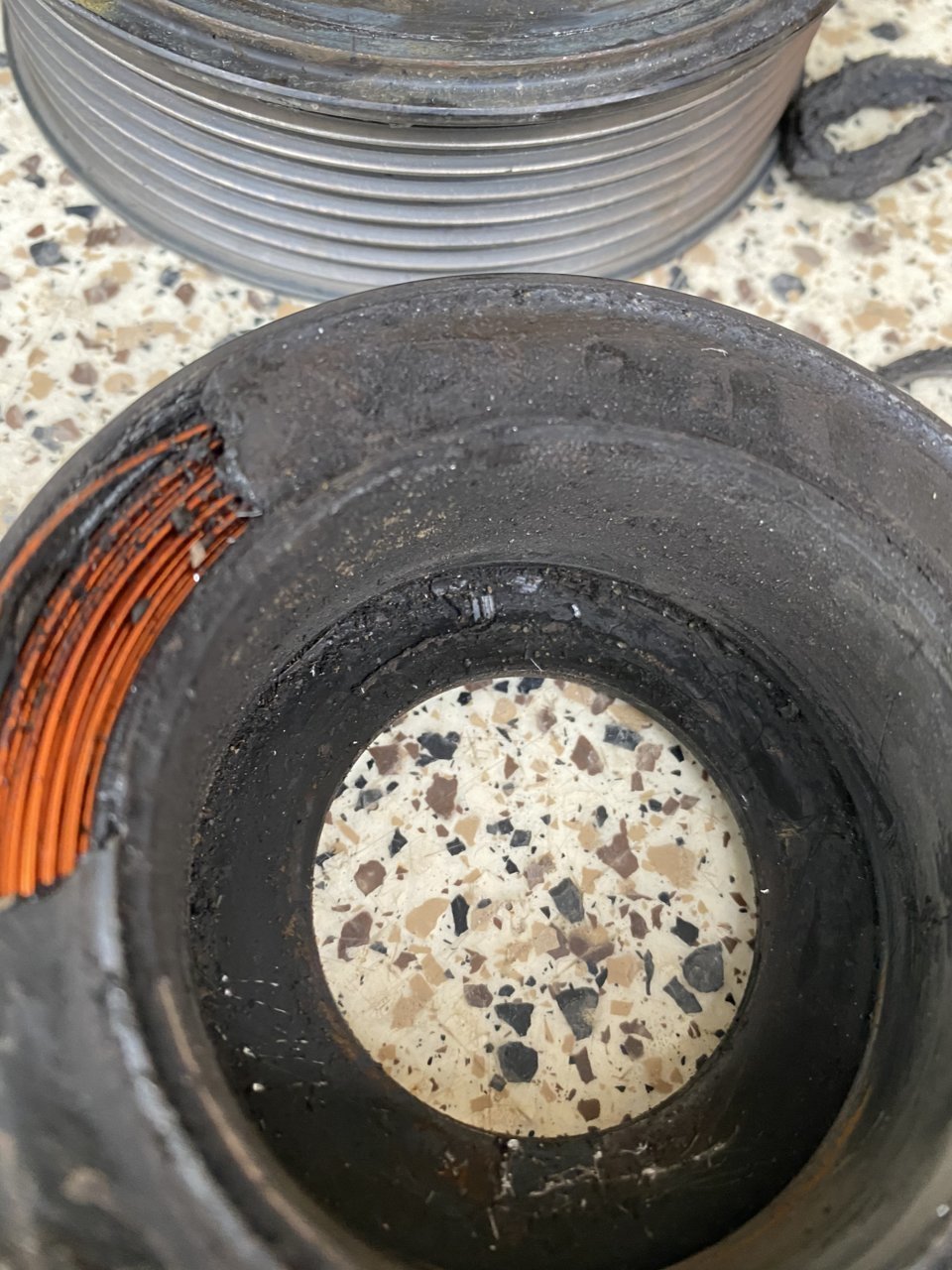

  18. May 25, 2020 at 6:14 PM
    #78
    Jazz1one
    Jazz1one It is what it is
    Oct 4, 2015
    #165812
    380
    Calgary AB
    2015 MGM DCLB sport premium
    SCS ray 10s. 315/75/16 Yokohama G003. Elka 2.5 dc w/remote resi. SPC uppers. Dobinson heavy leafs. Timbren bumps. Spindle gussets. Cab mount relocate. TRD catback. Toyota trifold tonneau. Full spare in bed. Hood deflector, side visors. Danger Customs Front/rear high clearance bumpers and full skids. 2 way remote start. Safari snorkel. Front 30% tint. Bed step. Anzo LED head lights. Weather tech mats. AllPro HD sliders linexed. 10k smitty x20 synthetic. Factor55 flatlink. Linexed bushwhackers. Rigid industries bumper pods. Ridged industries DSS ditch lights. Diode Dynamics amber pods. Prinsu roof rack. 42” Caliraised Amber single row. Switch Pros in sunglass holder. Custom Bed rail mounts for recovery gear.Northstar AGM battery. 4.88 nitro gears. Front and rear ARB lockers. ARB air compressor in bed cubby using expedition essentials mount.
    I think I found the problem...D335E7AB-13BA-46A2-A966-48187FC548F2.jpg7032A9C5-9CC7-4D74-A480-902E7E1E1AEA.jpg
    Clutch is cooked. Ordered a new one from Toyota. Hopefully the compressor is still good. Will install and report back in a couple of days.
    Torspd, kasnerd and CurtB[QUOTED] like this.

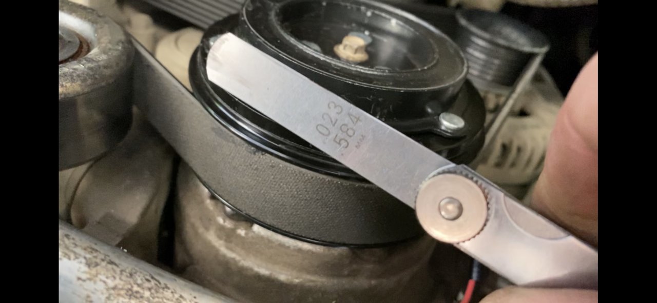

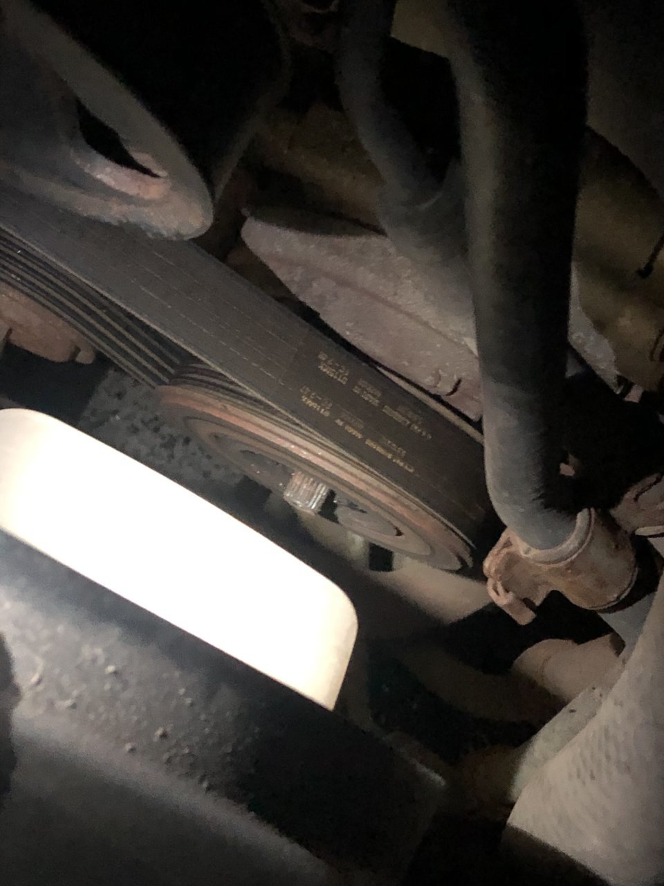

  19. May 26, 2020 at 8:43 PM
    #79
    Jazz1one
    Oct 4, 2015
    #165812
    380
    Calgary AB
    Got the new parts in from Toyota.
    I was able to access from underneath, I didn’t remove the whole compressor, just the clutch assembly. Kept the driver wheel in place. Just took off the skids and it’s all straight forward from there. The big snap ring gave me a hard time to get back in, everything else was a breeze.
    I Installed with the same spacers that came off the original. I have a gap of 0.584mm. I couldn’t test the gap on the original because it was toast.
    I ran it and everything is operating fine but my ocd is asking if any of you can get under there with a gap tool and confirm your specs please....
    Torspd and kasnerd like this.
  20. May 26, 2020 at 10:07 PM
    #80
    kasnerd
    kasnerd candied bacon
    Jan 2, 2014
    #119695
    2,498
    SoCal Yokel
    '14 SC LT Mall Runner
    Mods? Yes, oh yes..
    as long as it's within the spec, yer good. Your experience is pretty much mine except I swapped thinking it was the problem and left new one on as that snap ring was a pain and didn't want to do that again. My arms were sore for a few days trying for the love of yota.... I don't have the range for the gap off hand, but a quick Google should tell you.
